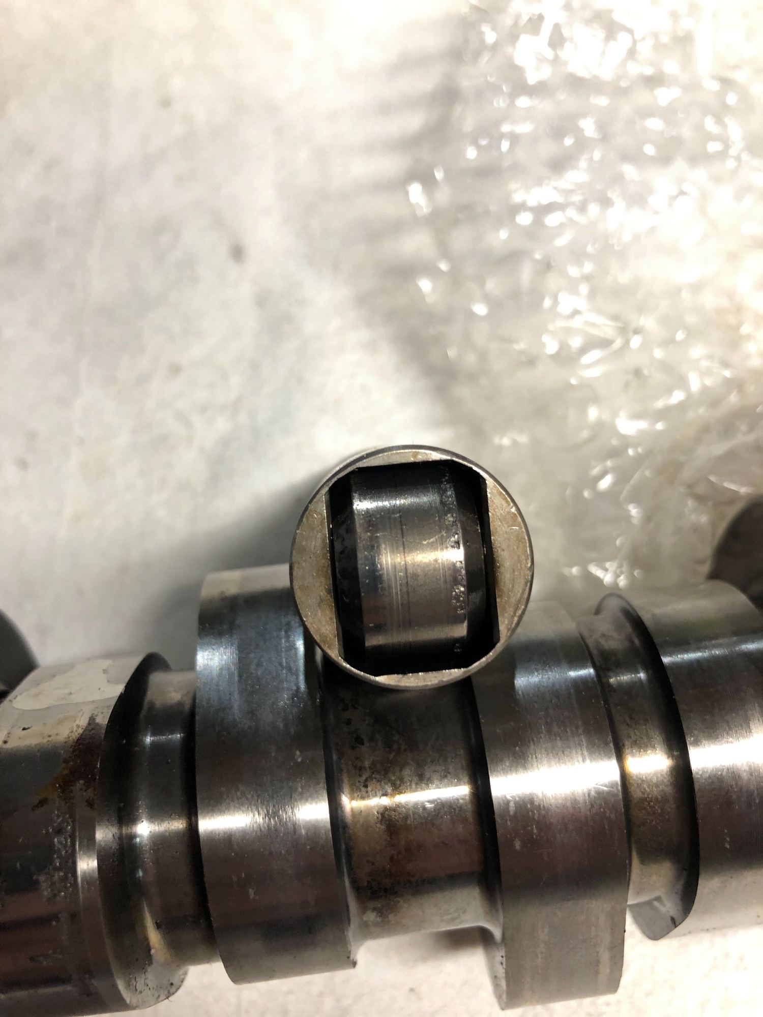

Here is a picture:

I'd look at spring seat/open pressure, pushrod length, and lastly where coil binding occurs in relation to your cam lift. That lifter doesn't appear to have turned. It looks more like the lifters aren't overcoming spring pressure so I'd look at coil bind and pushrod length first. What exact springs were used? What pushrods were used? 7.8? 7.825? What model spring so I can look up the coil bind and pressures. What was the cam lift for the lifter that failed? The LS7 uses 1.8 rockers so it increases lift as seen by the lifter. Do you have the cam card?
Edit: LS7 rods are longer 7.8 ect

Scootguy, your picture shows a classic example of the result of a roller lifter that can turn back and forth when running. When the lifter turns one way, the edge of the roller contacts the cam surface and skids a little instead of rolling true because it is now out of alignment. Then when the lifter turns the other way, the same thing happens at the other edge of the roller. This causes the edges of the roller to chip, and skid marks appear on the surface of the cam, just as in your picture. It is unmistakable. In order to fix your engine, you need to find out what allowed the lifter to turn, and fix it. The original GM lifter trays hold the lifter in alignment, but can wear out at some point and allow the lifter to turn. Some aftermarket lifter trays are poorly designed and built such that they allow the lifter to turn even when new. I could be wrong, but here is my best judgement as to what happened in your case:
Your lifters and cam failed at 84,000 miles because the original GM lifter tray was worn out and allowed one or more of the lifters to turn, which caused the type of damage shown in your photo. During repair, your guy either installed the original, worn GM lifter trays, or installed new aftermarket lifter trays of poor quality from Autozone or O'Reily, etc. The only known good lifter trays to use are the GM parts sold by the GM parts department. So then, after a new cam and lifters were installed along with defective lifter trays, the same failure occurred again in short order. I hope you get it working as it should be. Here is a video about this problem that I think you will find interesting:

That surely could be it, I will be visiting with my guy later today and will report back on whether he changed the trays and if so ,GM or knockoff. Thanks for the lesson.
