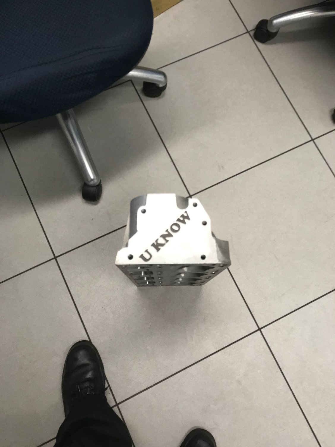

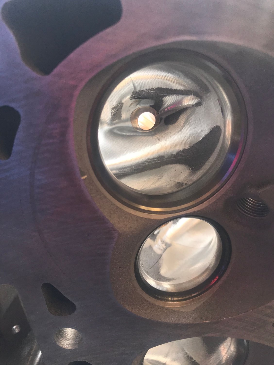

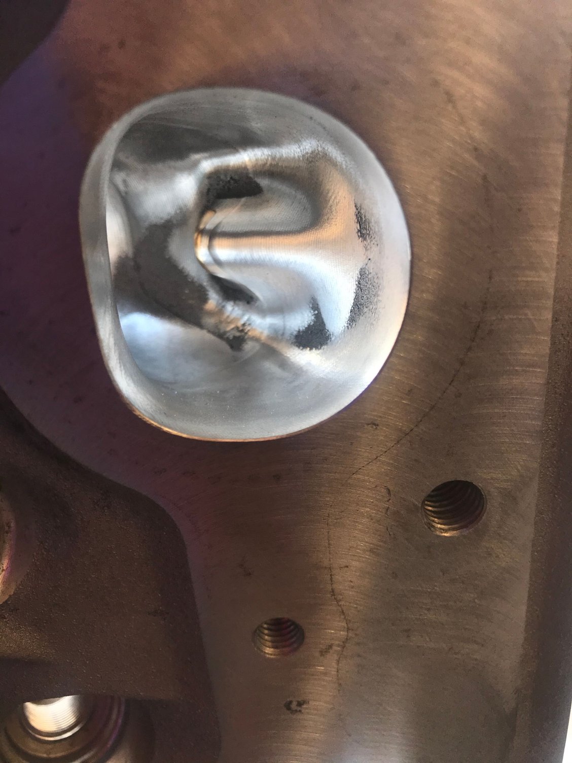

Has for with heads, I started off with TSP. I had a local reputable machine shop replace guides and valve seats. When I call TSP to have them do the CNC port. Salesman was cocky and said they didn’t want any thing with the CNC. Said it could break his 300k machine. Kinda frustrated with them I hung the phone and called Kaltech. Glad I did it was cheaper including etched “U Know” in the heads, same as license plate. Even though probably won’t see it. LOL
