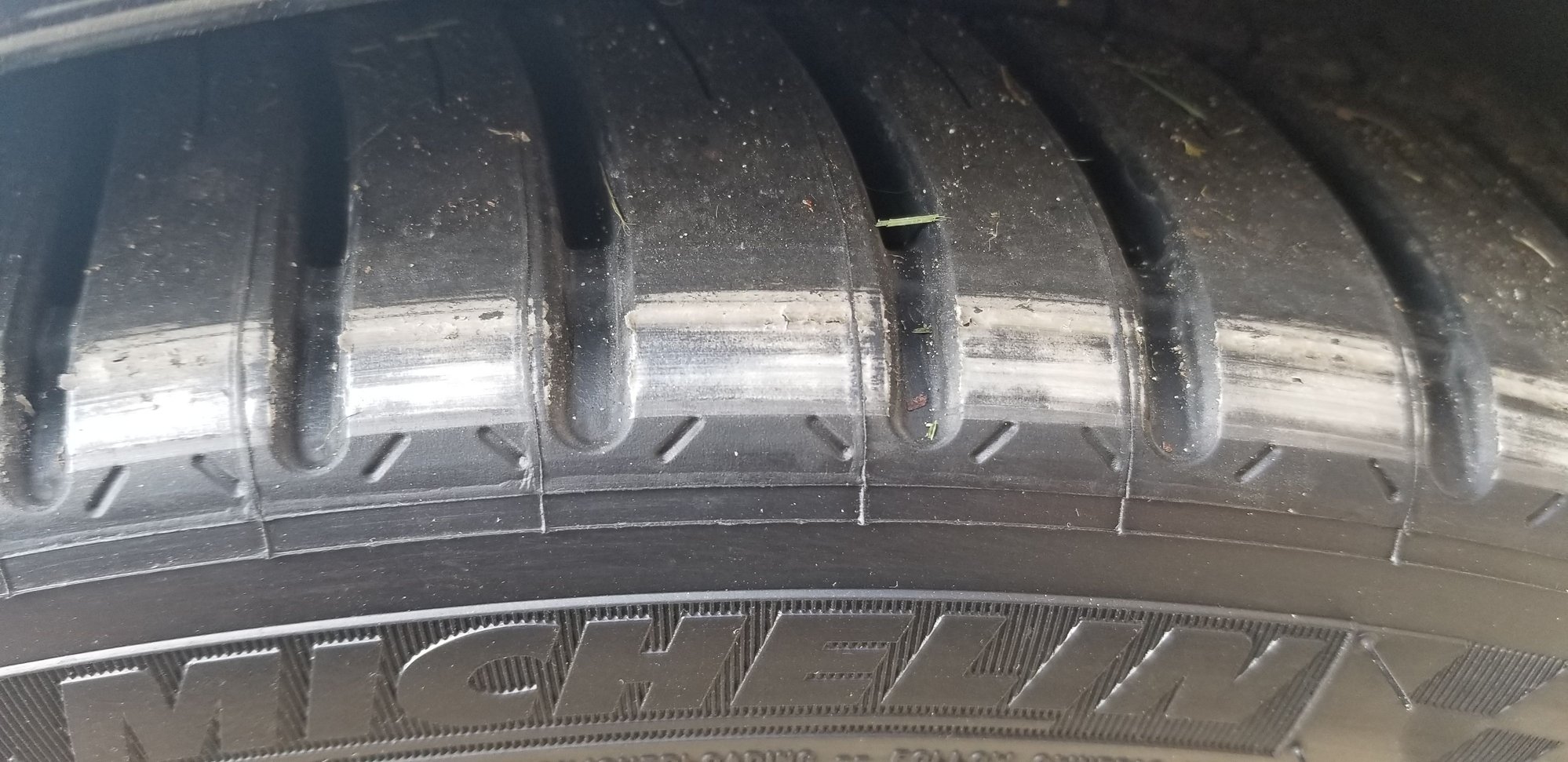

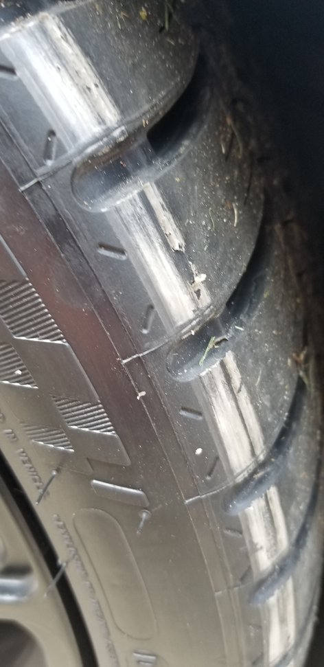

2012 Grand Sport wide body Centennial Edition.
Put on new tires and wheels that were supposed to fit but I am getting some front tire rub. VARRO Wheels
WHEEL SIZE: 19” FRONT AND 20” REAR
WHEEL WIDTH: 10 FRONT AND 12.0 REAR
WHEEL OFFSETS: 30 FRONT AND 50 REAR
285/30ZR-19 MICHELIN PILOT SPORT A/S 3+ ZP
335/25ZR-20 MICHELIN PILOT SPORT A/S 3+ ZP

Those 2 photos ... are they of the front or rear tires ?

I should have included it's only the fronts rubbing both sides just that small area.
Rears are fine. Thanks.

The front ride height are either too low or your shocks needs replacing. Tires/wheels sizes and offsets seems to be acceptable.

Well, with an offset of +30mm on your new front wheels, they will poke out 16.4mm more than your stock GS wheels (that's why they are rubbing on the outside of the front tires)
Had you purchased these same new wheels with an offset of +40mm, they would only poke out 6.6mm more than the stock GS front wheels.
Below is the numbers concerning the new front wheels you have on it now ...

Of course, if you raise the front ride height up a little, you may not rub on the tires.

Do these tires stick outside of fender. The combination of putting the rim 5/8+ (17 mm poke difference) inch out (with not really going in) and the wider tire is probably to much for the car. I think most guys with 10s in the front have the offset more towards stock which I think is around 40 mm they just add 1/4 inch on each side while staying close to the 40 mm offset. The rear the offset is like 54 mm so your 50 mm is pretty close so those as you said fit fine and are also the stock size of 12 wide.

Factory stock Cup and ZR1 wheels are 19x10 and have a +40mm offset. With 285/30 -19 tires there is no rubbing on Z06s, ZR1s, 427 convertibles, or GSs. Looks like the problem is the +30 offset on your front wheels.
