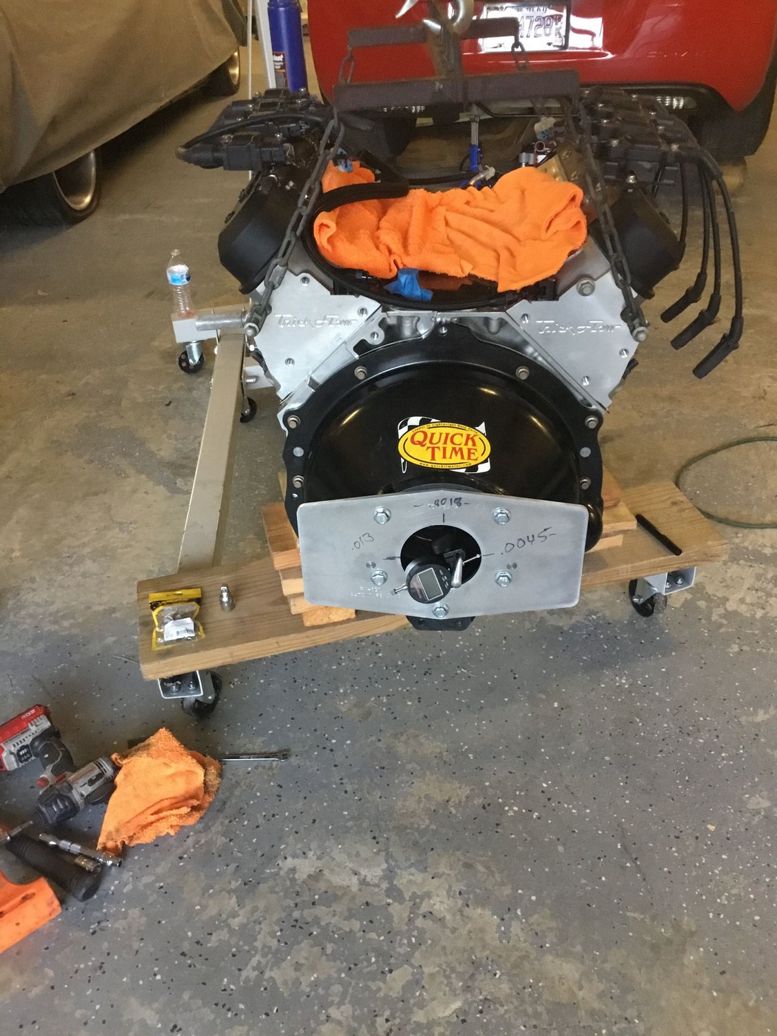

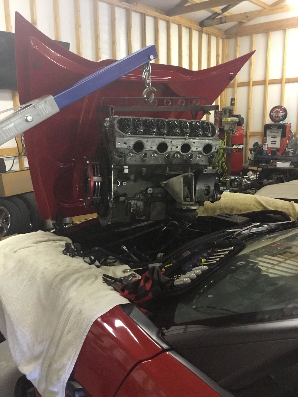

Just want to give u a thumb up on how to pull a engine in 45 easy step . I was scheduled this week to have the engine pulled. I decided to pull it myself thanks for the info. After two days it’s out. (I pull it by myself no help just me@68 )
here is my new hammer . If I can get my scatter shield index tomorrow hope to have back in by tomorrow night

Why did you not remove the hood before taking out engine?

not trying to be a smart a?? the less you remove the less you have to put back on I’m lazy. anyway I pull the engine by myself .I had No help but if I would have had help I would have pulled it. a bad day offset dowel in coming . I did call a friend today to turn the motor so to check the runout on scatter shield

Your transmission will thank you for checking the runout.

I was thinking more about my pocketbook
Ok but it just seems like a lot of extra work having that hood in the way. If it were me I would have tied it to the cherry picker and unbolted it. But you got it out that's all that matters. Good luck w/ the install!

I saw a video where a guy easily removed his hood by himself. Here's how he did it:
1. The hood is attached by two bolts on each side of the hood.
2. Loosen the upper bolts.
3. Remove the lower bolts. When the last lower bolt is removed, lower the hood on to the top of the engine by pivoting it on the upper bolts that you loosened in step 2.
4. Stand at the front of the car, remove the remaining two upper bolts, and lift the hood away from the car with one hand on each side of the hood. Easy peasy.
