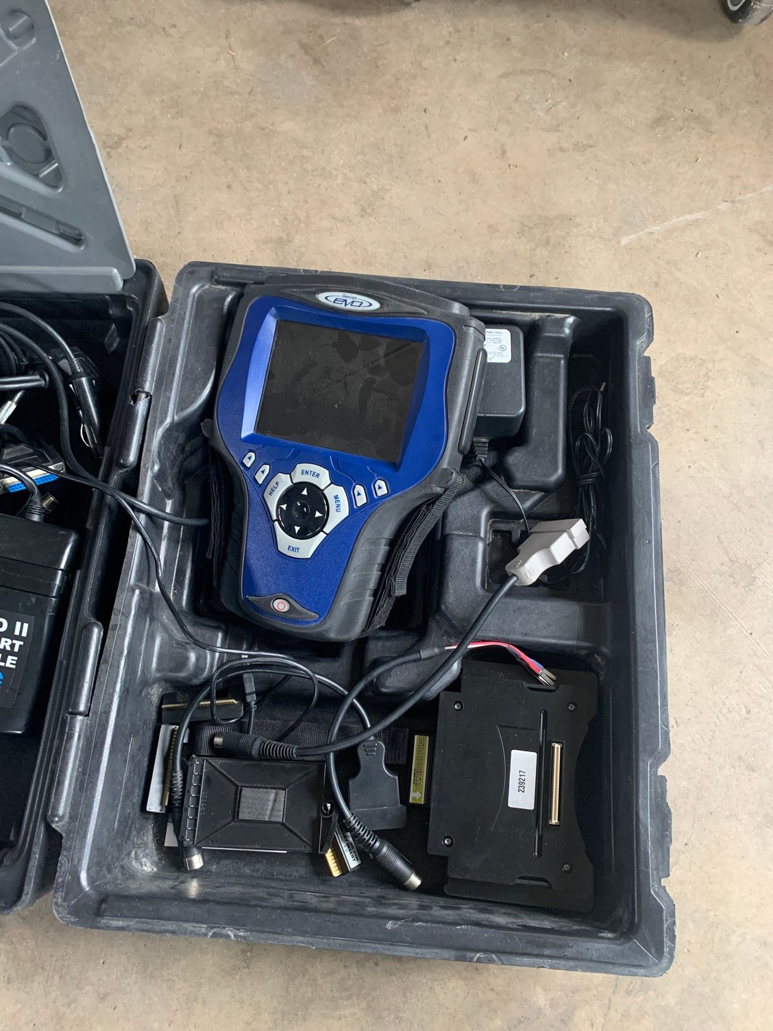

yeah that’s exactly what i don’t want to be doing is giving the dealer a bunch of money and time that is unnecessary, and i’ve got a genisys evo scanner
but not sure if it can do the job
