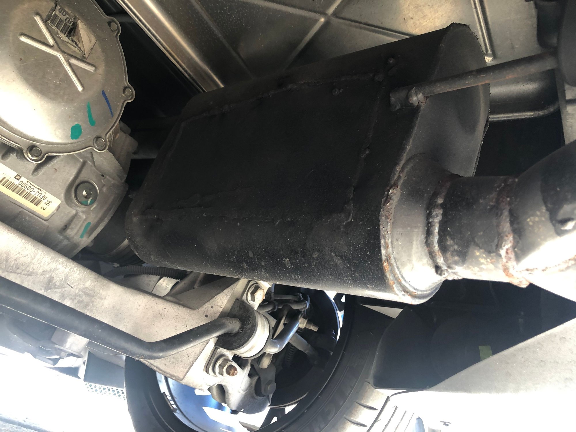

I see no markings on them anywhere

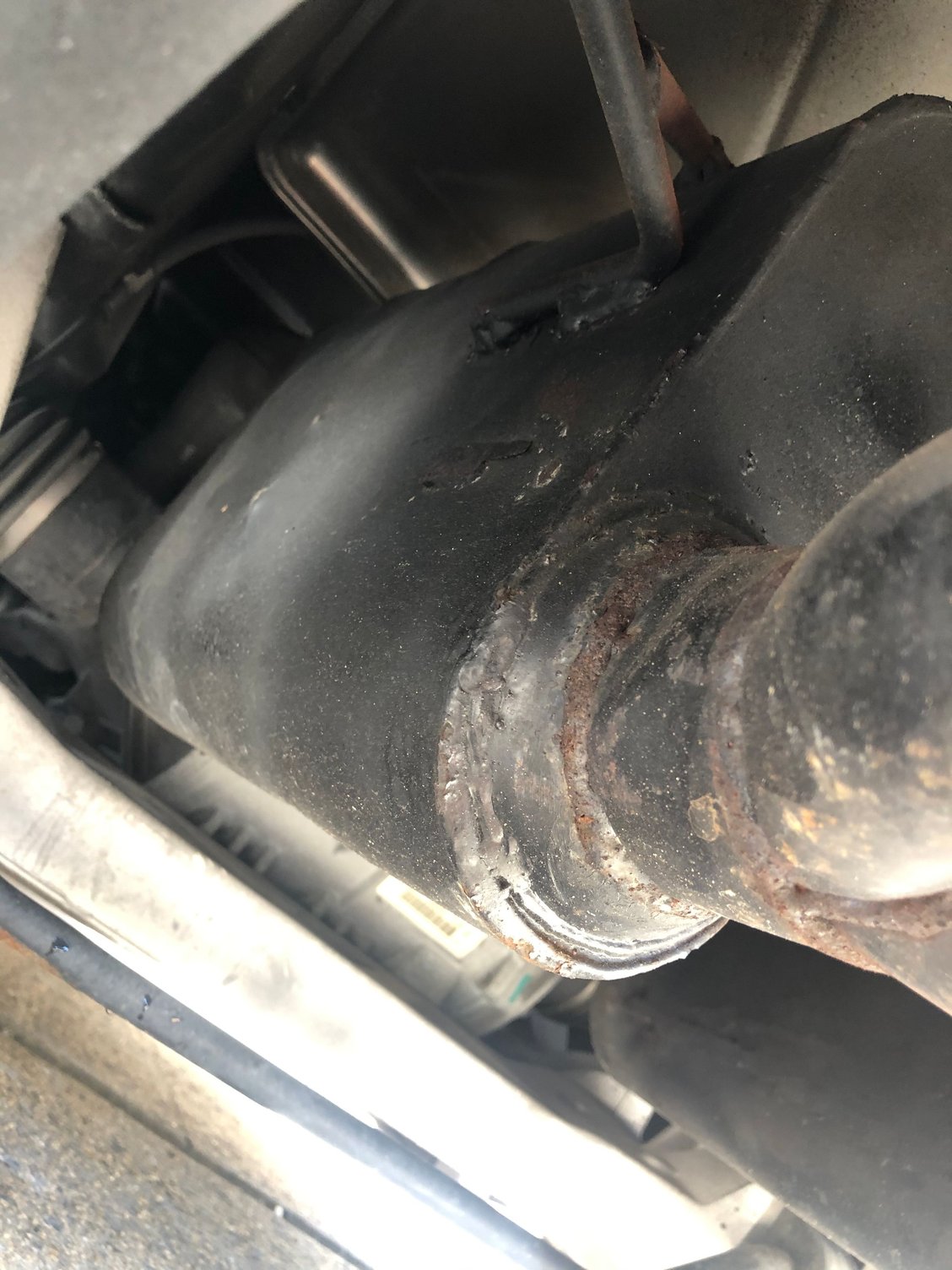

Oh boy, someone hacked off your old mufflers and welded on some different ones on. And it clearly wasn't done by a quality shop, based on those mediocre welds.

Are you implying that I shouldn’t of bought the car over some muffler welds? The car is immaculate. I really don’t care if the welds aren’t the best.

Not only are they not OEM but there is a panel that was cut out of the side and welded back in, I bet they are loud. They look like some old flowmasters.
Yeah, they may have ripped the packing out or welded up the perforations to make them louder.

FWIW - There is a popular modification to the base mufflers where you cut them open, modify the guts and weld them back together. You can Google it if you want more info. It appears these mufflers have a similar modification.
