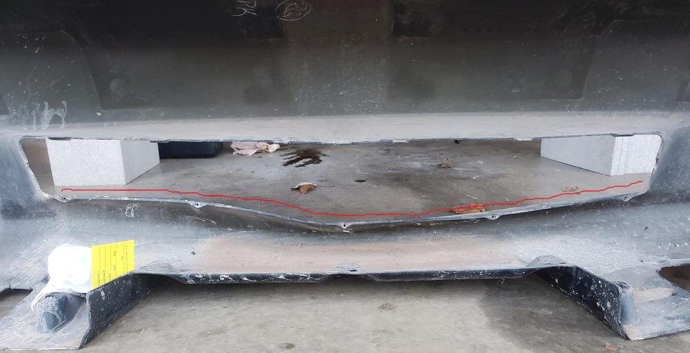

looking at other repairs to take care of on the car, I'm looking at the front facia, but this would probably apply to the whole car as I've found a few other cracks. I was PLANNING on just replacing the whole thing, and I'm guessing that's probably what I'm going to get from this discussion, but as I mentioned there's other parts that I could try to fix.
inside view of front facia

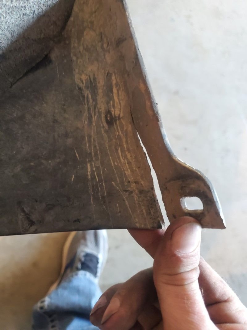

for the facia, this is why I doubt it can be fixed, there's a couple areas where due to other damaged parts not resting where they should, it's just warped over time. If anybody does know a way to fix it let me know, but this part I THINK can be fixed:
fender crack
it would be a first time trying for me but I'll take a shot, short version I'm getting is that there's some type of epoxy to fill it in with then sand/paint. I know that sounds like basic body repair but I'm just noting that it's not generic bondo, shop manual says there should be a stamp to identify the type of plastic but I couldn't find one, so I'm trying to figure out what type of epoxy. part of it isn't painted and you can see it's yellow underneath, but there's no fibers visible like fiberglass.
any suggestions on brand/type of epoxy/resin/whatever to patch this with or tips on how to do a good job?
I'm also noting the paint job doesn't appear to have any sort of a clearcoat, I have a couple scratches and when I look really close I don't see any layers aside from paint and whatever it's attached to.

either plastic weld or use panel bond on the fender. someone skilled with a heat gun could probably fix the facia
