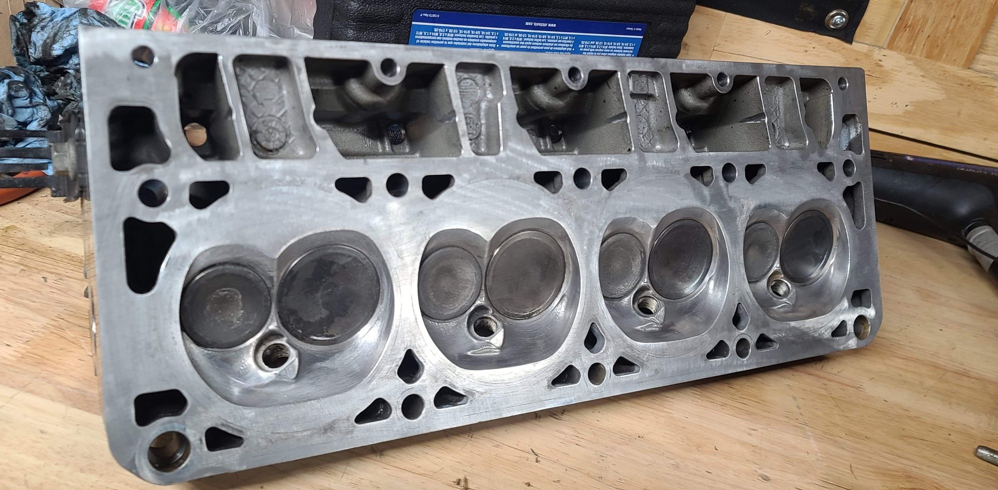

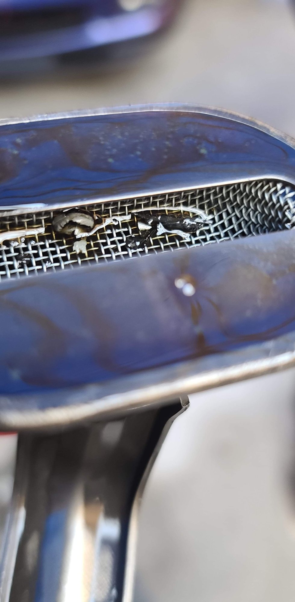

heres the update so far... took apart passenger side head and found this.. the other lifters were still smooth as butter.
Pull lifter trays, and see how much rotation slop of the lifter in them you have. If any lifters are not fitting tight to trays with no rotation to them in the tray slots, then replace all the trays.
Hence older lifter pair designs used to have the cross rod to keep them from rotating, while the lifter tray is what is keeping them from rotating now isntead.
So worn lifter trays, and the lifters rollers can rotate against the cam lobs to cause the problem.
To add, with the lifter roller trashed, the matching cam lobs is trashed as well (read new cam as well).

Yes sir, last night i took advantage of Texas speed Cyber Monday sales. Current parts coming in:
-Texas speed Magic stick Stage 4 Cam
-Morel 6504 Lifters W/ New trays (I’ve seen better reviews with morel Lifters rather than Ls7’s)
-Timing cover W/Gaskets
​​​​​​-OEM GM 6.0 Head Gaskets
waiting for these parts to come through so i can get started on the job. Car will be revived with an extra bump in power. Cant wait to show the end result.

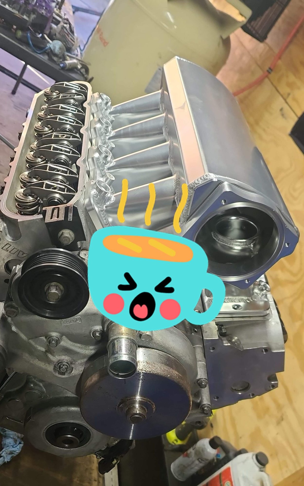

Good morning gents. I just wanted to give yall an update on what i did as a resolution. I basically tore apart the entire motor cleaned it up very nicely fixed many small things and replaced bearings for longevity. Car turned 85K miles. Went with new cam, springs rockers, lifters etc..
