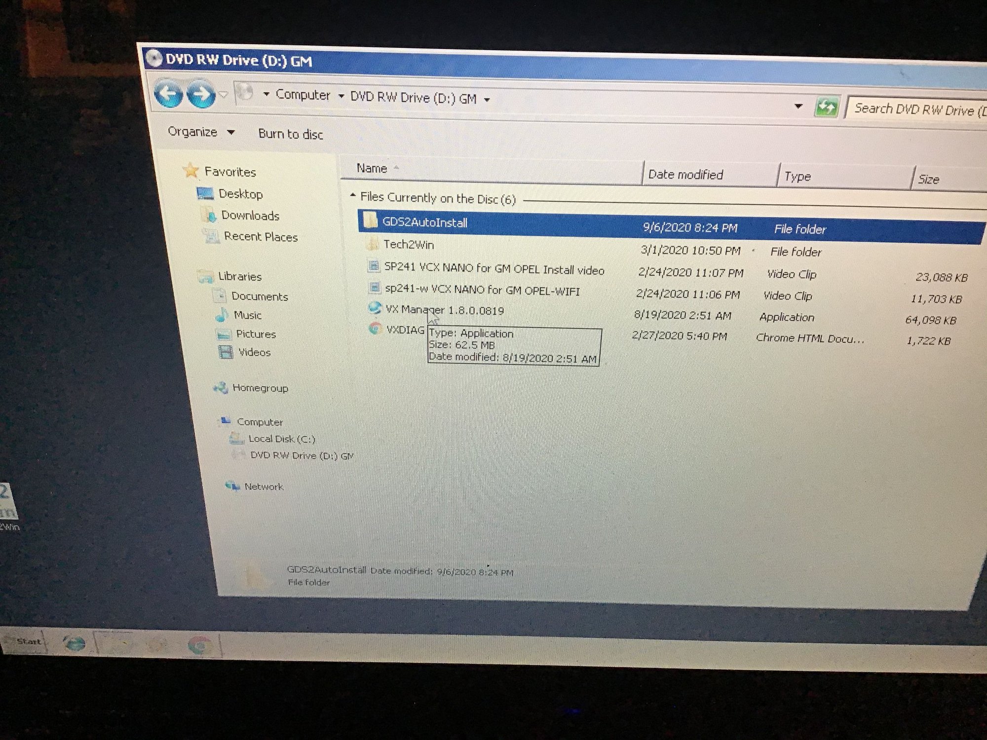

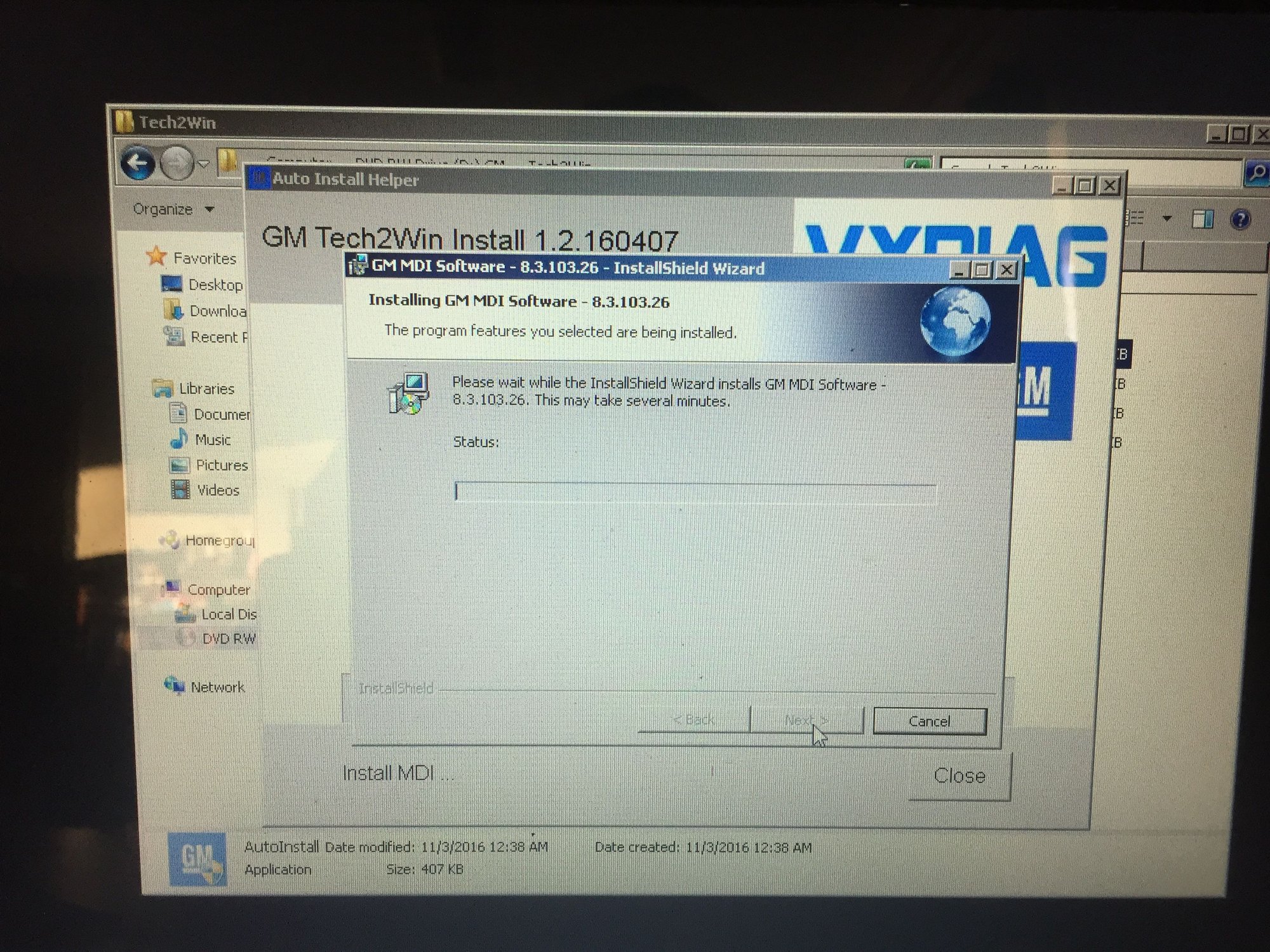

Ok, Nano installation update:
Easy as pie. The CD came with auto install files for both Tech2 (Takes 5 minutes) and GDS2 (takes 20 minutes). Total install was about 45 minutes.
The CD’s contents.
The auto install for Tech2Win running.
After running the 2 auto installs, run the VX Manager driver, and it’s done.
