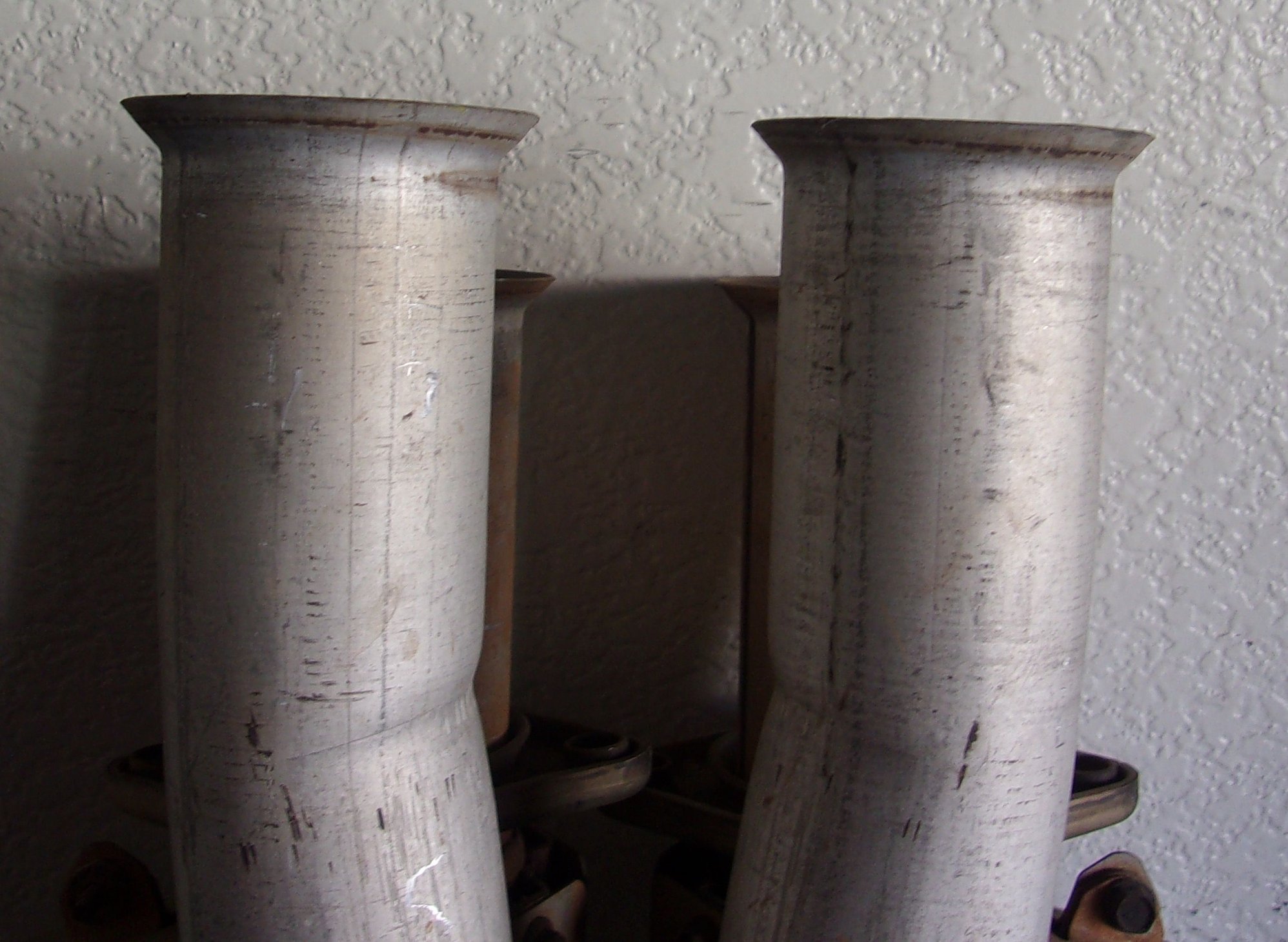

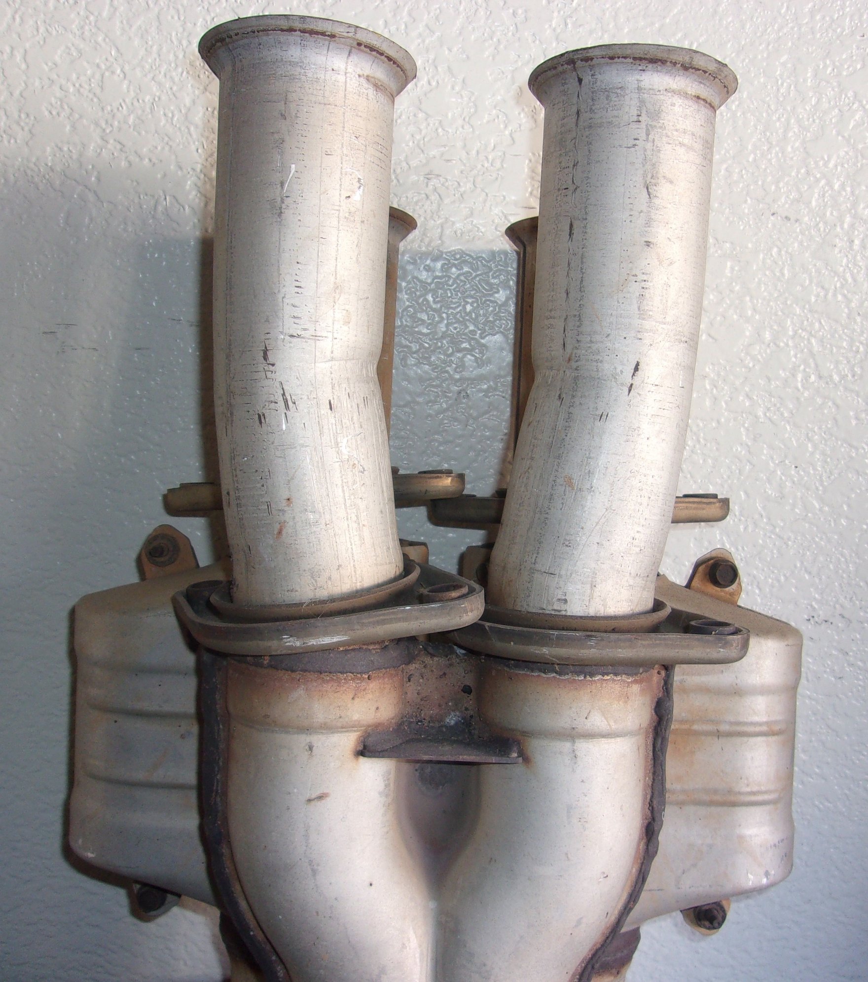

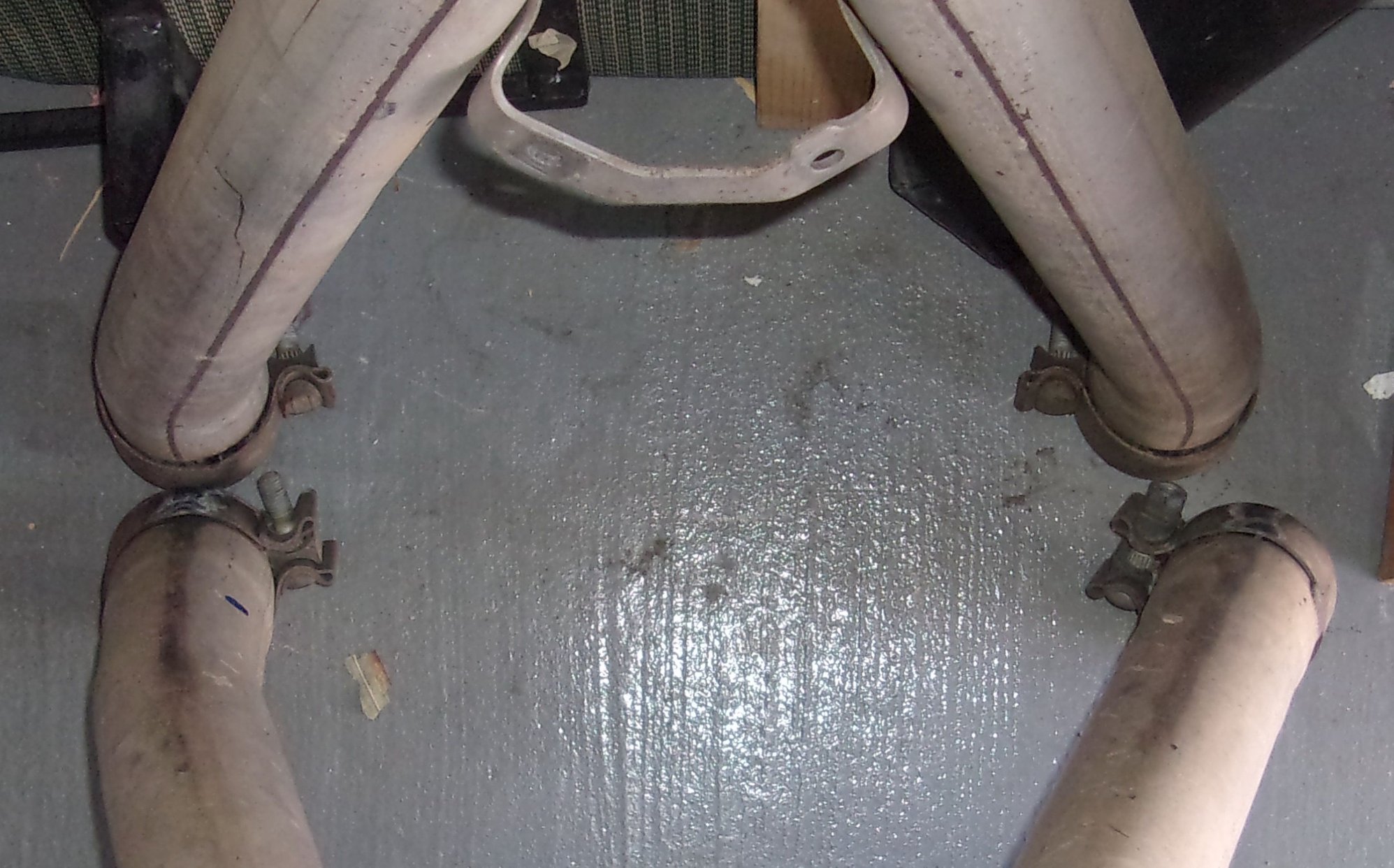

Just for clarification, here are some pics of the differences between a pre-'10 x-pipe, and a '10-later x-pipe. The pipe in front is the older. It is about 2" longer overall, and 1 1/2" wider at the exit. You can easily tell which you are working with as the '10 and later x-pipe has two non-op cats. If your x-pipe has two cats, it is '10 or later. If not, it is '09 and earlier.
The gov. mandated the extra non-op cats. They have no sensors.
