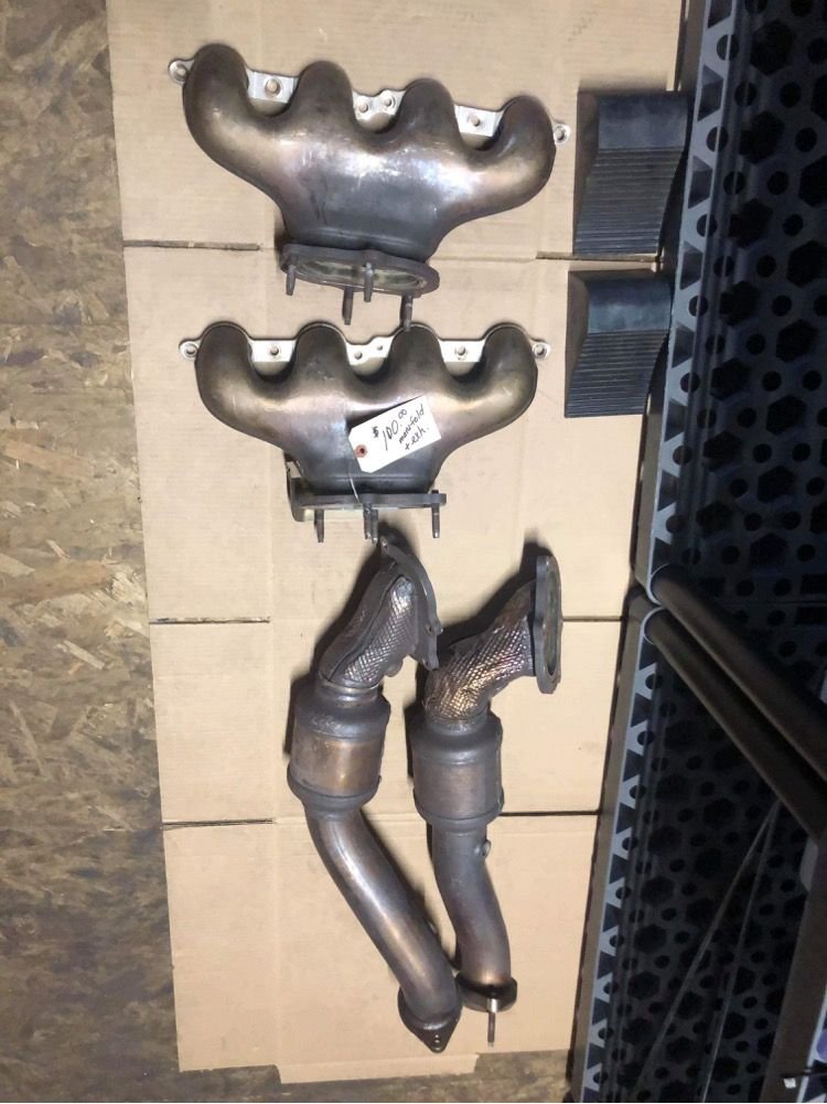

ok is this what i am looking for?
LS7 Z06 manifold with gutted cats off a 2011
I'm still curious about this too.
