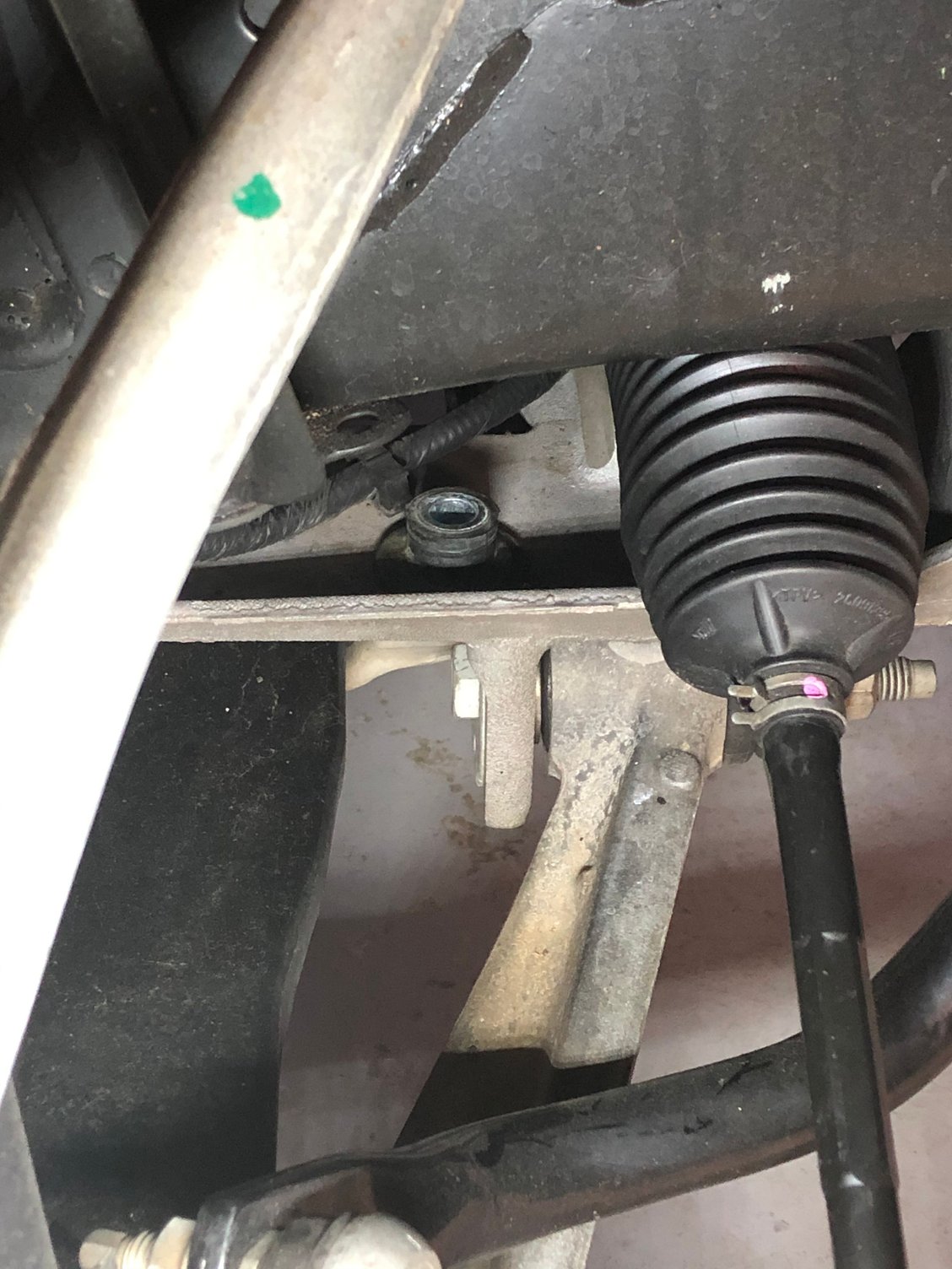

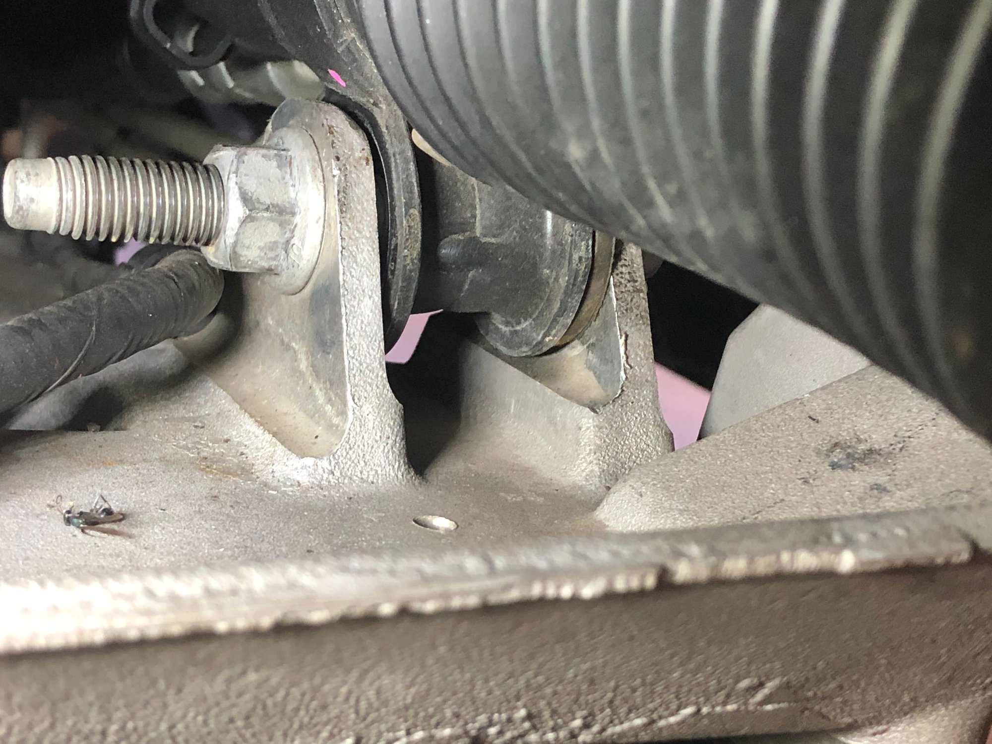

Posts: 3,183
Likes: 265
Originally Posted by XFIRED
How did you notice that the bushing was missing??
Was hearing some knocking sounds in the front passenger wheel area and something sounded loose. I pulled the wheel off and moved the rotor side to side and saw that the whole steering rack had movement. Looked closer and saw the bushing actually laying on the cradle. You can see the bushing laying there, must have fallen out when they removed the rack. Here’s a pic
