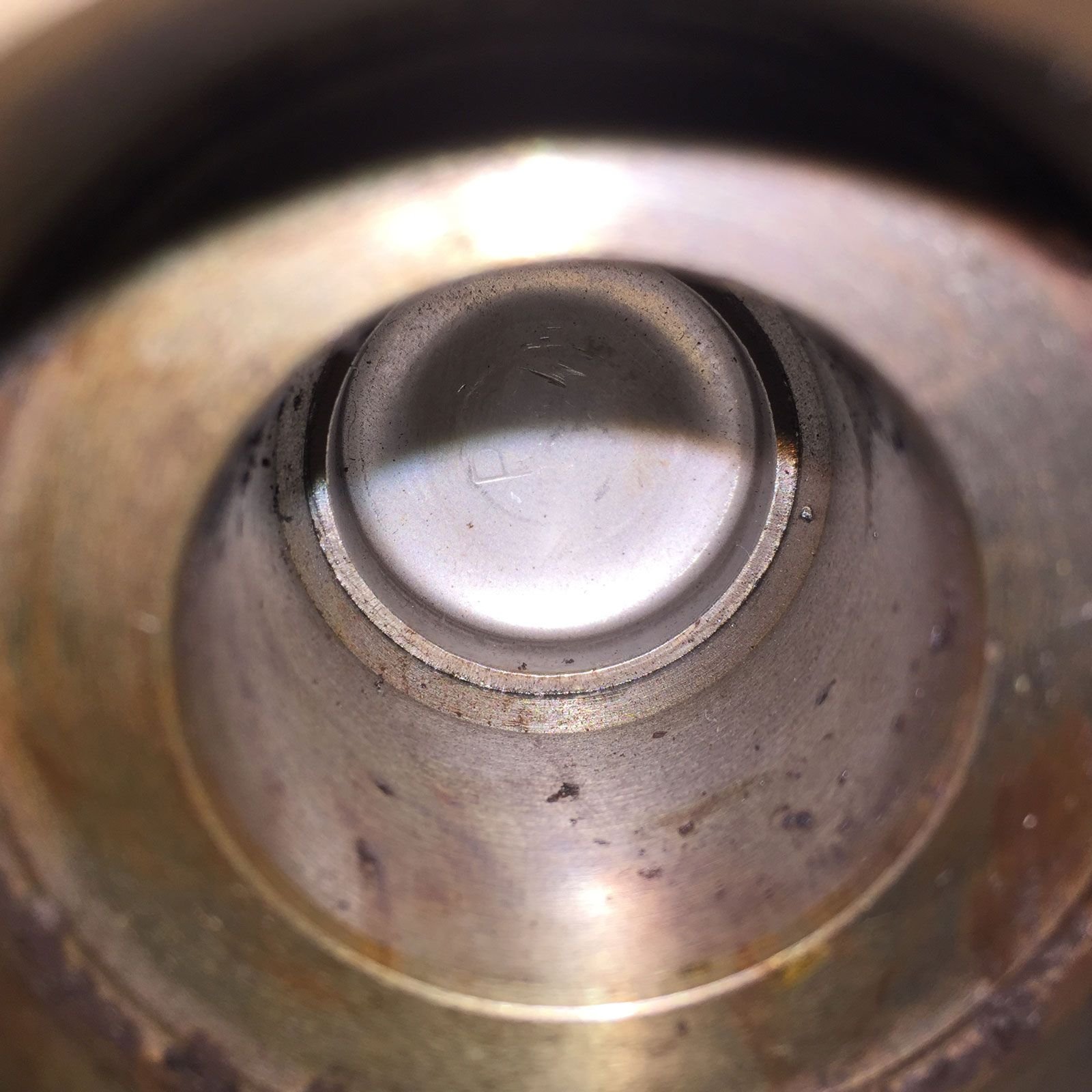

Here is a photo taken 5 minutes ago looking up the end of an LS crankshaft:
Look at that. There's a stamped plug pressed into the bore.
The bore is a through hole.

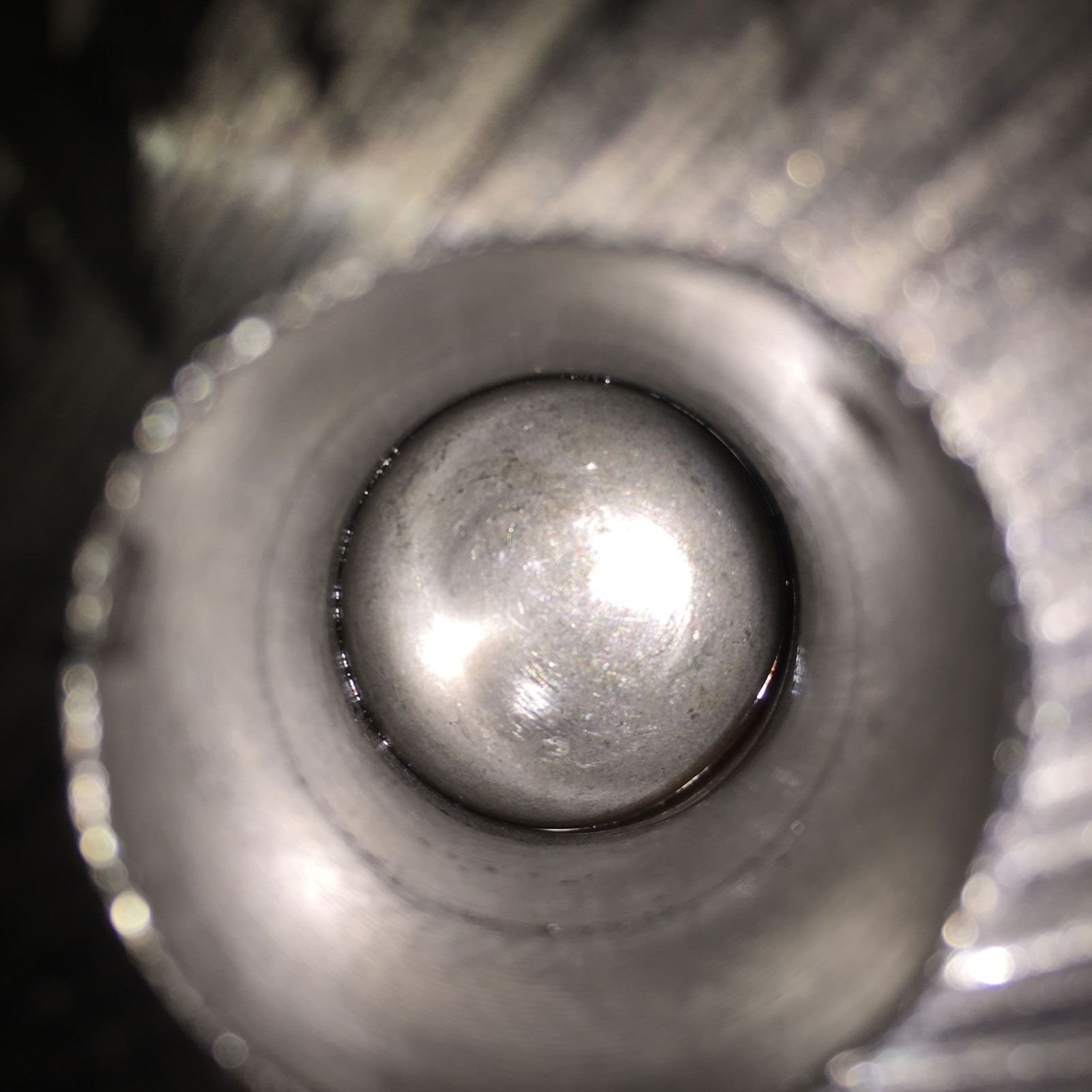

Don't believe me? Here's a picture taken 4 minutes ago from the other side of the bore, between crank throws, just above the 7-8 rod bearing journal:
This was taken from within the crankcase. That convex object in the middle of the bore is the other side of the plug from the first picture.
Oil exiting the rod bearings and draining down from the lifters, etc. gets in there. It would pour out the end of the crankshaft if it were not plugged.

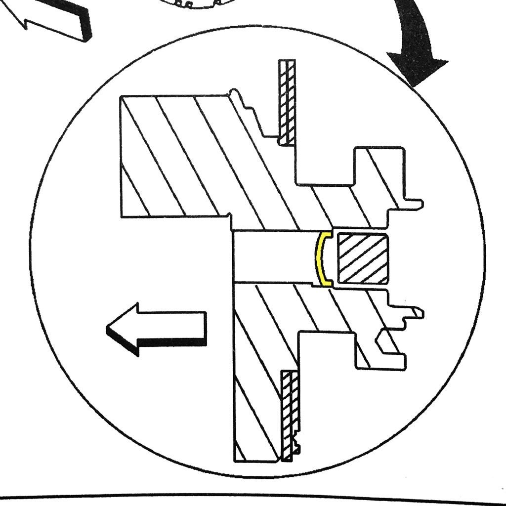

Still don't believe me? Here's a cross-section of the crank from the factory service manual:
Let me highlight the plug in question:
The part highlighted above in yellow. The oil plug you don't believe in.
That's the part I advise against pressing against with a puller when removing the pilot bearing.
