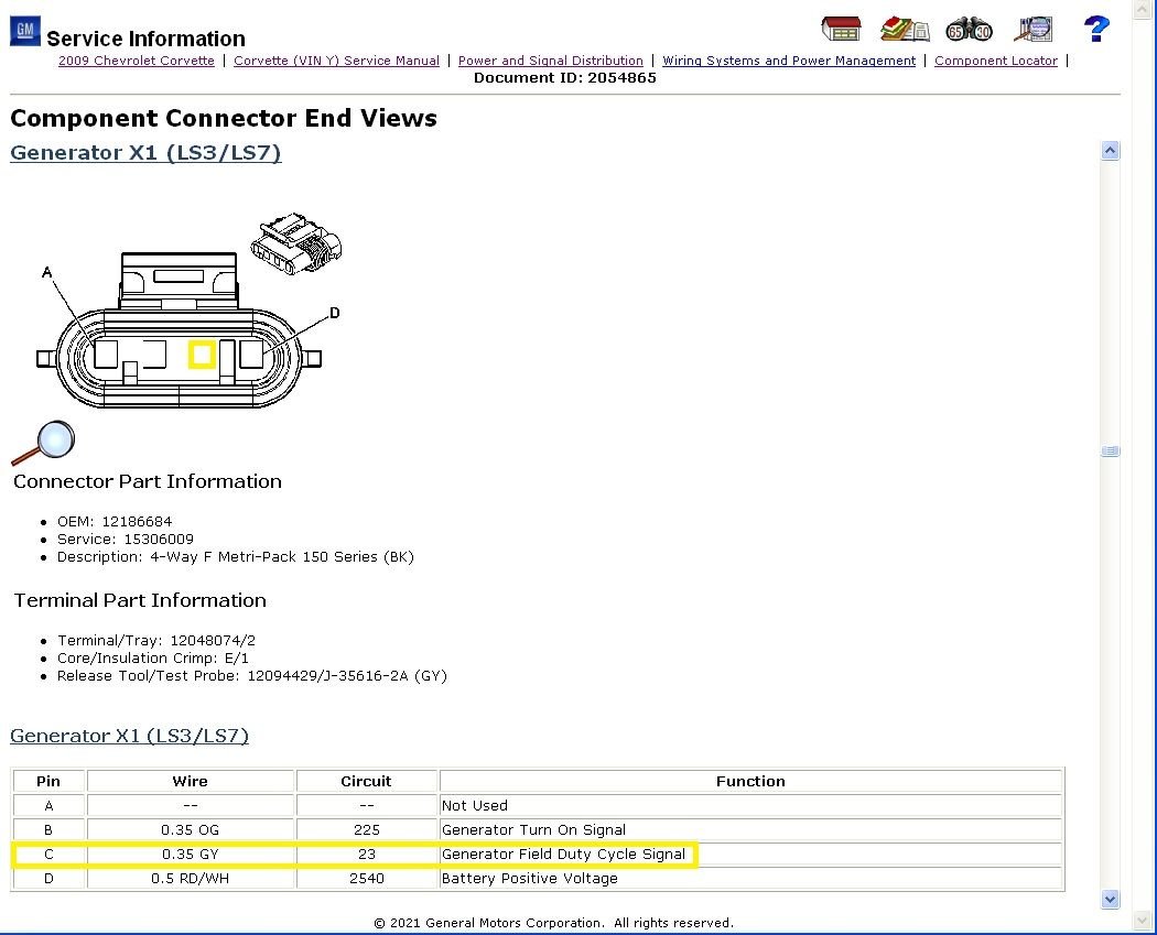

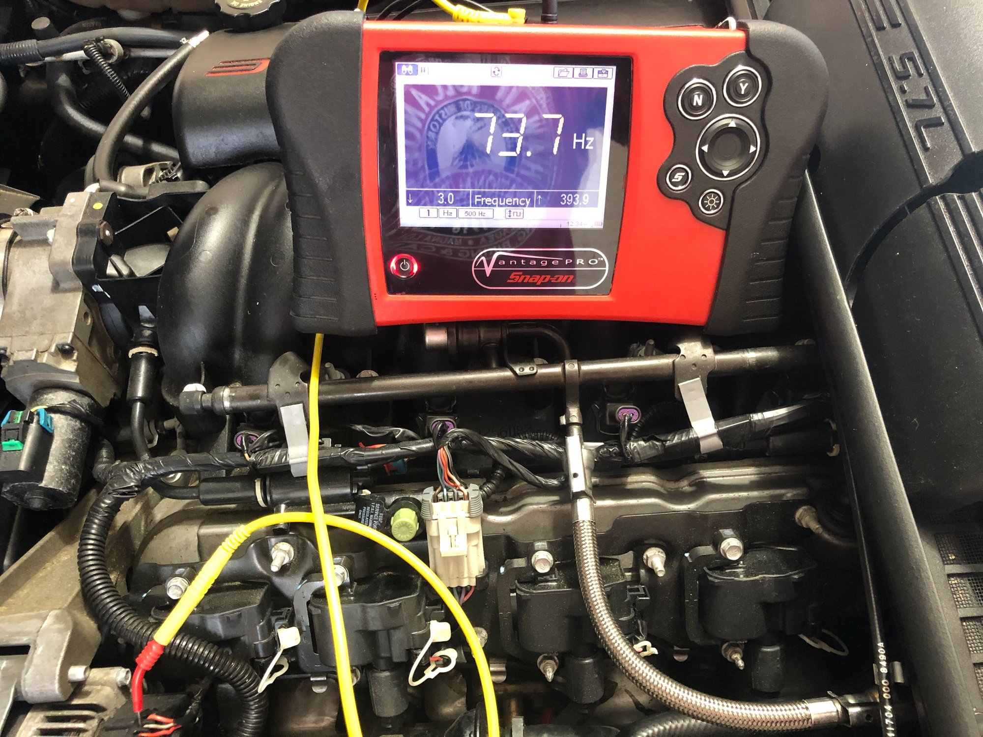

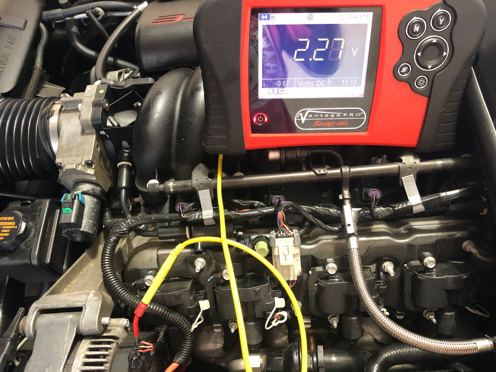

On my C5 the gray (F Terminal) at idle (no load)
reads 73.7 Hz, 2.27 volts, and 71.3 duty cycle as you can see.
Old Jan 10, 2021 | 08:51 PM
wjnjr's Avatar
wjnjr
Joined: Nov 2009
Posts: 3,298
Likes: 1,153
From: Klein TX
