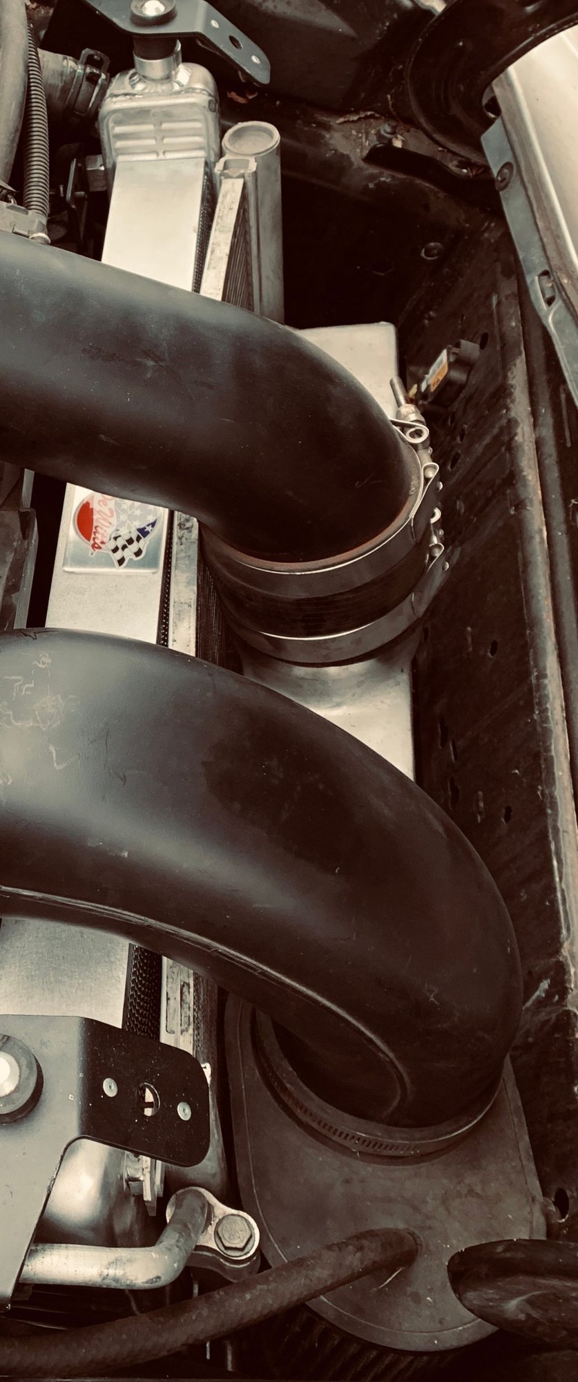

yea I’m thinking it has to do with the wiring or fan module since it gets over 105 at times here in Cali . I also noticed how tight stuff is with the radiator , ac condenser, intercooler .. that might be an issue but seems only when the ac is on .

holy ****.....no wonder it gets hot.......I'm surprised it cools at all.....

yea I’m kinda stomped on how to fix that lol fml Probably going to look for a shop that has dealt with that issue before hopefully and see

is there a way to push out the IC a bit forward or a modification to the foam in order to push out the IC ?

The AC condenser gets really hot and with the intercooler up there too, it can get hot quick in stop and go traffic. That's when you really need better fans and shroud. Need to pull more CFM through all that mess.
Also with an ECS kit you can make shrouds for the sides of the radiator that force air thru the radiator instead of allowing it to go around the sides. This helps a ton.
Look at Prospeed fans and their shroud (not cheap but works really well), and then make the side shrouds and you would probably be good to go...as long as you have already eliminated the simple stuff....water pump, debris in AC condenser, too much air in coolant system, coolant blockage, tuning, etc.
