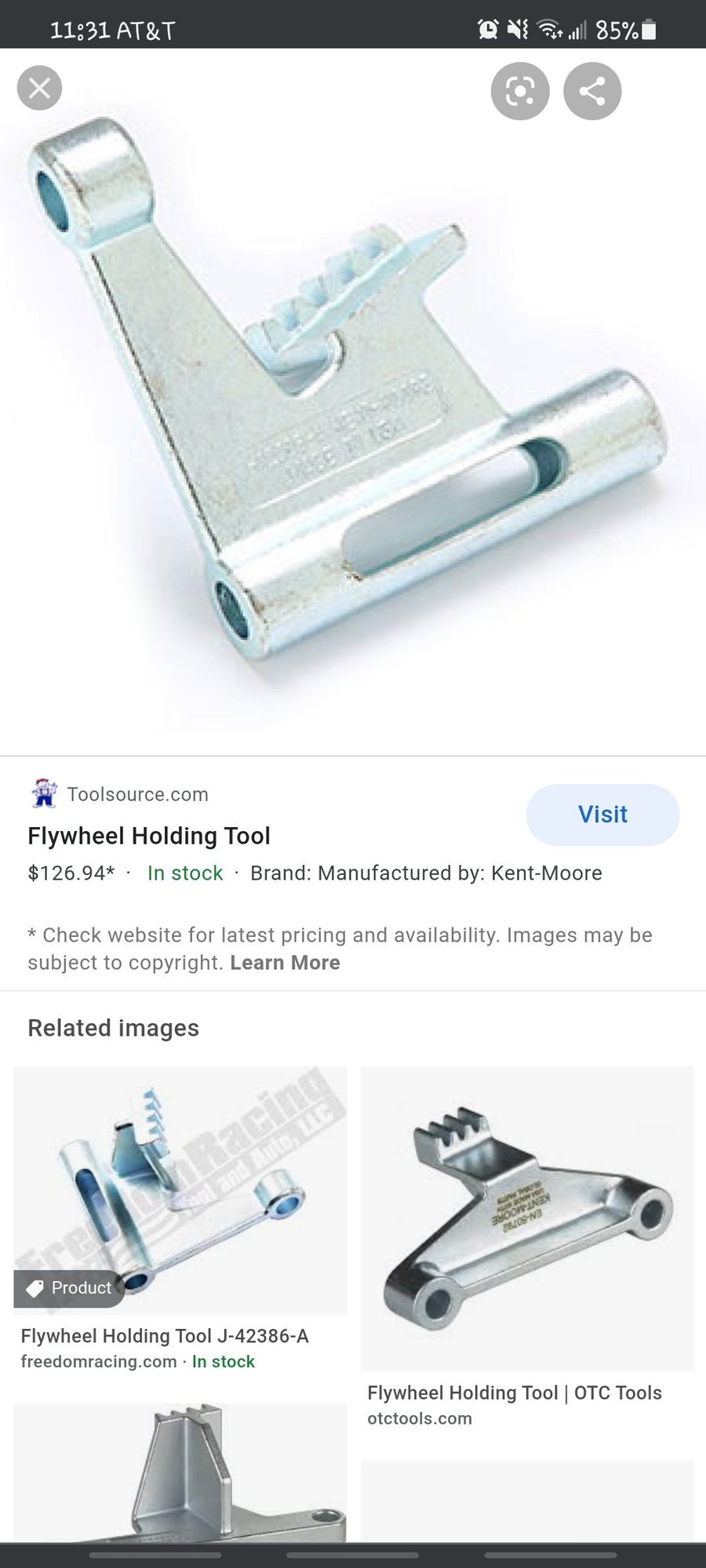

At this point the balancer will be staring you in the face but in order to get it off you'll need to lock it somehow. I use the flywheel locking tool shown below. Alternatively, if the car has a manual transmission you can put it in 5th gear and have somebody apply the brakes and parking brake while you attempt to loosen the bolt. Something I don't recommend (although I've done it once before) is placing a large prybar in the teeth of the flywheel to keep it from moving.
After the bolt is out you'll need a balancer puller tool to get it off the crank. I use the same one that the dealership uses as the three arms sit in the slots of the pulley without slipping off. I've had mixed results with the ones you can borrow or rent from parts stores.

I have a question regarding this process? I see allot of people say you need to pin your crank if you run boost.
Allot of the aftermarket balancers talk about key-ways on the hub. Does pinning the crank and using the key-way the same thing?
