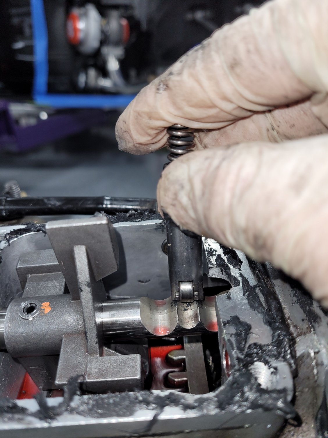

Not even sure what to call this thing, but under the shift linkage cover on my tr6060 there is this little roller (almost looks like a lifter) that appears to roll in the grooves on the shift linkage. Does the orientation matter or does it rotate as it rolls over the humps shown? Is this orientation correct? Would like to know before I put it back up in the car.

Confirmed that detent spring roller should be oriented to roll front to back i.e 90 degrees from where I have it oriented in the picture above. Hope this helps someone in the future.
