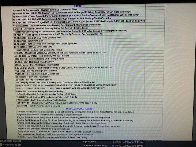

This list is what 10.5k will get me.

Actually that list is the original which is 12.5k with the true duals. With this build, I'm kind of at a point where I say what's another 2k?
