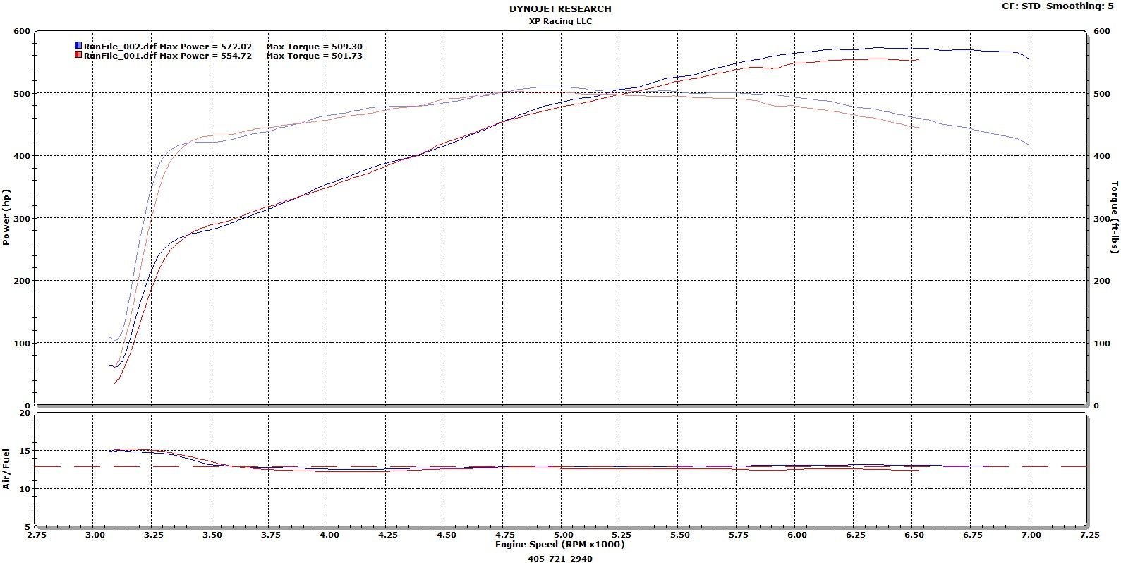

Does this flat line starting at 6,300 rpm look weird to anyone else? C6 z06, cam, ported stock heads, ported mad, NW 103, 1 7/8” longtubes, sbe. Im think maybe the heads can’t flow enough up top for the cam. 248/260 .657”/.655” 111lsa

I wouldn't be super concerned. Who did all the porting? Is the 103 ported? If not, could possibly be your intake manifold. If it is could possibly be valve float. Subbing to see some of the responses.

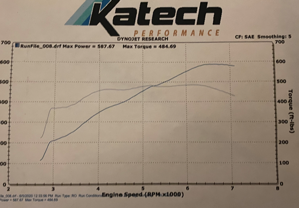

It looks like mine C6 Z06. I have similar mod as you have.
You dyno is STD versus the SAE of mine. Can you get a copy of the SAE version of your graph and see if it different?
Engine airflow has flatlined. Intake, head, cam or exhaust are maxed out.
What was the MAP during the run? This will tell you about intake side.

Mine is similar as well.
CNC factory heads, 102 TB, 1-7/8” Kooks and a recently ported Mamo MSD with a BTR4 cam.
I sent the before and after to Tony, and he said the heads were holding me back, and I should use the 2” header as well.
before and after the MSD porting:
he mentioned the MAF graph was solid up top and followed power curve.

Katech K502.
my OEM heads are ported and TSP assured me they are capable of flowing more than enough.
I have TSP heads as well. I know from looking at flow sheets that these heads fall off big time at like .630” valve lift. They also have big issues on the exhaust port from the factory design.
If the dyno is working properly, which may be a concern in this case, I also noted the following after several dyno sessions:
1. Valve float, these little LS valve springs will do that. I checked mine they were okay.
2. Clutch slip - mine did that and the torque curve suffered - as did power.
3. Timing retard - I had crappy gas and knock retard pulled timing and killed power. Glad I logged it.
4. Oil in the intake manifold. This can be a problem and could cause timing retard.
Just a few ideas...

Maybe you're just running out of airflow. Could be something as stupid as a dirty air filter, or as complex as that's all your heads/cam will allow

Possibly just out of airflow, possible some more timing after peak torque would help it keep going up, also possible it'd start knocking so they didn't do that for a reason

Could it be running out of fuel ???
Lambda numbers (Air / Fuel Ratio) will tell you the answer.
MAF doesn't tell you anything about pressure drop.
MAP will tell you about intake side pressure drop. If its holding 98 -99 kPa (assuming a 100kPa ambient) the intake side is OK (air filter to intake manifold).
I know the problem can’t be there. I have a new Halltech mf108 to new NW 103 to ne AHP ported MSD.
Everyone posted so far appears to think there's something wrong?
I would say the dyno plots posted are normal with the engine not moving more air with more rpm.

What's your injector duty looking like?
....and recorded lambda trace.
