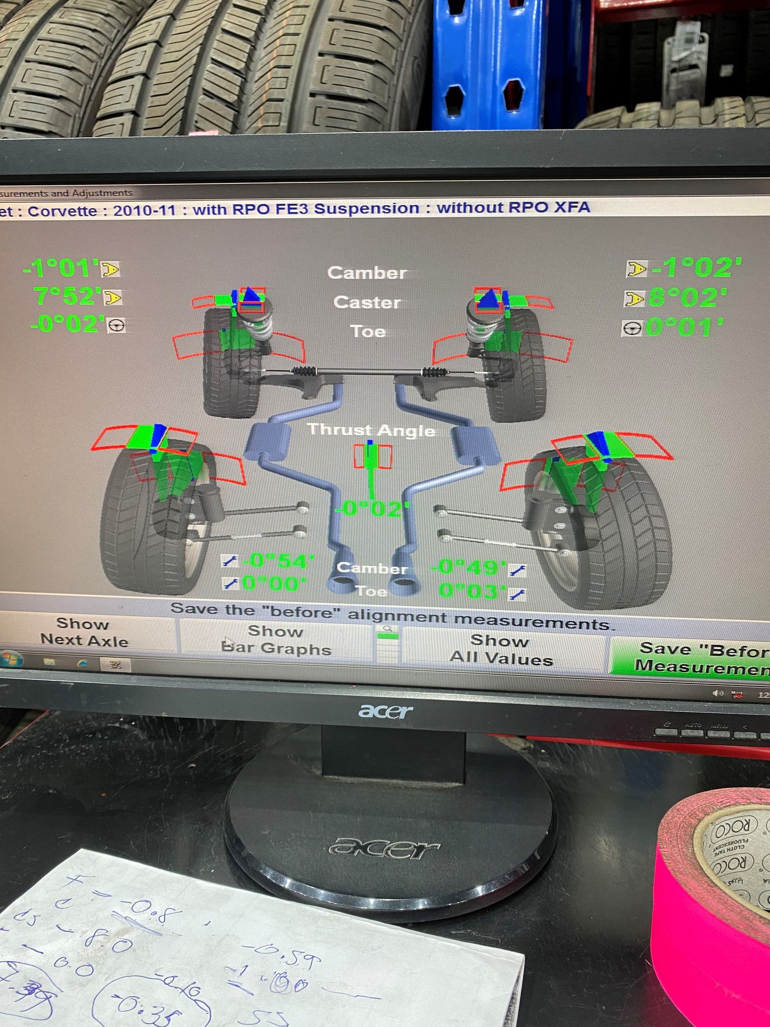

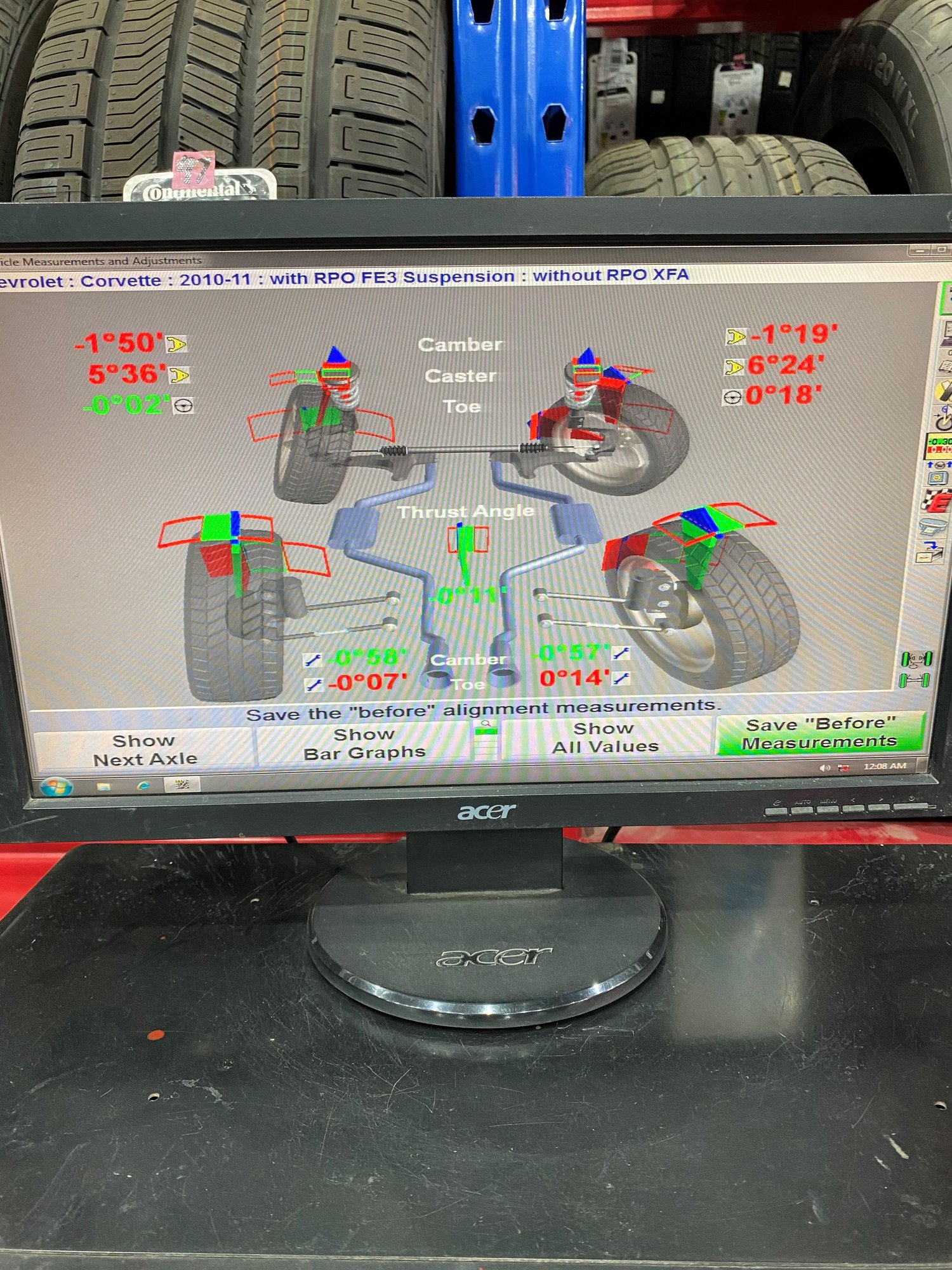

Old May 4, 2021 | 07:33 AM
ZHZ-416ci's Avatar
ZHZ-416ci
Joined: Mar 2015
Posts: 250
Likes: 15
From: Riyadh
Update
The alignment was really messed up.
Before
After
