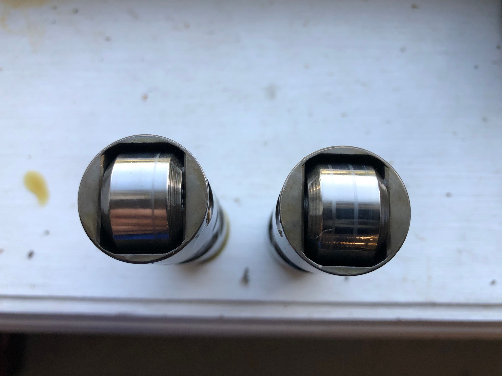

well, I kinda figured that too but when I had the stock lifters pulled none of them looked like your photo but prob 6 or 7 of mine had scoring on them. Like one or two perfect lines all the way around the roller, the rest looked perfect.
here is a pic of how they looked, running your finger across the roller there was only one that I could actually feel the groove.
many ls engine I pulled apart I never seen not one mark on the roller. Just saying I guess we will know soon enough what the culprit is. I hope anyway. I hate to hear they have know idea on how this happen. I hope u get a break and at least know that tick u heard was for real and not in your head.

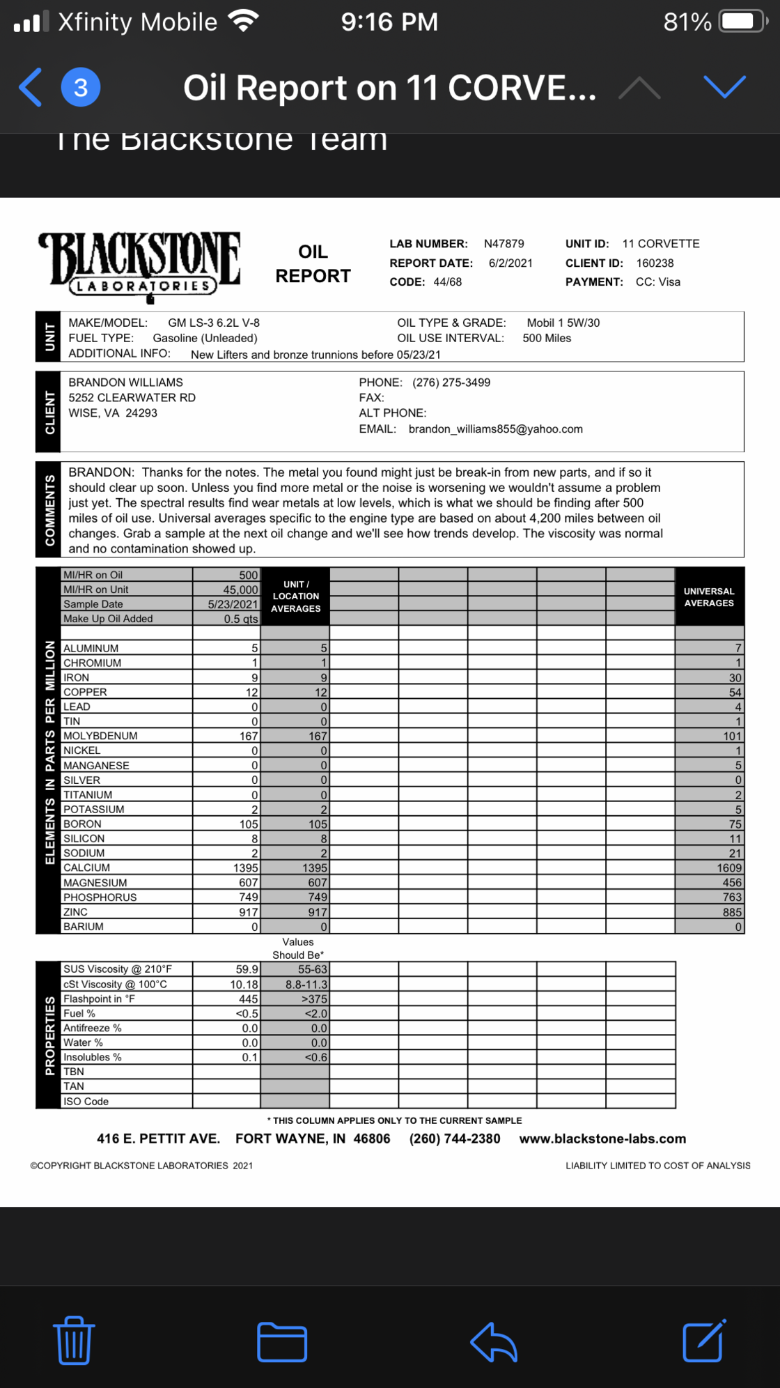

So this is a bit surprising... I got the oil analysis back and it was fairly normal despite having an alarming amount of metal in the oil.
I don’t know for sure but I believe the oil had 200-300 miles on it and was consistent with typical weather after 500 miles. Nothing really stood out as being really high.

Will from what i think your bottom end is good. but the oil has to travel through all the breaning. u would think something had to been scroted. Let hope not.

I know, that’s my biggest concern 😬
I dropped it off at the shop the other day and they are going to look into it but the only way to know if there is bearing damage is to tear it down, but I don’t think they had planned on doing that.
