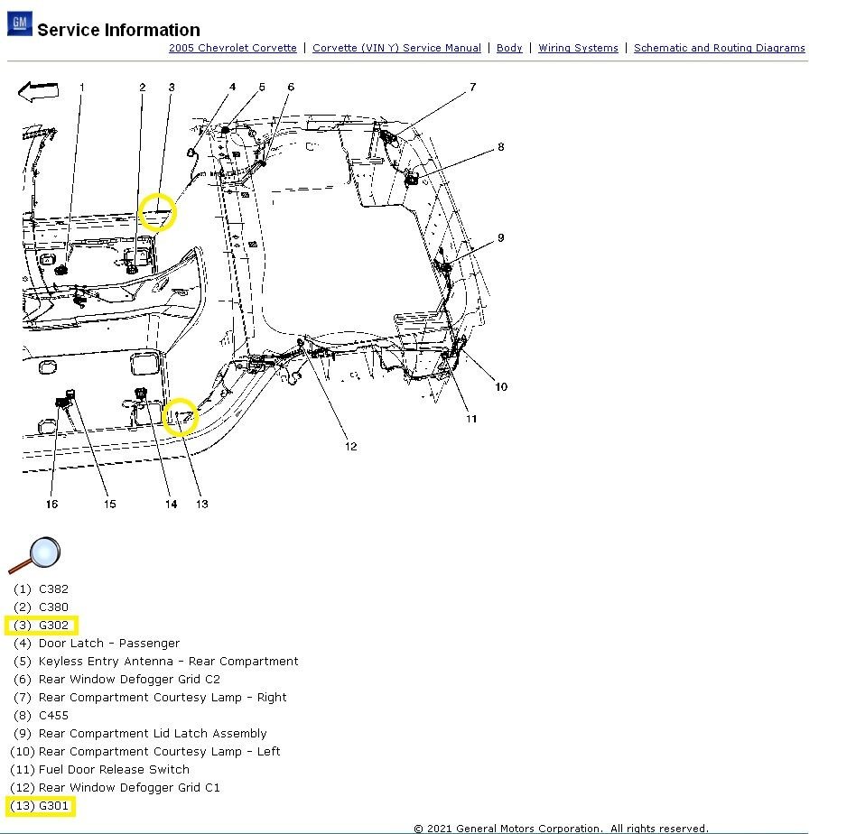

Here's a couple of diagrams from the shop manual showing grounds G301 & & G302. Looks like they're located on the frame rails just behind the seats.
Hope this helps, good luck and let us know what the problem was when you find it.
