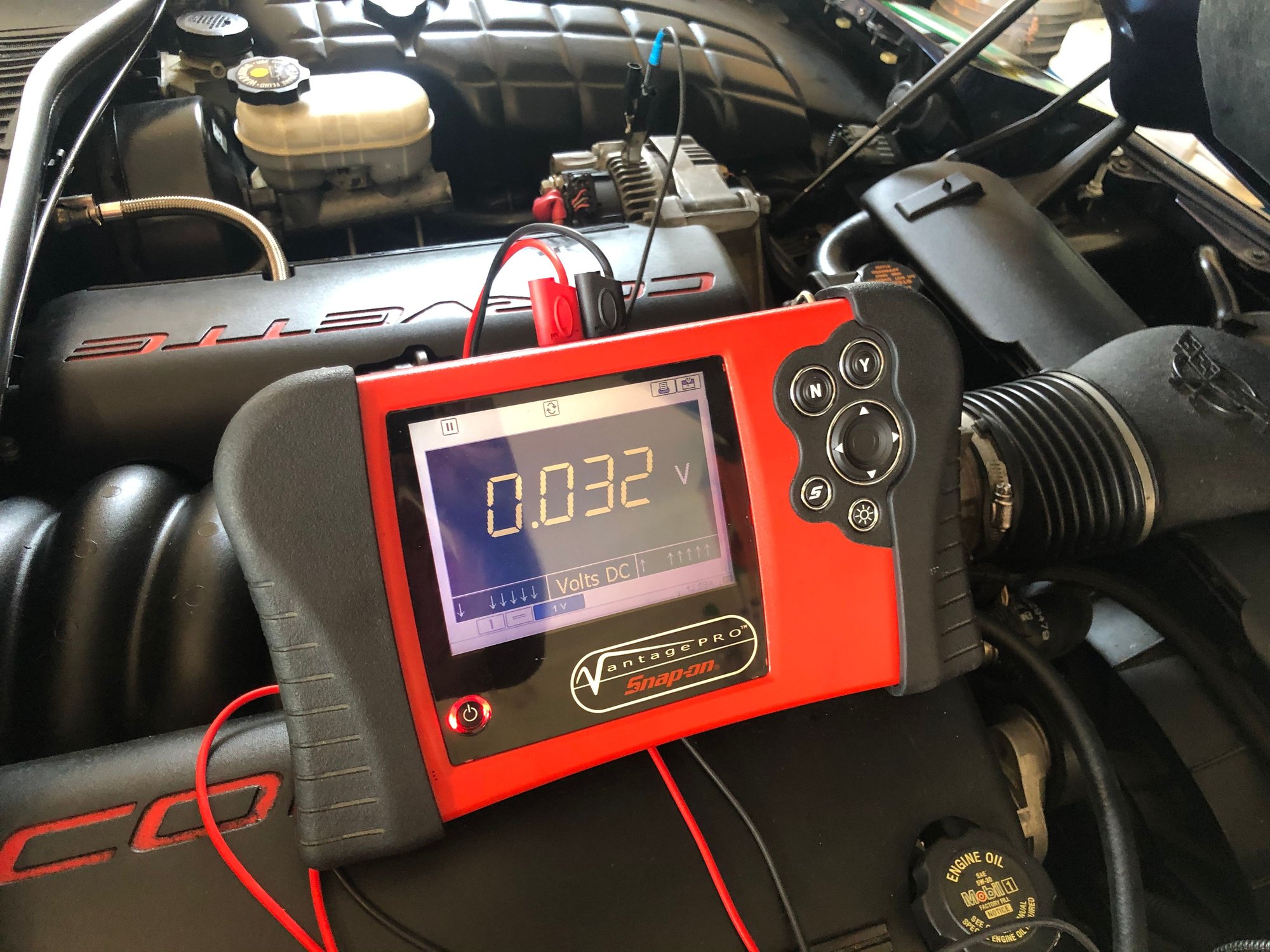

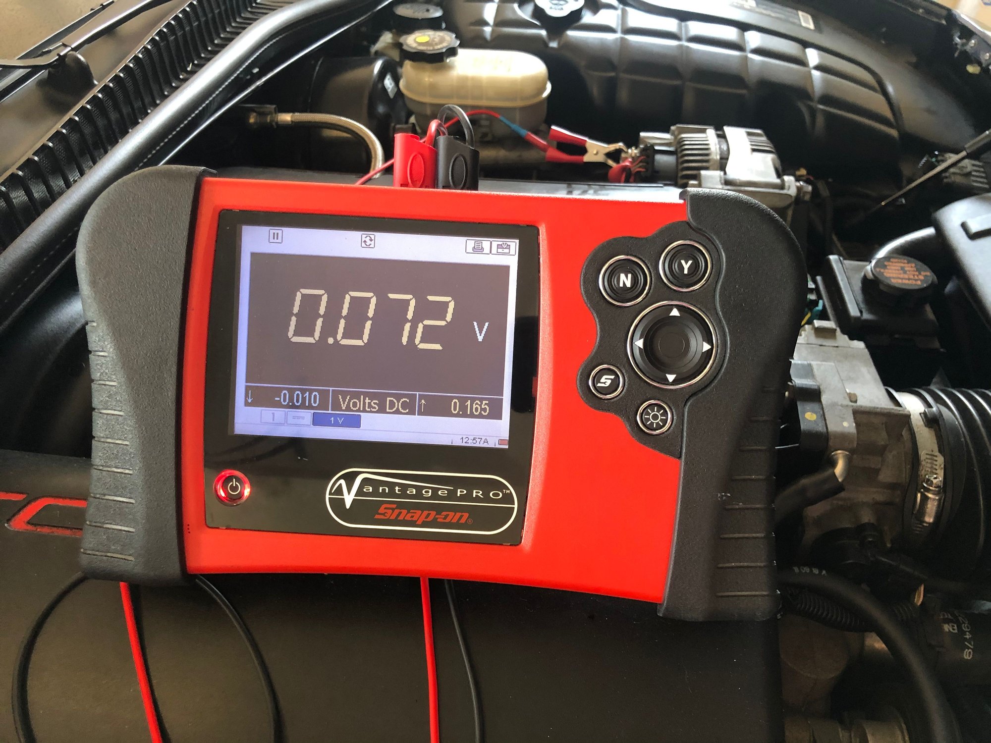

Can just be a loose connection or dirty connection down at the starter solenoid...this is where your B+ from the alternator and your positive battery terminal cable come together...if you take one lead of your voltmeter and put it on the positive battery terminal and the other lead on B+ of the alternator see what you read with the engine running...don’t worry if you see minus voltage...you can switch the leads if you want...should be below .5 volts...now go from the negative lead of the battery to the alternator case...should be close to 0 volts...this is what I see on my 2001...0.072 volts on positive and 0.032 on the negative side...14.4 is a good charging voltage !!...every other year I get under the car and remove all the wires at the solenoid, wire brush, and reinstall..also the negative lead of your battery is down there on the engine block...clean there too !!

Thanks for the advice. As per your directive I just checked. Pos to Pos .43 and Neg to Neg .03. Seems to me to fall inside the pass window. Any ideas?

.5 volts is GM’s number (way high by many)but as you can see my voltage drop is not even .1 !!...i like to see .2 to .3 MAX...I’d say get underneath and clean those terminals...make sure the connections at the battery are clean and the B+ terminal at the alternator is clean and tight !!...if you are not having issues with starting the car changing the solenoid isn’t necessary. Do you see your charging voltage decrease when getting the message ?
