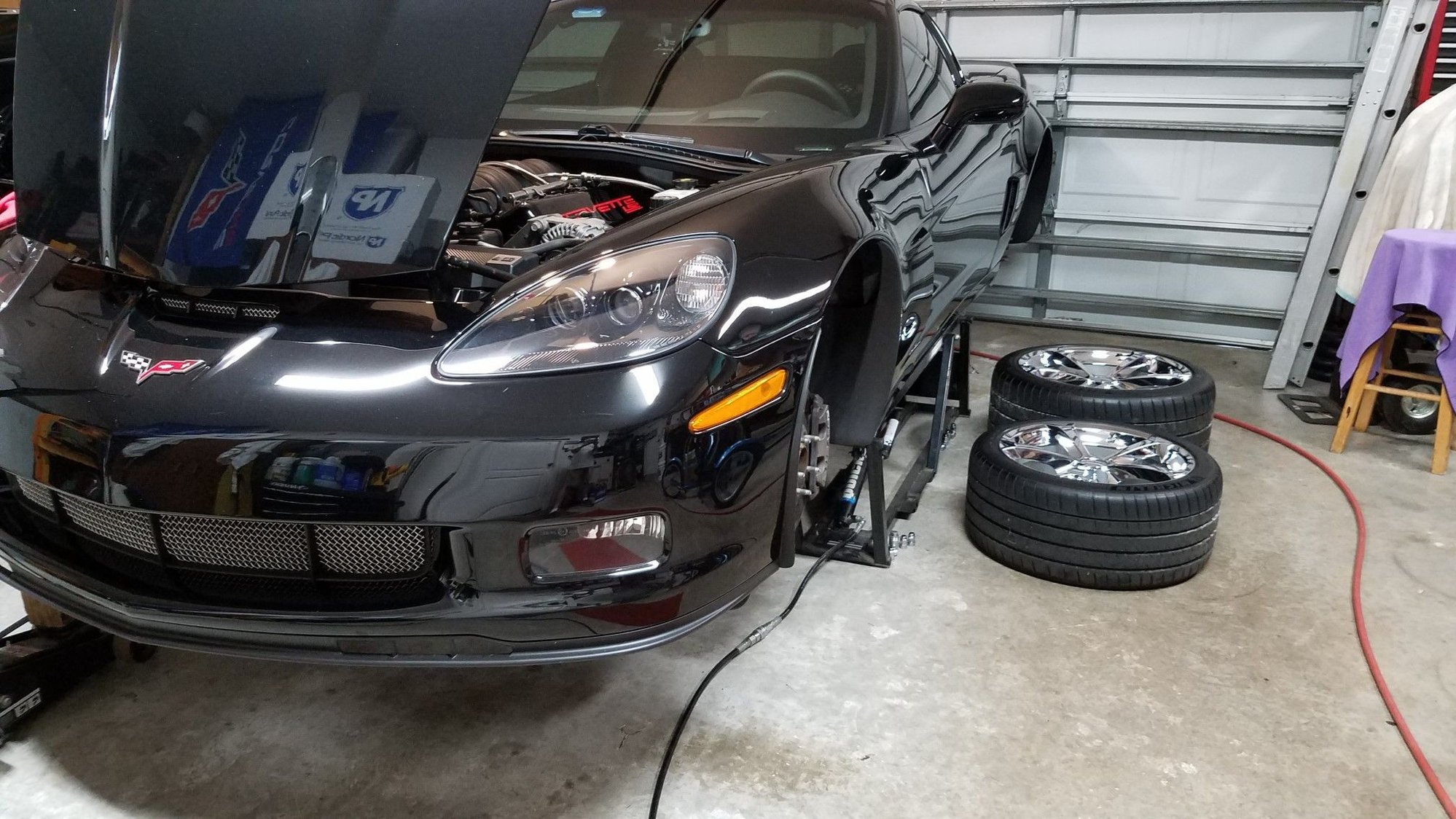

I love my QuickJacks. My 07 is up on them right now, locked and set up for a headlight install, which I'll probly finish tomorrow. I have two sets of wheels/tires, a Summer set and an All-season set. Gotta be able to change wheels myself. I used the QuickJacks for my Axle-back upgrade, for an Auto Trans Fluid replacement, for a Brake Fluid Flush, and last week when I replaced OEM bars with GM Z51 Anti-sway Bars. Yes, they are quite heavy to move around (I'm 65) and it takes a few minutes to set them up. But I would not do the Corvette work myself without them.

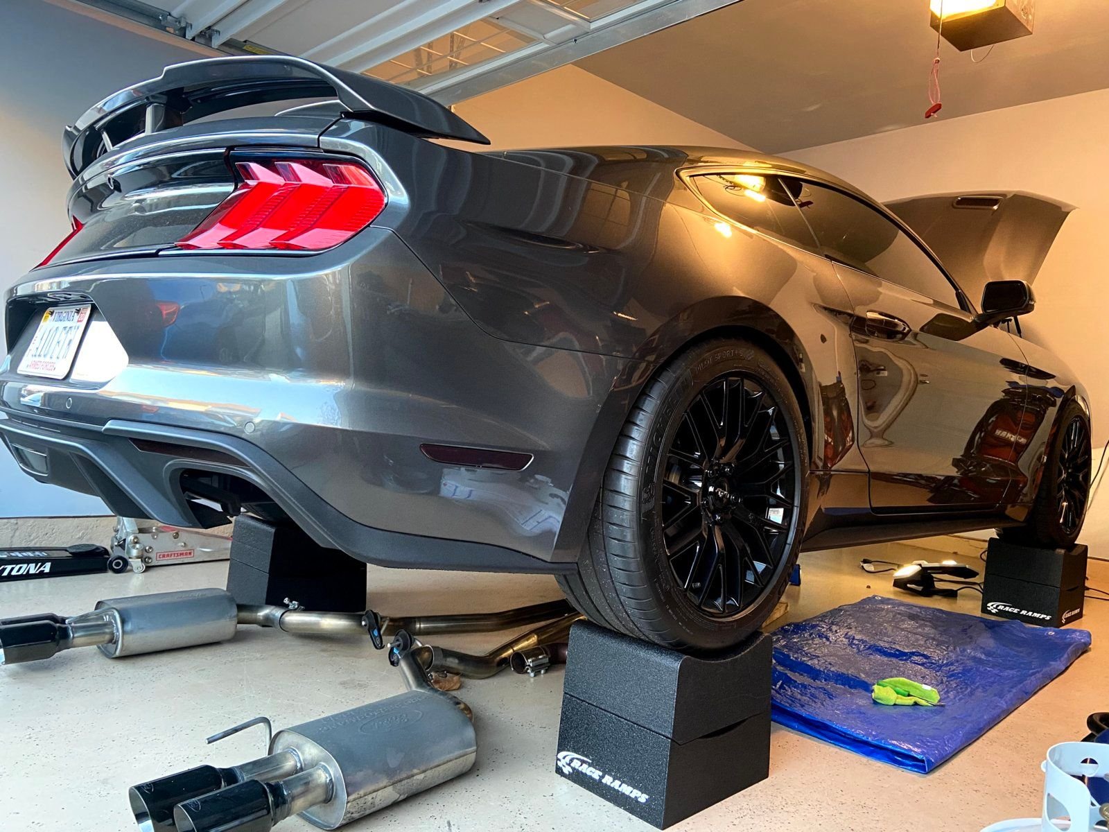

I had a set that was gifted to me, but ultimately they were nothing special. They're a combination of a jackstand and a ramp, but they don't have the ease-of-use of ramps and they don't allow you to do any wheel/brake work. I also ended up gifting them to a friend, because they didn't serve any purpose for me that I felt warranted having both jackstands and the blocks. I'd much rather have a set like Vol mentioned with drive-up sections that can be removed, because then I don't have to go around jacking it up.

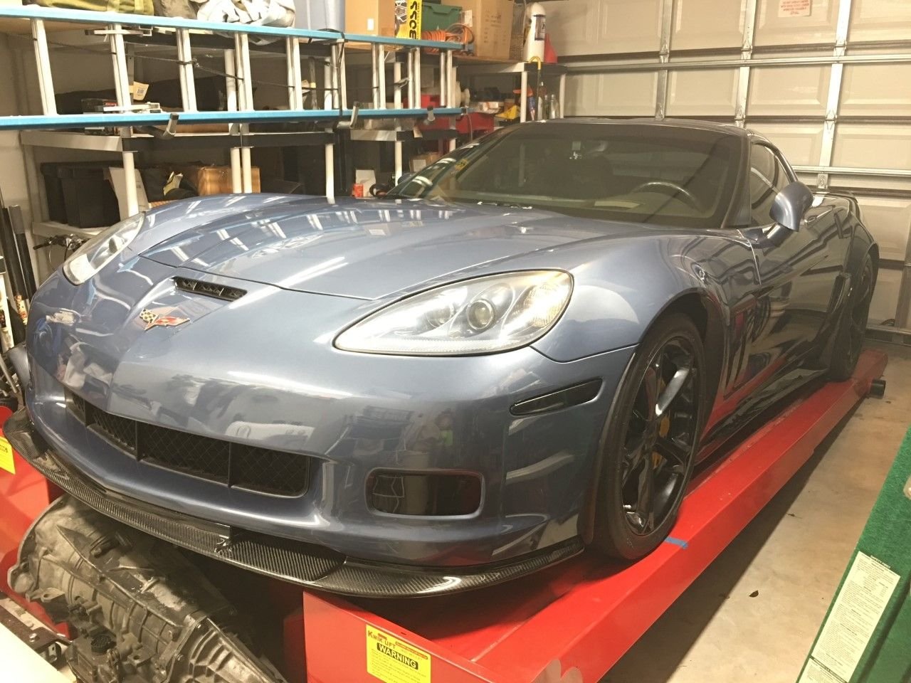

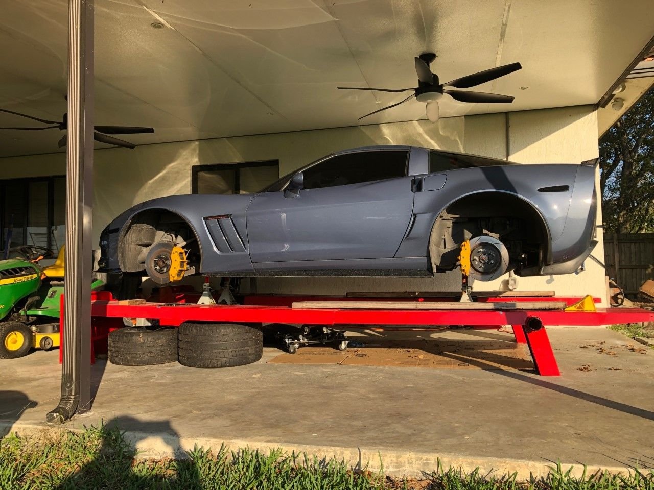

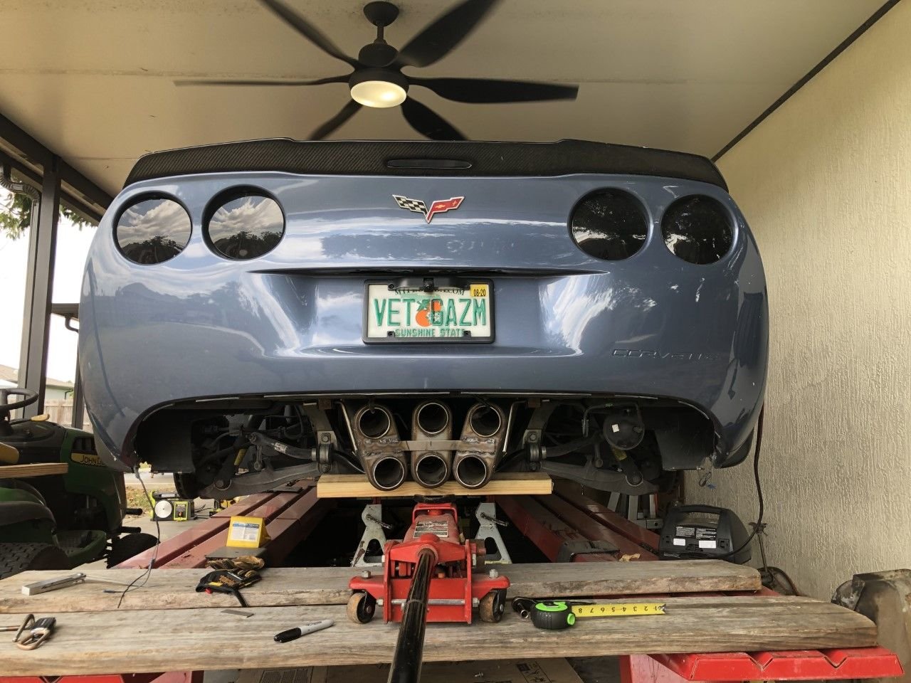

I purchased a Kwik Lift several years ago. I currently have it set up on my back patio and park my Vette on it. I used to have it in the garage and just parked right on top of it as well. So although it took up space, It was a reserved parking space that I was able to use for all of the vehicles we owned.
I think it was one of the best investments I have made for working on the cars.
SPEED SAFE, NICK

how many inches room do u have under the car now? how did you get it so high
