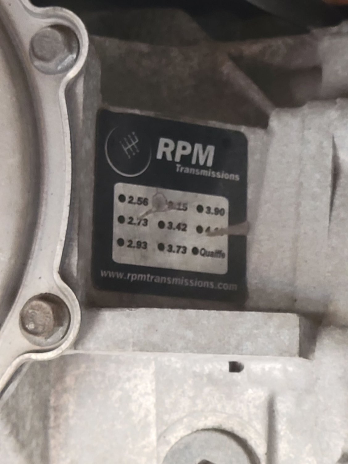

Started tearing it out and atleast i found one good thing during this whole deal....
and dang this drivers side billy boat muffler is being a real bish to get out

RPM used to rebuild 6L80e's but quit after a short time IIRC.
Unsure if you have a vendor lined-up yet?
I had a couple different options and ended-up going here based off their reputation and experience. I worked directly with the tech, upgraded everything to level 4 (which was quite spendy) including in-house spec'd built converter.
They have a ton of positive reviews.
Top notch tranny shop for sure.
https://gearstar.com/6l80-transmissi...ith-converter/

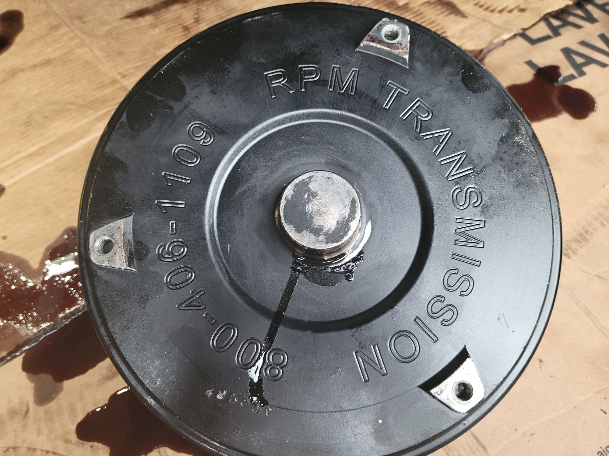

Found this lil bugger hiding in there... found out its a precision 10.5 2400 stall. Sending it back to get cut and cleaned and restalled to 3200 for $295. Between finding this and the rpm built diff, almost makes it all worth while lol

Go 3600. Daily drive a ls1 z28 with. 3600 yank. Drove like normal until I hammered it.

Idk if i need that much honestly. Its paxton blown with a small cam and meth so its got plenty of power and im really only gonna launch it on radials at the track a few times a year. Maybe a lil more often on the street and definately alot of rolls. I definately need a sub 9.9 timeslip in my hand tho
