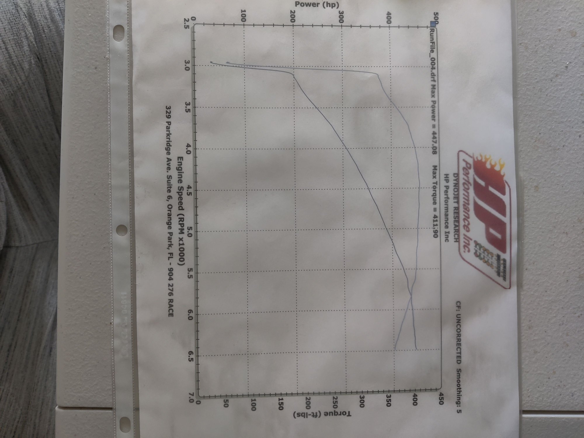

Going to pick the Vette up tomorrow after some new mods, previously was a head cam LS2 making 447hp /412tq .after adding a tony mamo ported fast 102 and a katech 103 in 90 + heat the ls2 still made substantial power.ver happy with the new found ponies thanks Tony.. Dyno graph below

Afr 205's 231/237 lift 591/ 601 lsa 112

Original Dyno heads cam

Was the previous dyno with stock ls2 intake?

Yes, apparently the ls2 intake is trash. Huge gains with the ported fast 102 and throttle body
