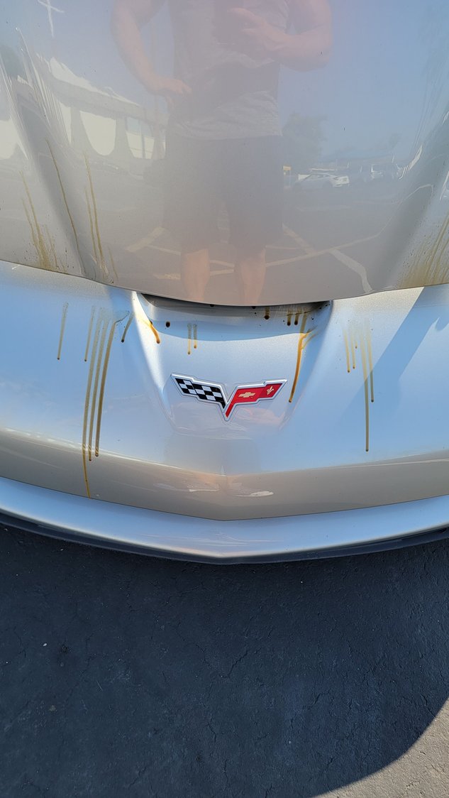

So this happened Tuesday night after doing a 1st through 4th rip 🚨
Temps outside were 106f that night and car was running cool around 215. Had good oil pressure and 50%ethanol. Car ran through 3rd like a champ felt so strong. Hit 4th and it fell on it's face. No sounds of breaks, booms, grinding. Just a flashing check engine light and a p305 code for #5 Cylinder misfire. I was near home and because I heard no sounds or saw and drastic changes on the dash. I limped it there.
Got home no leaks, no visible signs of damage. So I was thinking I have a bad coil, plug, or wire.
Drove it around the next day just to verify and Temps got warm fairly quick and I noticed debris on the windshield so I pulled over.
The pics are what I witnessed 🙈😬

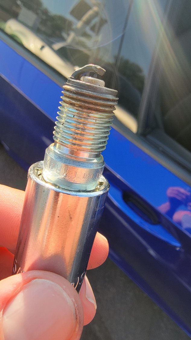

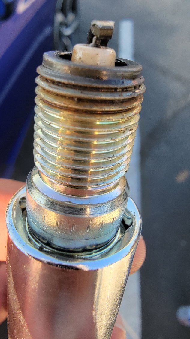

Pulled #5 plug and this is the damage
Any input or suggestions would be great as I haven't pulled it apart yet.
I don't see any damage ... All I see is a photo of the front bumper cover and hood with engine oil splattered over it.
Where is the photo of the damage ?

Sorry all the pictures didn't upload

not sure where that hose is connected, but looks like something smashed the plug.....
you're gonna want to take a look inside cyl5 and see whats in there..... good luck!

Where is all the oil coming from? What do you mean debris on the windshield?
To me it looks like catastrophic engine failure. Only way I can think as to why the electrode of the spark plug is bent is something let go like a connecting rod or piston. Add in the oil all over, you likely need a new engine.

Yep, something very expensive smacked that spark plug.

My first guess would be a dropped exhaust valve.

My guess would be piston related. Don't think it would be running smooth if the problem was in the valve train. Detonation will bugger up spark plugs. That, or a piece of the piston slamming into it before exiting out the exhaust. A broken piston will increase crankcase pressure and oil will be forced in a lot of different directions that oil wasn't designed to flow.

Time for a compression test. If No. 5 is low, just start pulling the motor apart. See if the heads can be saved.
I had one where the lands on the piston gave way - top of piston looked OK. Car idled OK, compression was way off (about 1/2 the other cylinders).
I pulled the oil pan and looked up, still looked OK. I went to clean the oil pan in the parts cleaner and I found bits of piston rings and some small aluminum ring lands. Note: this was a deep sump racing oil pan and the bottom was welded square/right angle and the bits were disguised and dirty oil hiding in the corners.
Light hone on the wall, new piston, back in business.

me thinks you popped a ring land

At a minimum I’m gonna go with a few bent valves, at least one cracked ring/piston or both, and probably a cracked block as well. That’s a real bummer.

Looks like a dropped valve, probably exhaust. Severe detonation is not going to bend the ground strap without peppering the ceramic and rounding the edges. That looks like mechanical damage. If it pinched a ring land the piston would hold together. That looks like the valve finally broke apart and punched it up into the plug. Perhaps the pieces stayed in #5 and didnt go up into the intake manifold and back into another hole!
