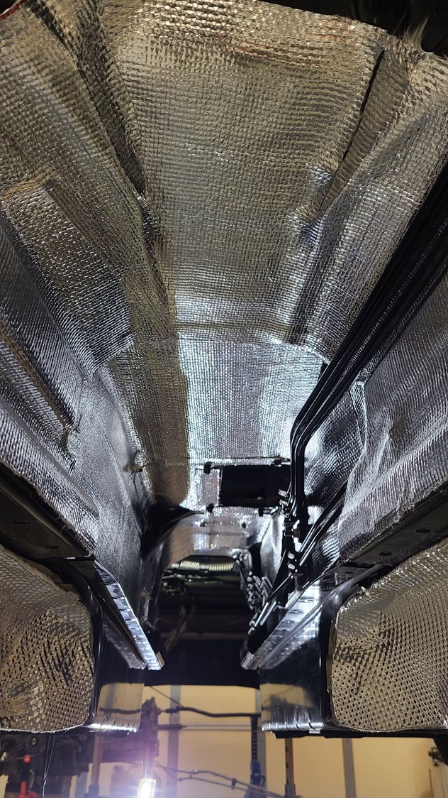

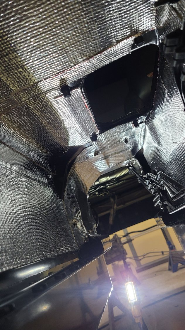

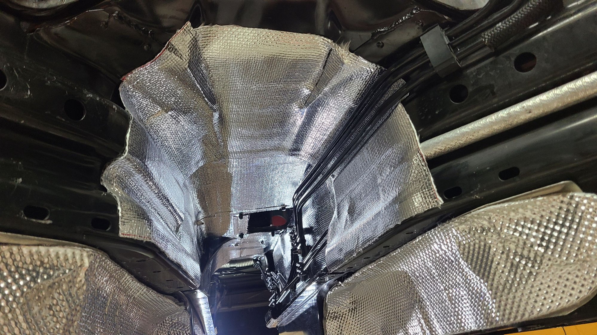

its dei reflect-a-cool adhesive backed mat...
Amazon Amazon
wipe down all the surfaces with mineral spirits, then cut to fit, and roll on with an insulation roller....
