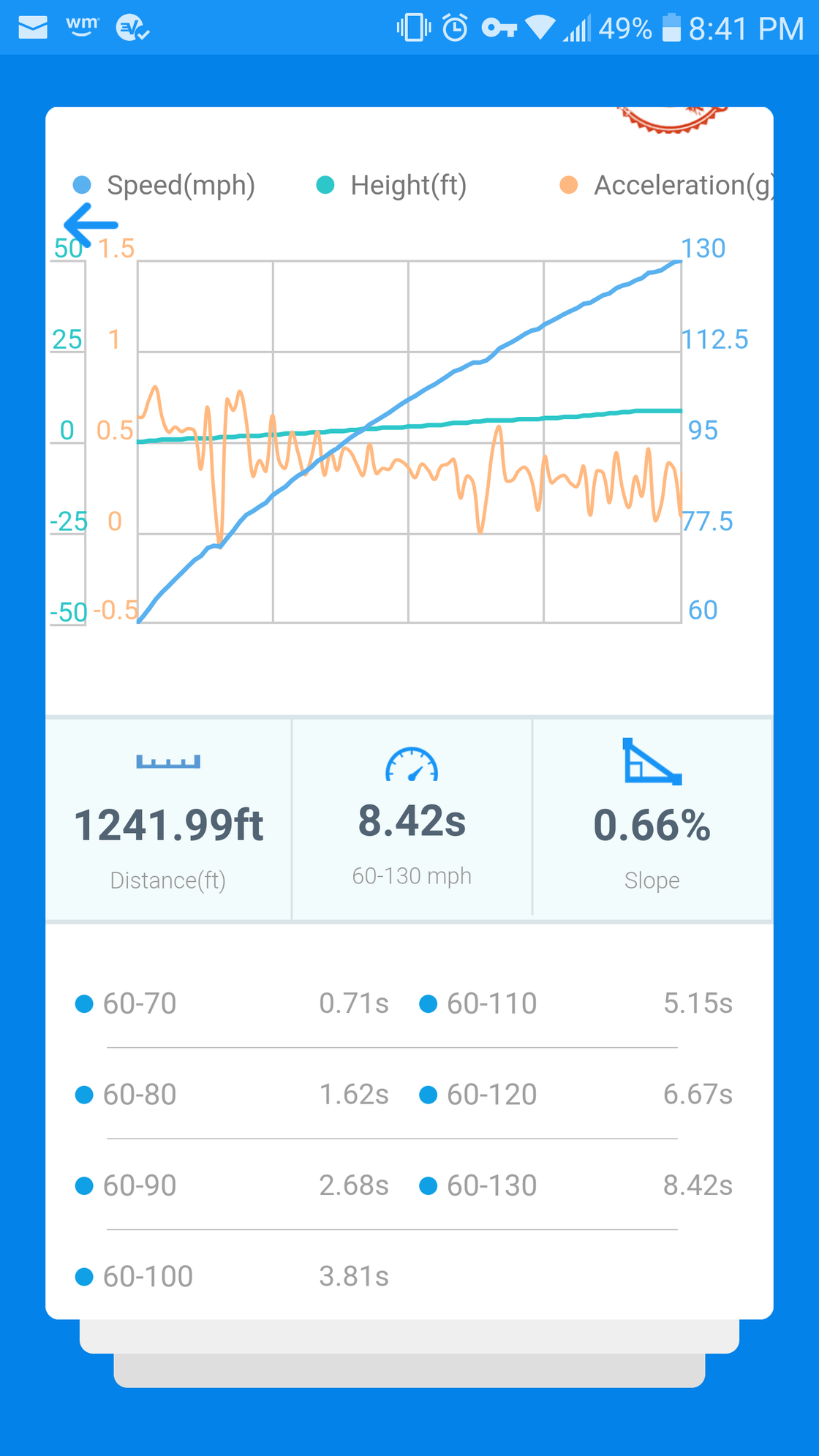

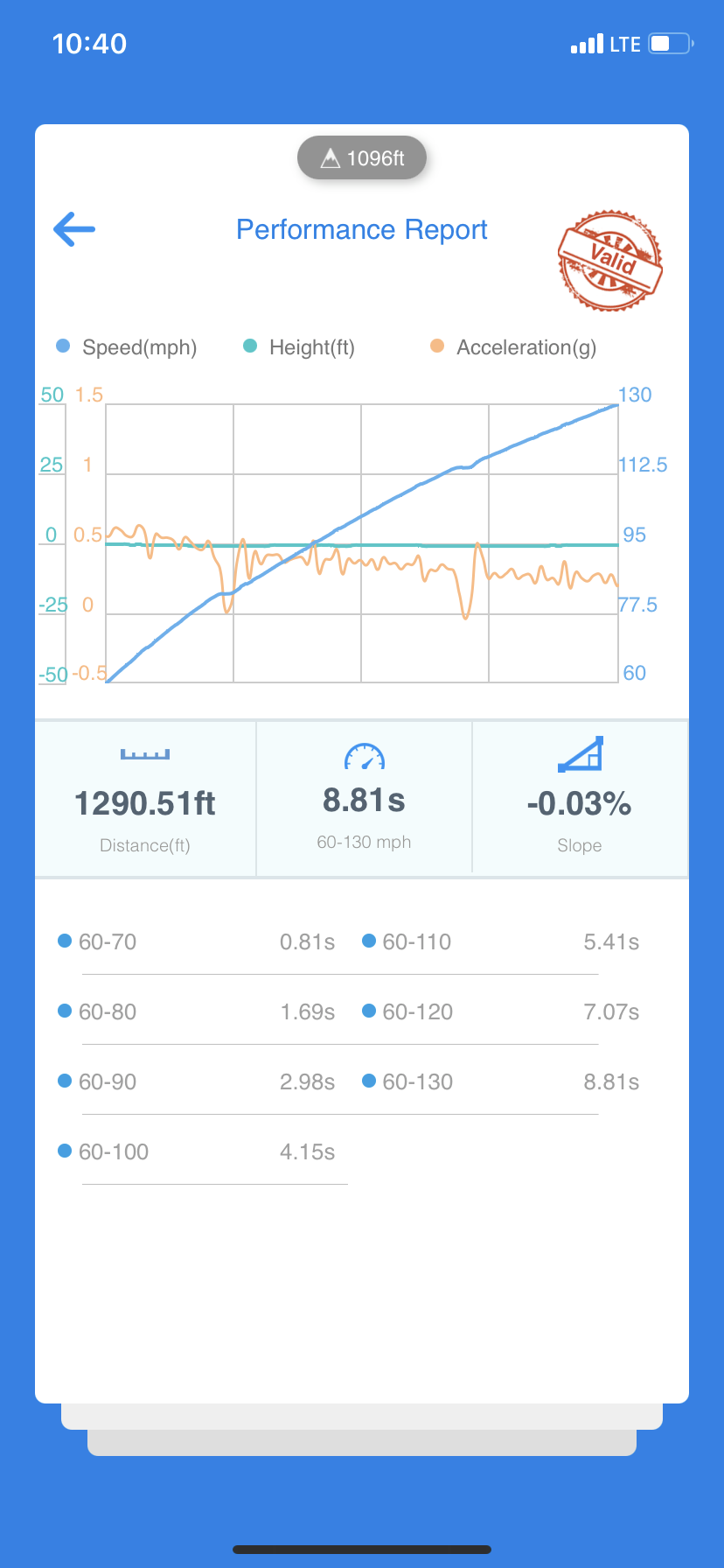

Not sure if this would be better here or in the general C6z forum. I have a basic heads/cam package with headers and exhaust. I put down 574rwhp. I was using my dragy and 60-130 it was 8.5 on a flat road. My friend said it was a little slow for the performance. I mean my shifting is fine. Am I about in line with where I should be performance wise or should I be quicker? Thanks!

I have a H/C LS3 M6 and my 60-130 ranges from 7.8-8.0 so I would say it does seem a little slow. My car makes 500whp. I would think yours should be around 6.5 or so.

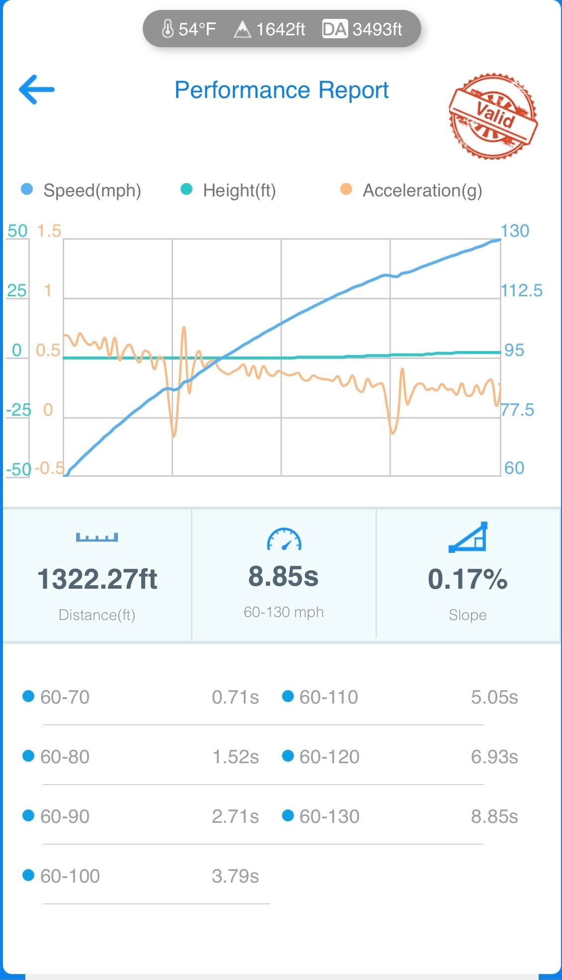

Don't know if this will help you out, but here you go:

How are you doing the pull?
Are you already into the throttle or are you just flogging it at 55 MPH and trying to get a good time?
From what I understand the best way to do it is to be in a full pull before the 60 MPH (fully rolling) and the DRAGY starts counting as soon as you hit 60 MPH and will stop at the 130 MPH and if you have the 100 -150 MPH set then keep on rolling to 150 MPH and record that too!
I own a DRAGY as well and I have tried it different ways and you should be doing a full pull before the 60 MPH or in a full pull leading up to the 60 MPH start of the recording, because many factors can come into play, example - perhaps you don't have traction at 60 MPH and you break them loose on the road you are running on (this is what was the problem on my C5 with 734 RWHP, no traction at 60 MPH when I would flog it, needed to be rolling)
Either way post up some more results after your runs -
Also check out the DRAGY 60-130 MPH section (if not already done so) and look for comparable vehicles to check yours against - your probably not far off as you think you are (and depending on the weather and fuel, you could of been pulling timing, try a cooler part of the day too)

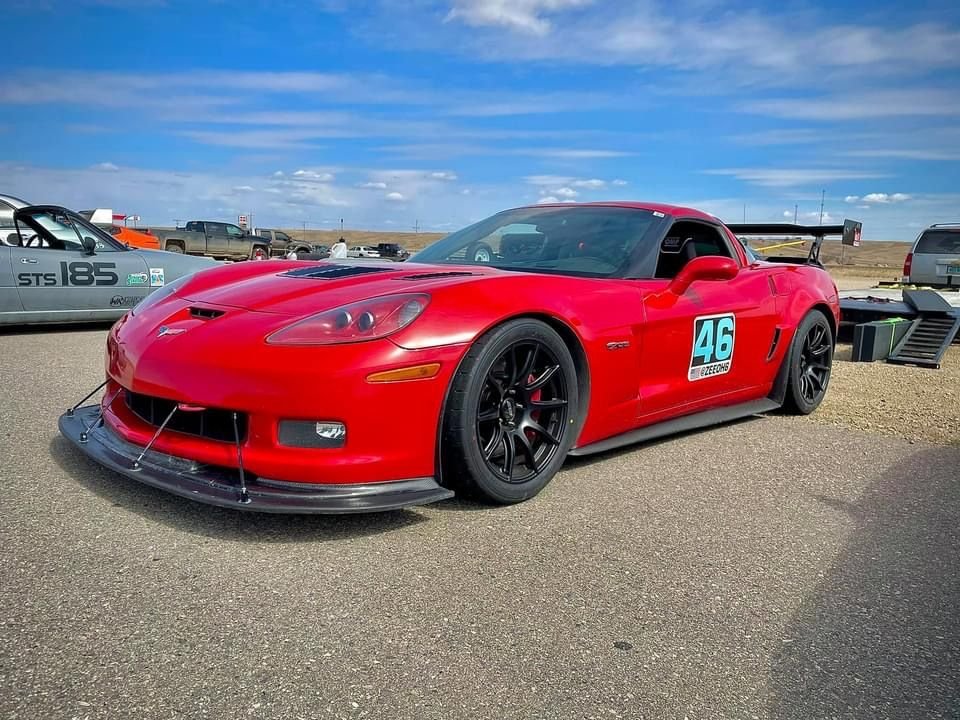

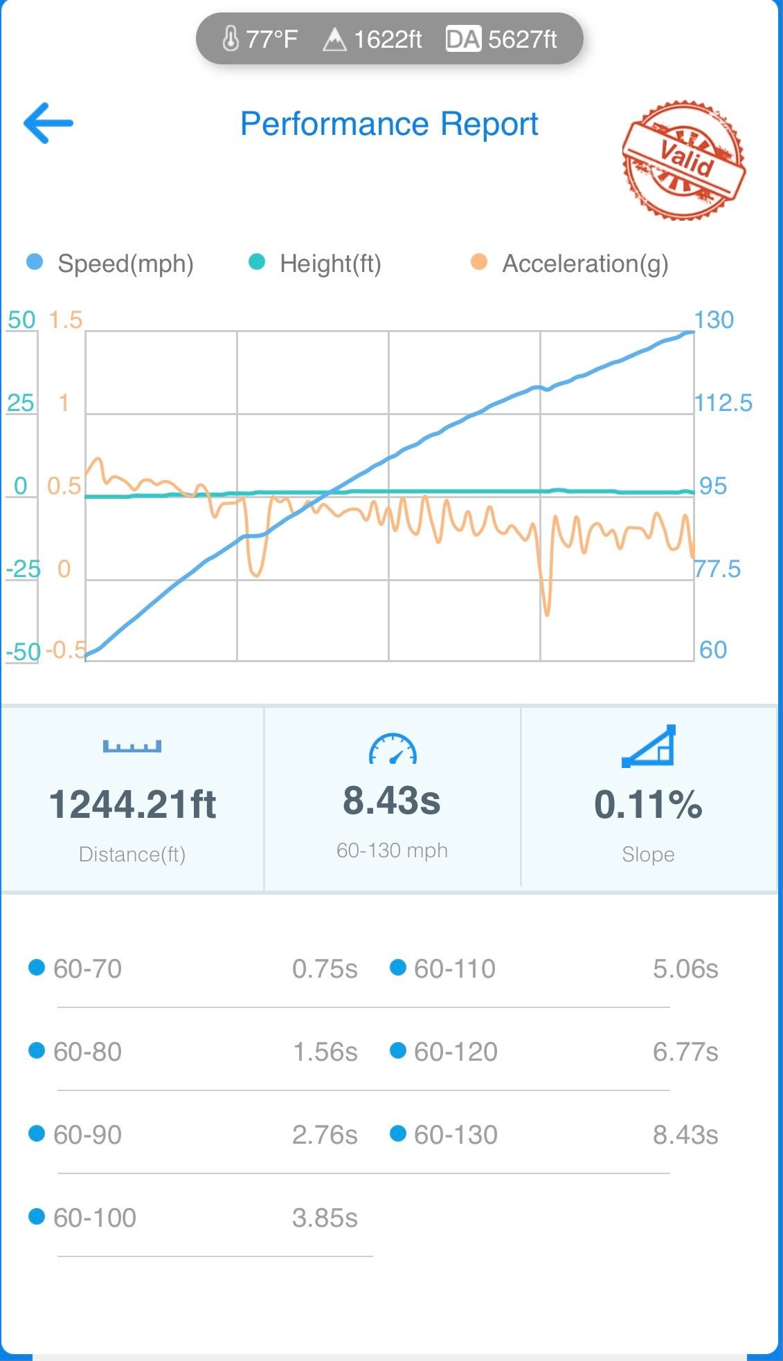

540/510, 315’s all around, splitter. Aero has a huge effect.
GTC-500 wing at 15*
Wing removed, way worse DA

I've done it a few different ways. Mostly I'll start at like 45 and hit it in 2nd. It is fairly humid here in the summer. As far as aero its just a stock c6z with a ZR1 rear spoiler

Also just looking at the data
81 degrees outside temp
1047 ft elevation
DA 2894 ft
I'm going to try it on a cooler time of day and maybe go out with the thought of going for a time vs trying to do it on a random cruise when the car is already pretty hot.
Thanks for the heads up guys. Looks like I got some things I can do!

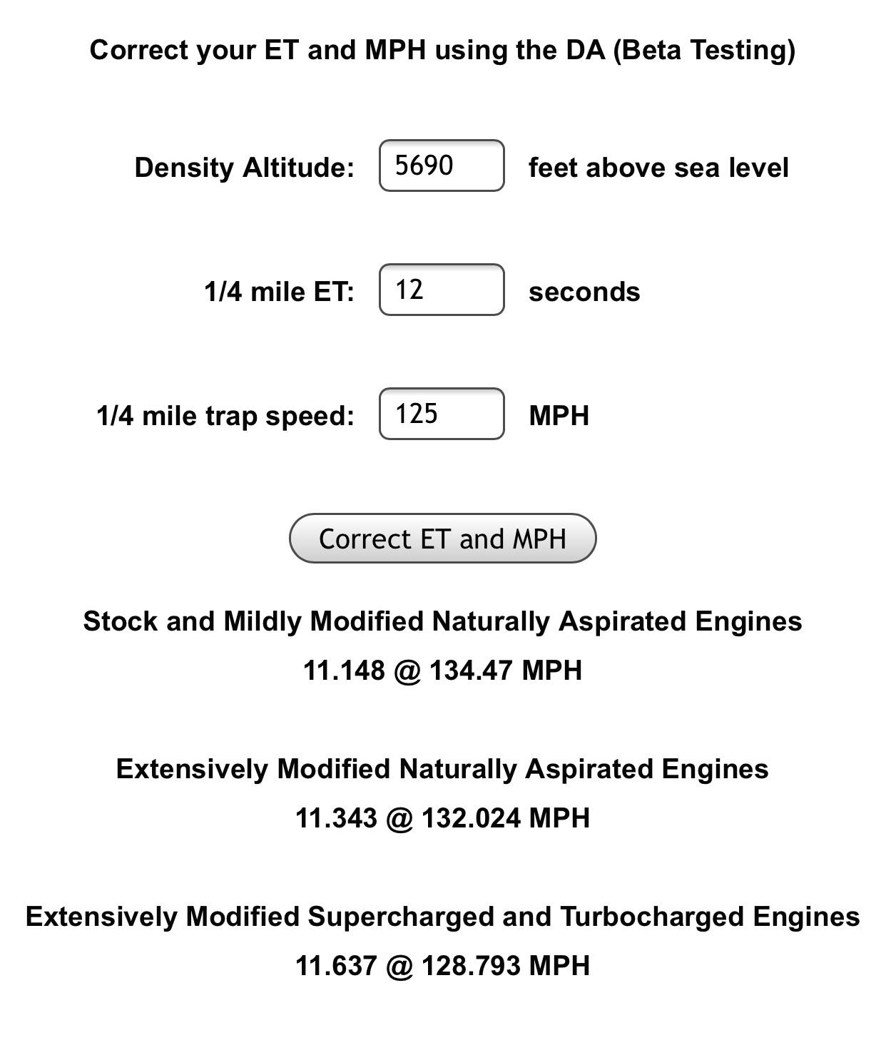

Elevation is a big factor. It’s all about density altitude. A pull on a 2 degree slope at sea level is faster than a pull on a 0 degree slope at 5000 ft DA.
It’s roughly a 3% loss for every 1000 feet above sea level with a naturally aspirated engine. You’re down around 9% power compared to what it would make at 0 DA.
Here’s an example

Thats good info. My DA is 1968, so I don't think its that big of a factor. I could be wrong though.
I think I discovered my main issue though. I'm an idiot lol. I turned off traction control but not active handling. Just today, same stretch, I turned it all off and got a 7.51 which I feel is more in line with where I should be. Not sure on my RS though because traction control was already turned off and I was still a second slow there too.

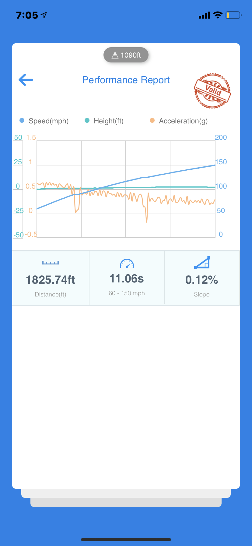

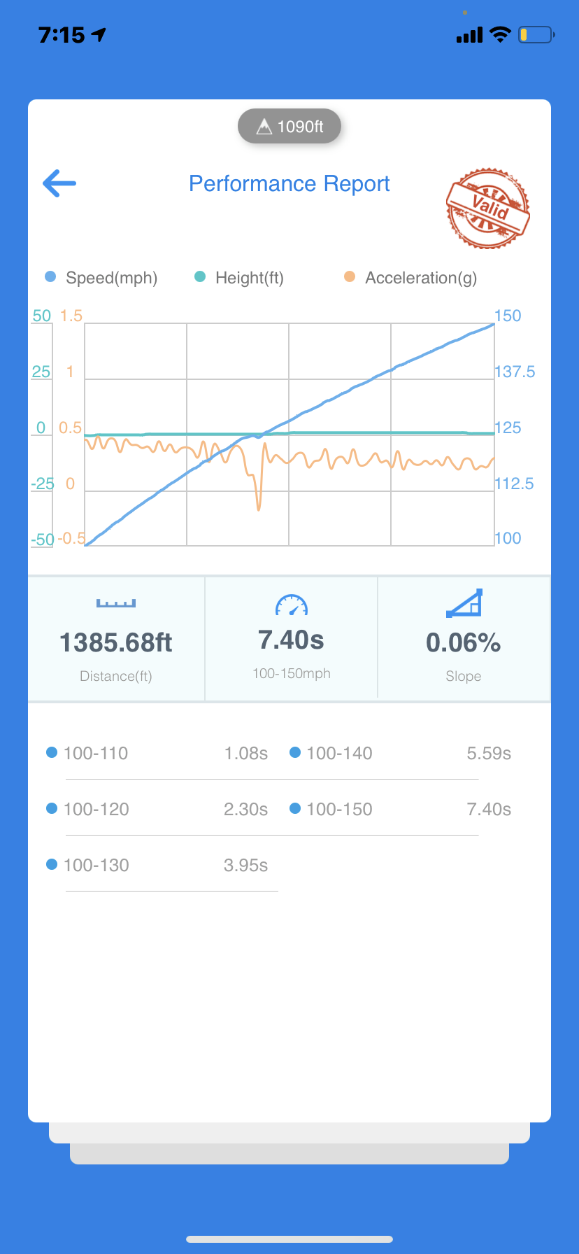

So when you get bored with the 60-130 you can set custom mph ranges - for the dragy to record.
One of my favorites is 60-150, so I set that up.
I also set up a 100-150 separately from the standard 60-130 so that I can see all the incremental times from 60 to 150 on the same pull.
