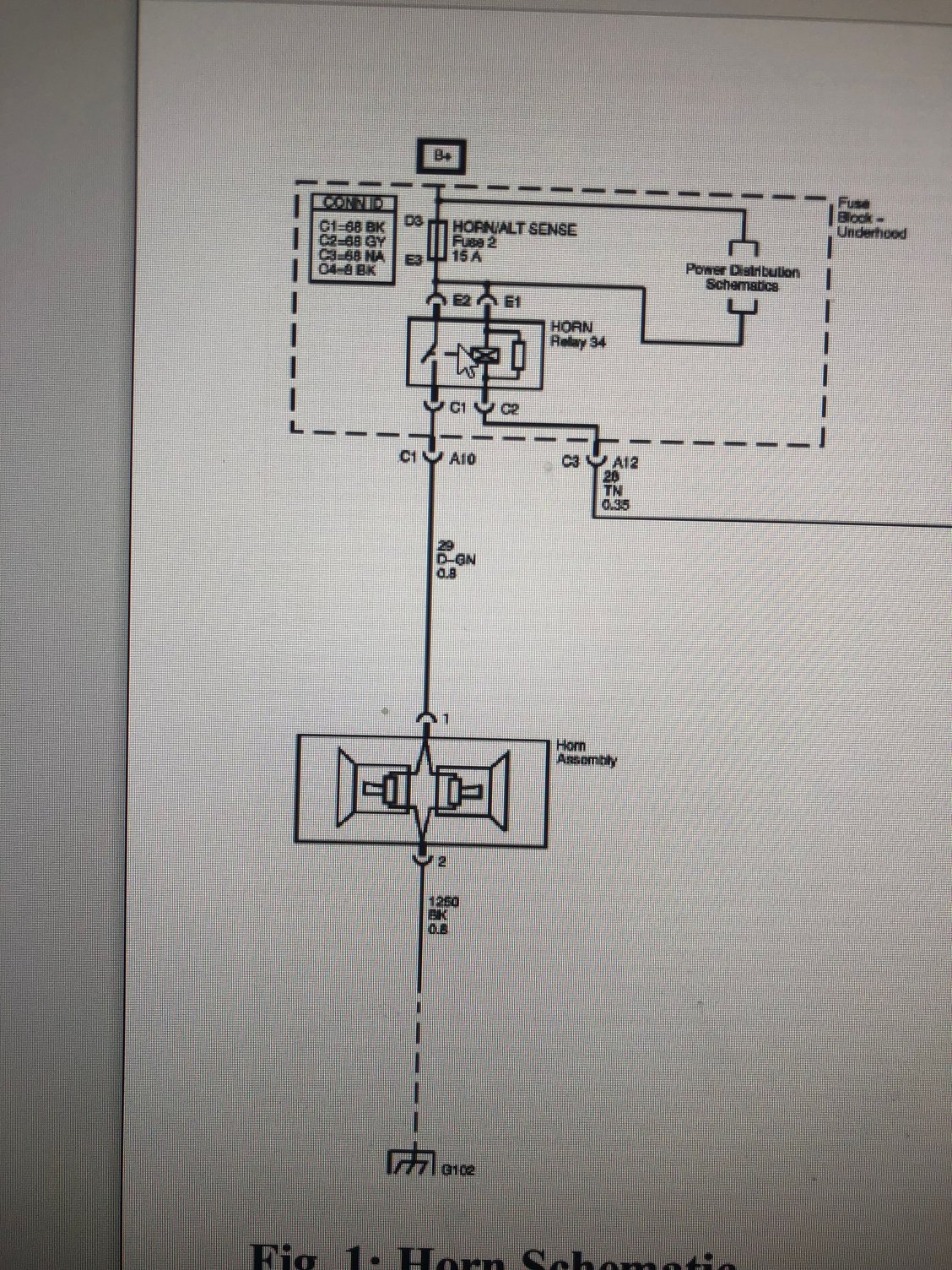

I believe your 07 has a “panic button” on the key FOB…does the horn sound when you push the button ??…if it does you’ve taken away the “load side” of the relay as being inop…first check Fuse 2 HORN/ALT SENSE…another way you can check is to swap the horn relay #34 with another 4 bladed relay or jump pins 87 and 30 on the relay itself..this basically hot wires the horn…the bottom of the relay has the numbers on them…87 and 30 are caddy corner from one another…if you jumper those 2 pins and the horn doesn’t work you should check the ground assuming you have power at pin 87…ground is G102…if that ground is good the horn is bad…also if you have a test light you should have power on 2 of the relay terminals..they are “hot at all times” !!…the last horn I diagnosed for a Forum member the horn was inop.

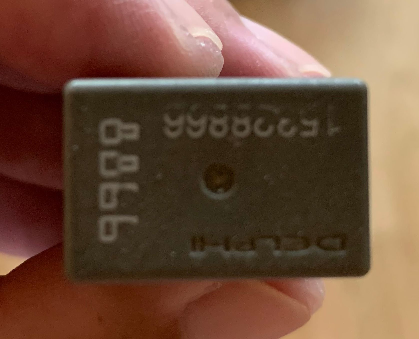

I can’t tell the part number by the old one I pulled out.

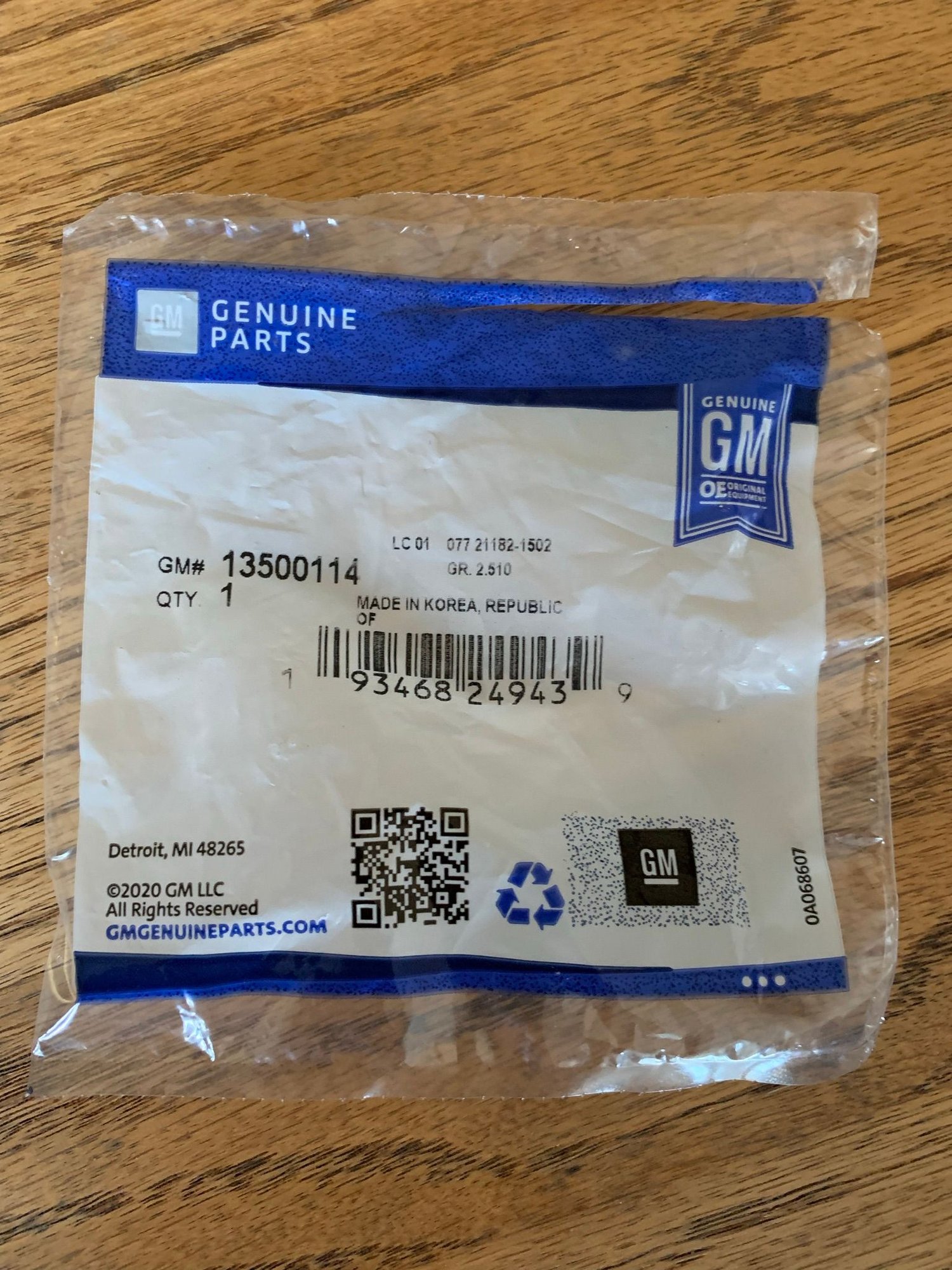

I am guessing it is 13500114 which is the same as 8866

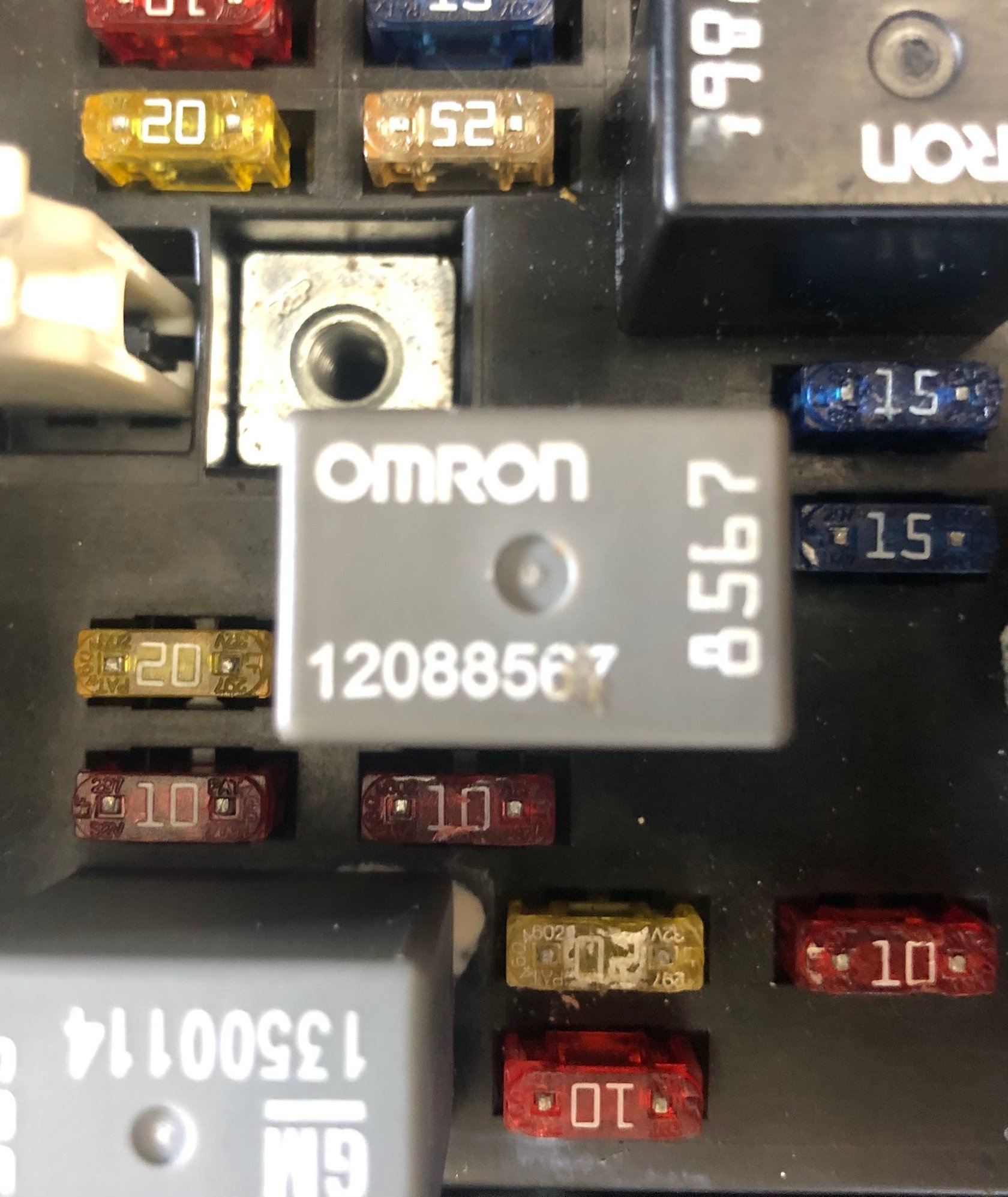

OK, if you want to replace the relay it can still be the horn, wiring, or horn membrane…this is the relay for my C5 but they should be the same.

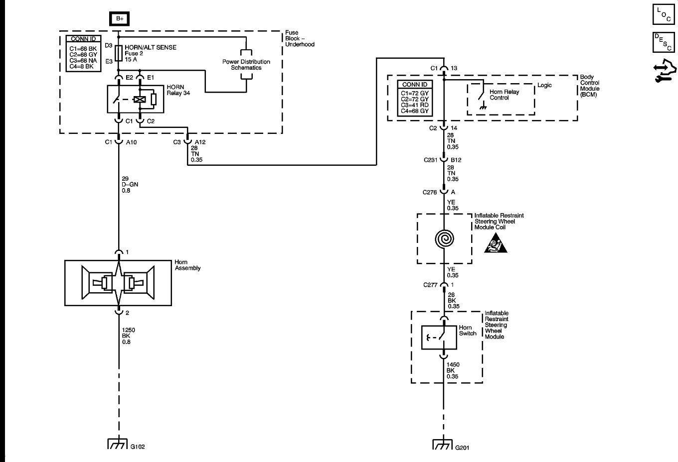

Remove the relay and check for 12vdc at pins E1 and E2. If you have voltage, jump E1 to C1. If the horn honks, that part of the circuit is good. Get a multimeter and check C2 to ground. Should be open until you press the horn button then it should show continuity. If one or the other fails, that's the part you should trouble shoot. If both work the way I described, replace the relay.

Thank you to all who gave me valuable tips to fix my horn. It was simply the micro-relay that needed replacement. Instead of paying $41 from the dealer I got if from the
AC Delco store on Amazon for $11. Arrived the next day! Works fine!
