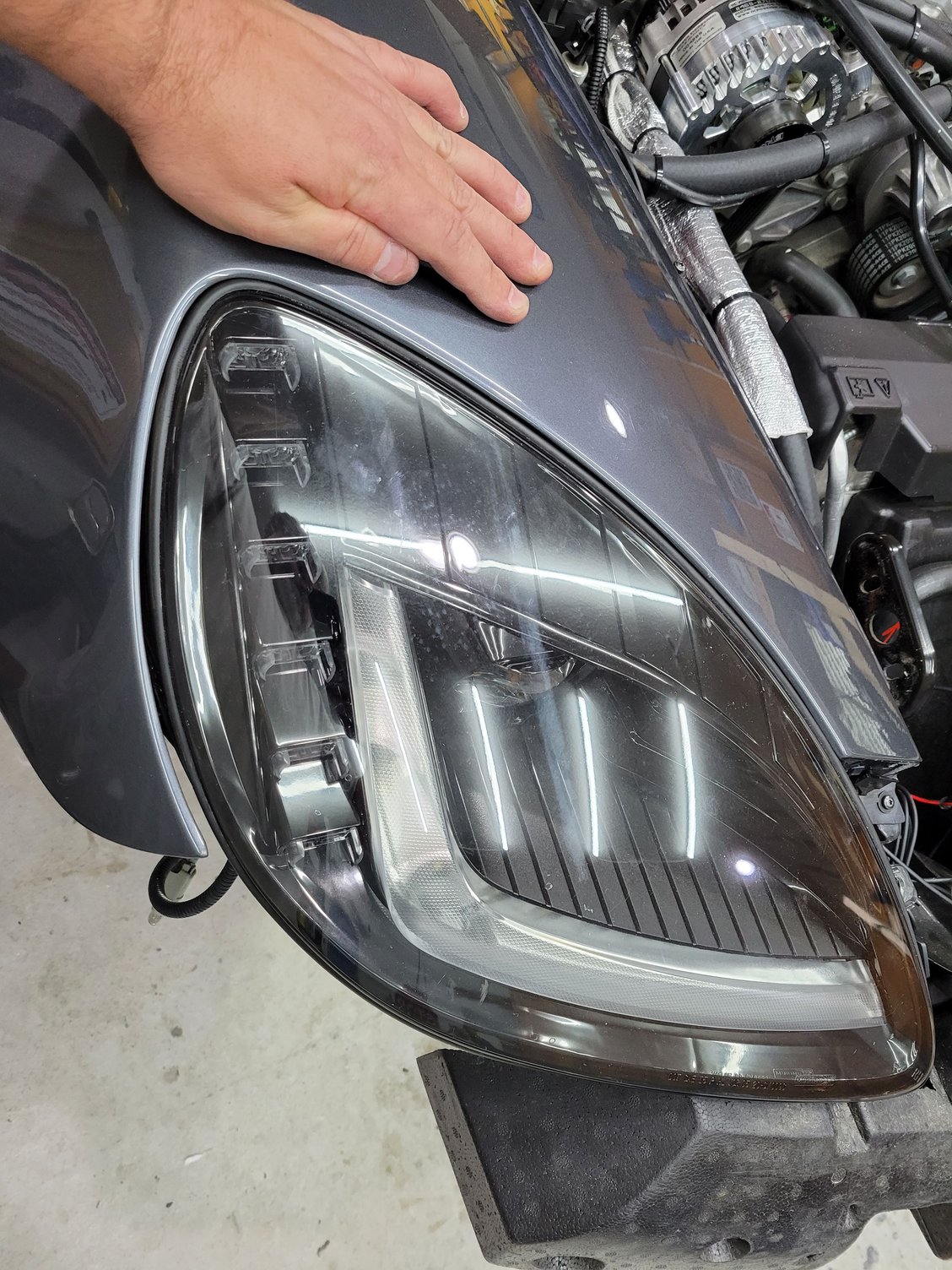

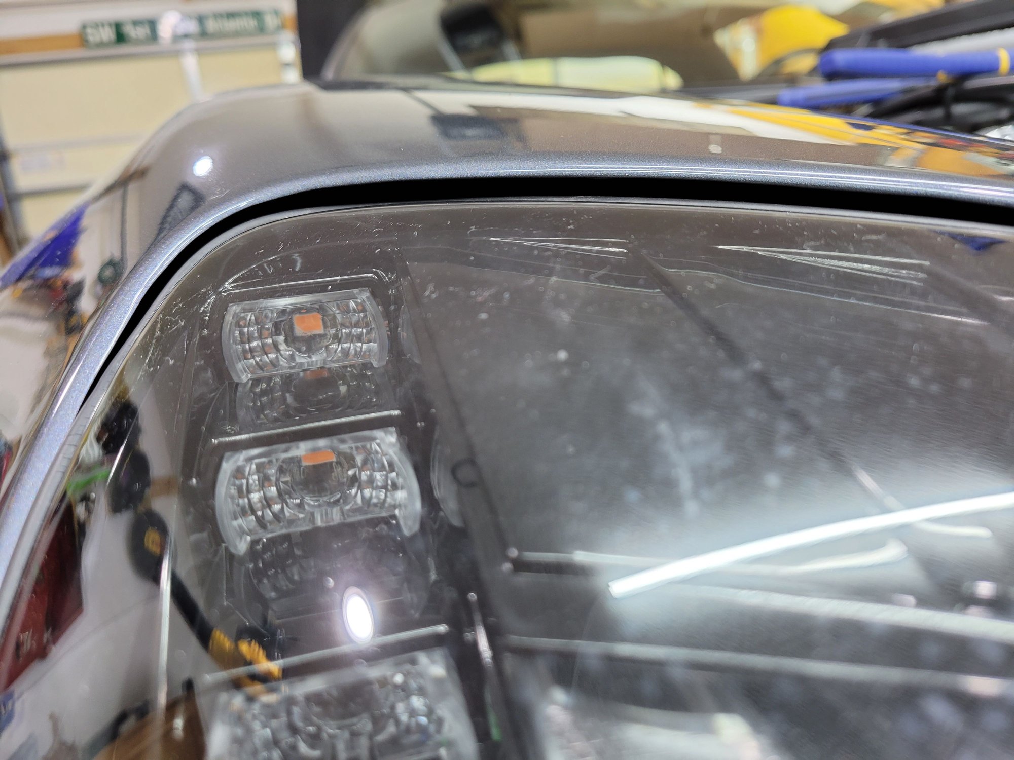

you may need to add washers to the studs to bring the enclosure up to the body work....
I can't stop staring at the gap on mine

Mine has a gap in them also, mostly on the driver side, I added washers to mine and it did bring it up a little more.

I saw a video where they used the factory studs instead of the ones supplied by Morimoto and it eliminated the big gaps.
