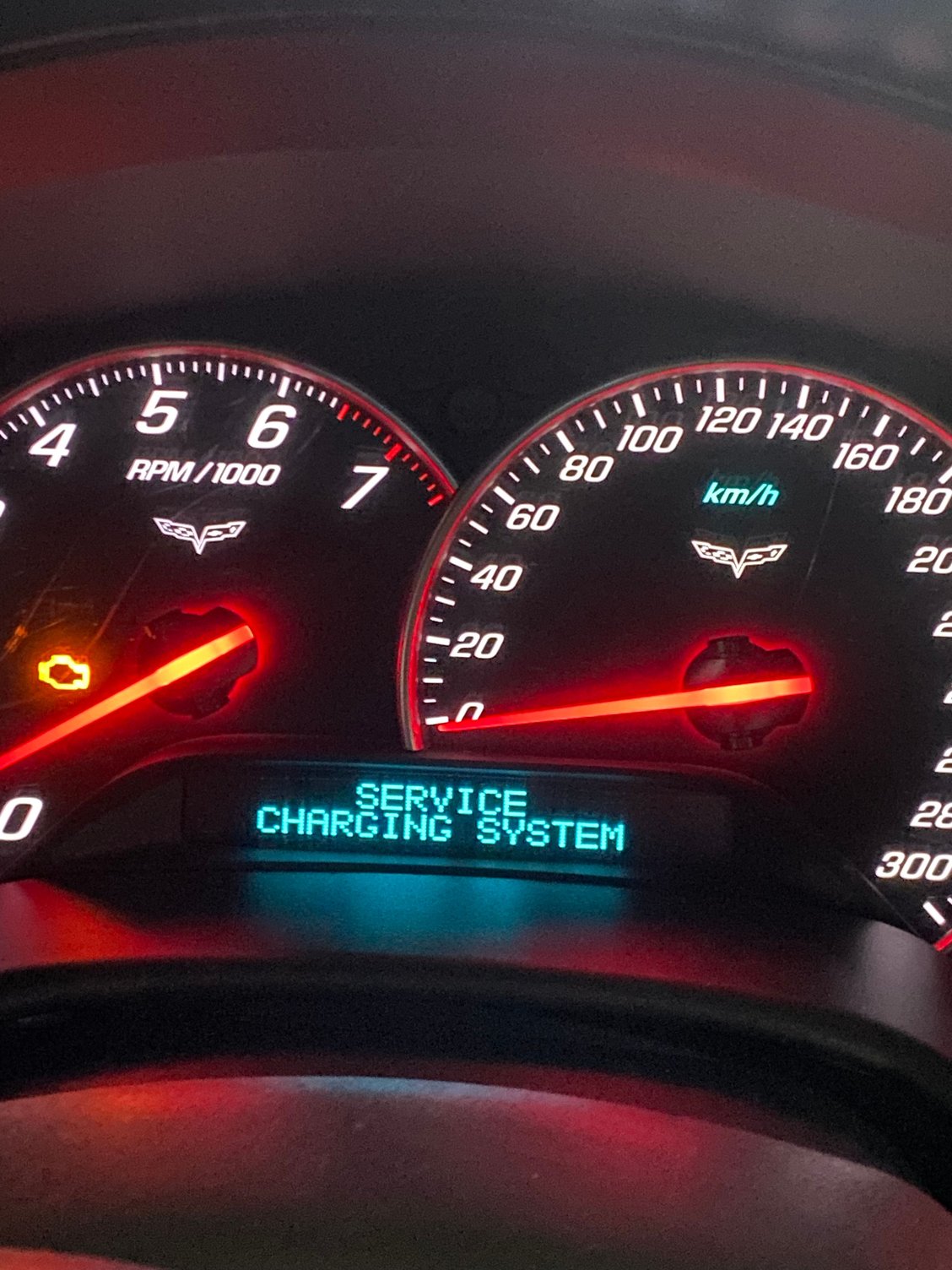

Unfortunately, my alternator was whining and by the end of the night the “service charging system” showed on my dash. Any recommendations for a new alternator? I looked up on summit racing and found ACDelco Alternator 19134486 145 amps but it’s remanufactured. The other option is ACDelco Alternator 25888970 but only 100 amps, which I think is the oem for my 2007 C6 Corvette LS2 mileage is 21500+ kms or 13,000+ miles…. Planning to sell it. I’m based in the PH.

BTW ... I just replaced the alternator in my 2011 GS with a new ACDelco P/N 25888970. Cost was $344 to the door here in the US. Wish I could help you with your problem.
