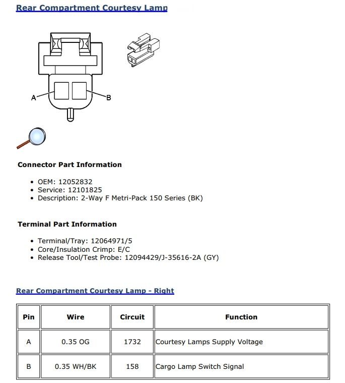

Hey all. I'm trying to wire in some better lights for my '05, and was wondering if anyone has any part numbers for the connectors in the cargo area. I am thinking about creating a split harness to add in a few LED strips into the trunk, and can't seem to find any diagrams of the harness in there. Has anyone ever come across this, or happen to know what the part numbers are for the connectors to the bulb sockets?

The OEM part #
Right & Left rear compartment lamp connector -12052832
Description of connector
2 way F Metric-Pack 150 Series BK
Here is a shematic pic of the connectors
