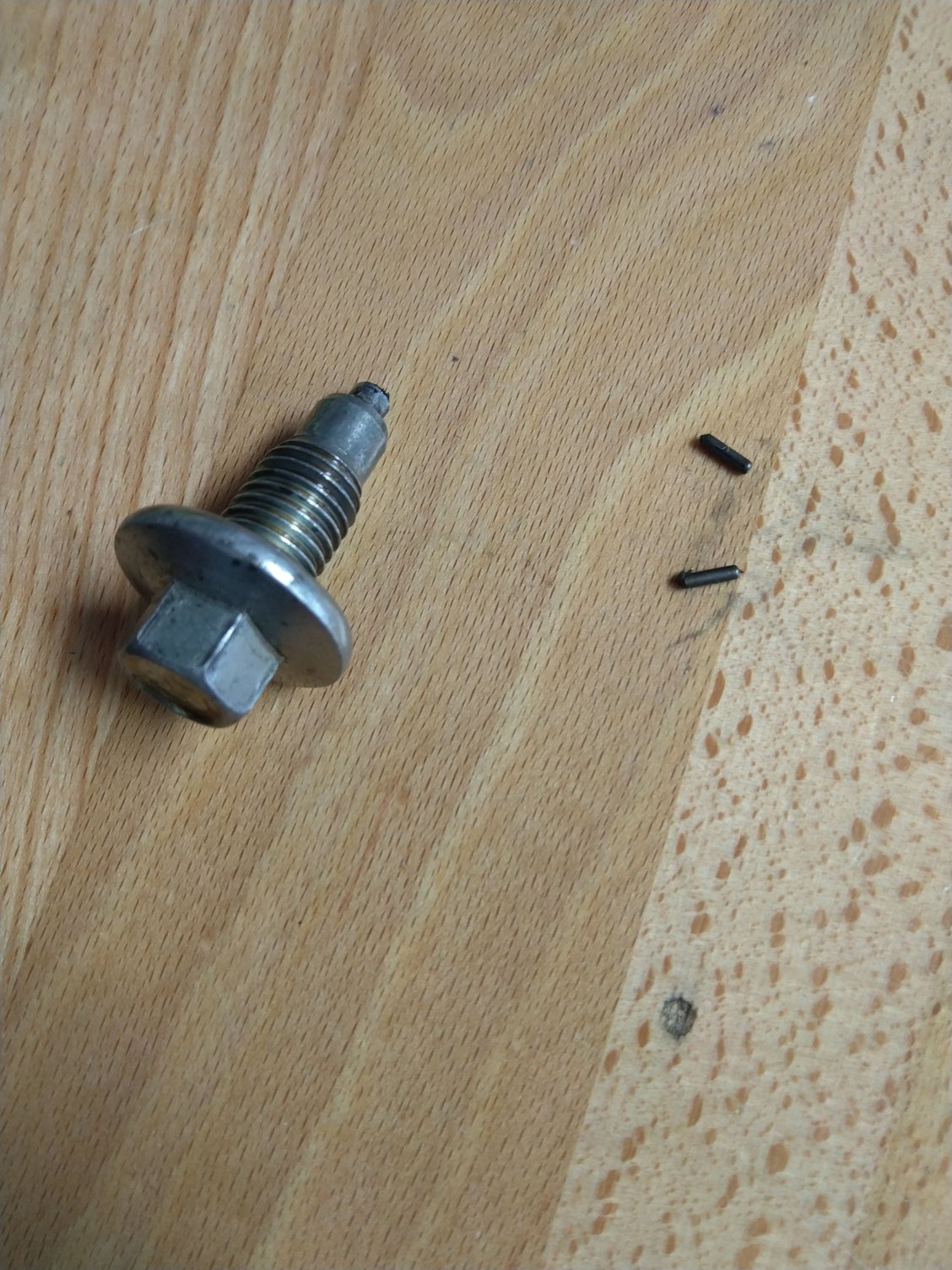

So when I had my BTR Stage 1 cam installed about the only thing that wasn't replaced were the rocker arms. I'm going just take a stab at this and say these are the needle bearings from one of my old rocker arms, correct? Does anyone have the part number for stock rockers for my 2008 LS3? I'm thinking they need replacing. The car runs fine, just a little choppy.

Get aftermarket trunnions put into yours. CHE is a good choice.

No. I would replace all the needle bearings with CHE bushings. You push the needle bearings out of the stock rocker arms and press the CHE bronze bushings back into the original stock rocker arms.
I had access to an arbor press which made the job simple.
I would be more worried about how many other loose needle bearing parts are running through your engine.
I suppose you could count all the needle bearing rods to determine if any are missing.
Most likely only one needle bearing failed.
