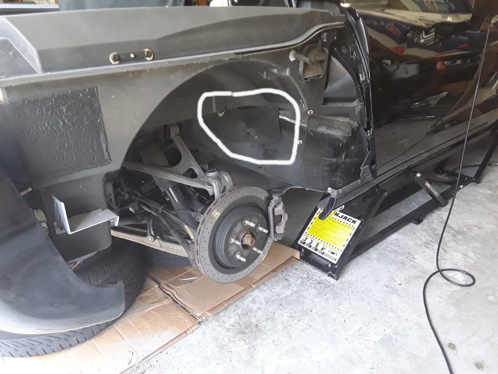

P0449 indicates there is blockage in the vent solenoid and/or corresponding hose. The vent solenoid allows fresh air to be pulled into the EVAP canister. If you still have the old solenoid, you can test to see if it is open by blowing through where the hose connects to it. If you can blow through it, it is open and okay. From the solenoid, the hose goes a short distance to the EVAP canister. You can access the EVAP canister through the right rear wheel well by removing the tire and the inner liner. There is a small rubber cover over the access opening, circled in photo below. Disconnect the large rubber hose from the EVAP canister and blow air through it, you should hear air escaping through the vent solenoid, if not you've found the blockage.

Today I have checked the new valve and blow in it and put 12 volts on the terminals, everything is ok. Also I have remove the right rear wheel well and blow in the hose of the EVAP canister too, Everything looks ok althought I still have the P0449 code.
