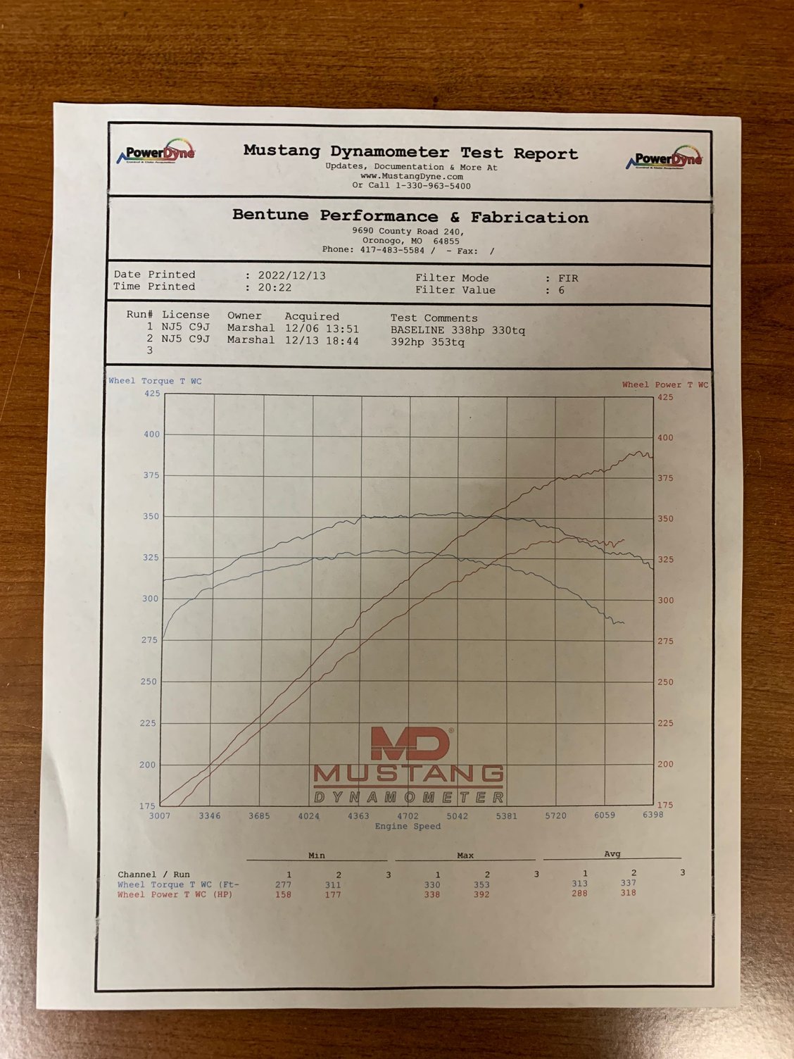

After the stage 1 cam, headers and tune I gained 54 hp and 24 lb-ft on a conservative dyno. Pic shows the base pull and final pull.

My vision isn't the best and that shot of your dyno graph isn't either . So, what did it make? Even bigger question is....how do you like it?
Base pull was 338 hp 330 lb-ft
Now it’s 392 hp 353 lb-ft.
Sounds really good and runs so much better than before. If you look at the graph, he’s running the smoothing filter at 6 out of 100 to show the true curves. When he turned the filter to 60 it was smooth as can be. I really like it.
