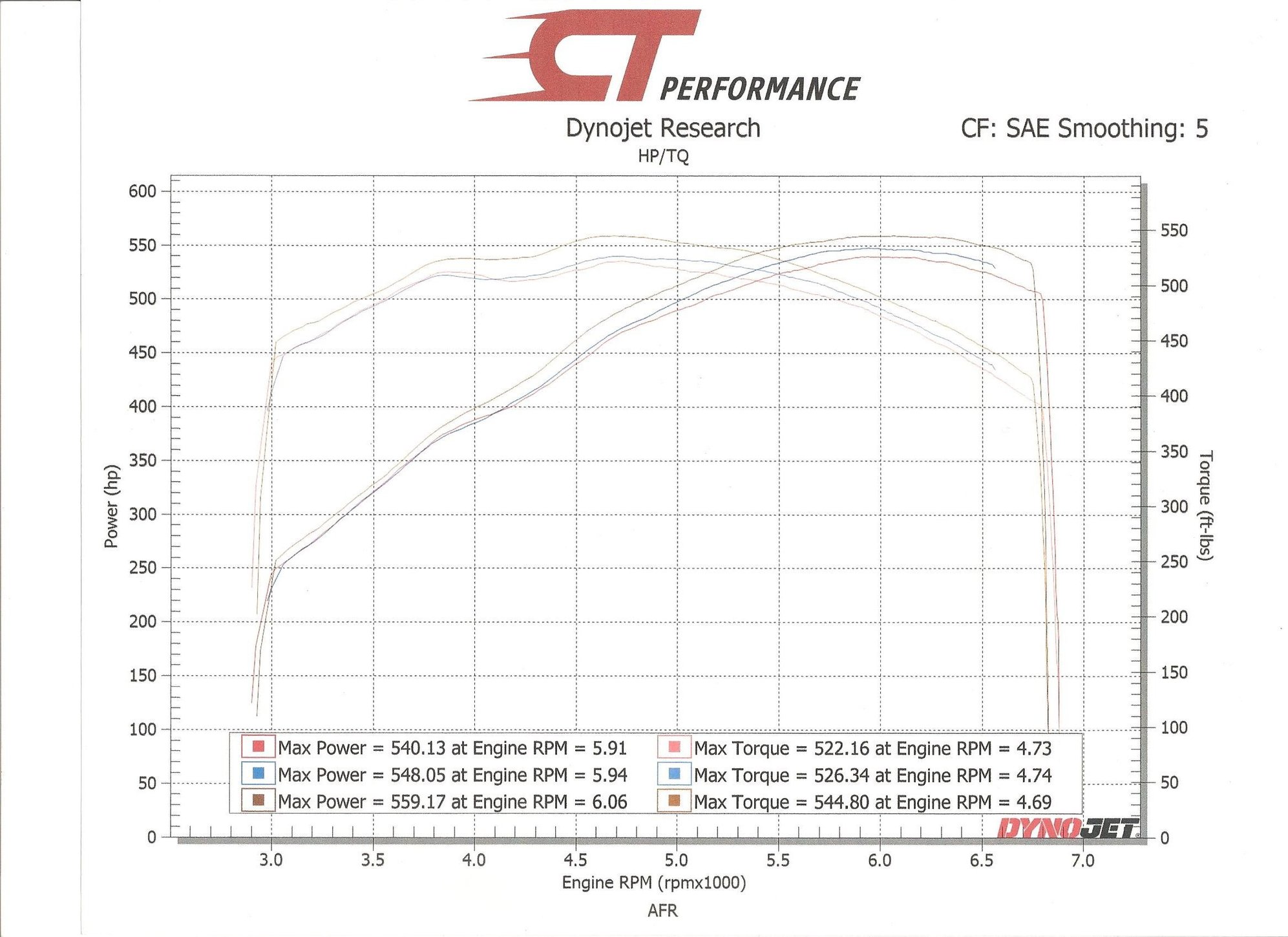

Dyno results from last round of mods on my 2011 Z06:
- RED = baseline, pump 93 octane
- BLUE = changed intake, pump 93 octane
- BROWN = changed intake, pump E85
Car has Halltech CAI, Mamo MSD intake, fixed stock heads, 60# injectors, BTR stage 2 cam, Kooks LT headers and Corsa exhaust. E85 gave +11whp and 18-19 tq over 93 octane.
