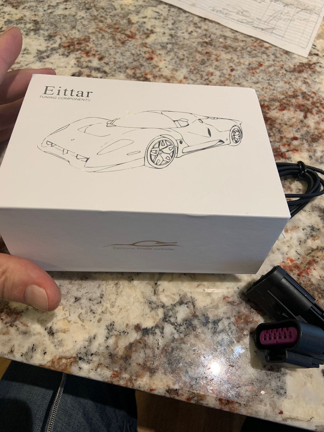

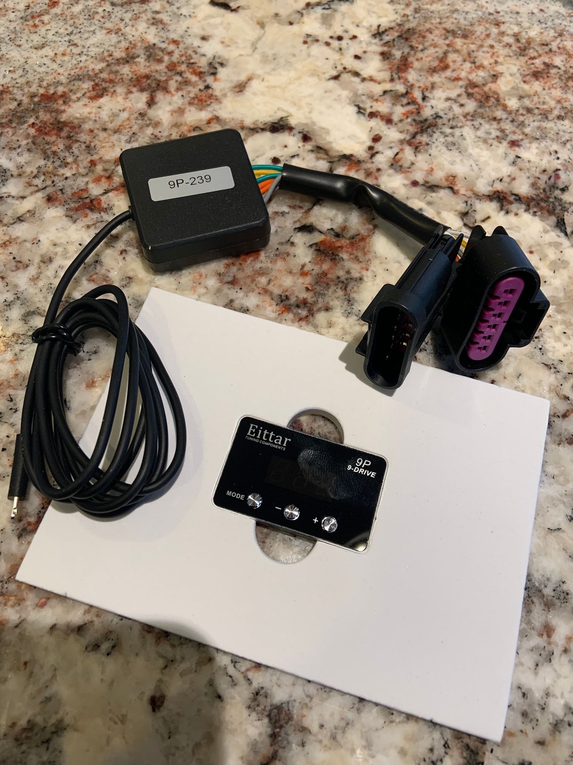

Okay, so got this controller off Amazon.
Throttle Response Controller.
Amazon Amazon
wanted to post up my thoughts
this is on my 2008 Z06.
I had the Pedal Commander brand on my 2008 base and it really really made that car much more enjoyable.
the packaging and fit and finish of this Chinese brand is top notch. The connectors are top notch, OEM quality. I can’t imagine the US sold versions are from a different source- my guess.
so it works perfectly. I started around P2-3 and it was too much and actually raised the idle - I don’t recall my base C6 doing that. Maybe just difference between the two motors. Or could be this controller is just much more sensitive or settings provide differing levels of response.
I dialed it back to like P1-3,4 and idle is now normal and pedal response is awesome!
so for the price, id say go for it. Good thing about Amazon, easily returnable
