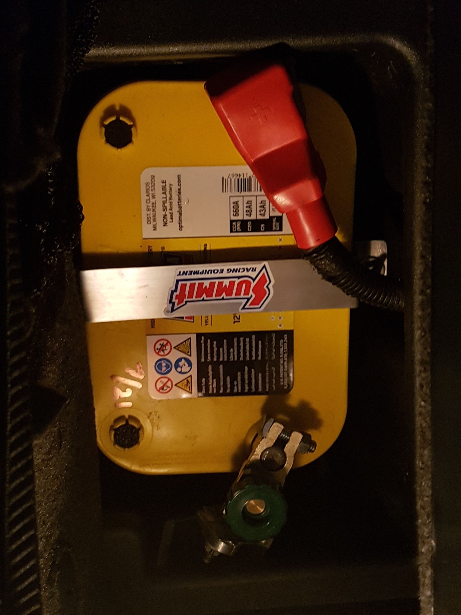

I used the Optima D35YT - it does fit the C6 Z06.
any modifications needed?
fits like a glove - you would not want to go any physically larger as you still have to miss the tie down uprights.
what side is your battery terminal at my positive is on the drive side can’t tell from your picture
standing at the back of the car looking forward, the positive is on the left and the negative is on the right.
