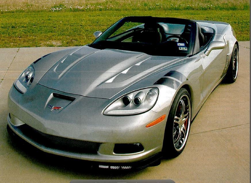

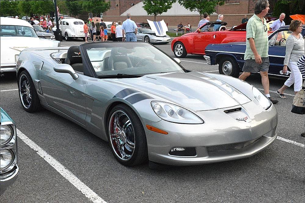

Gorgeous car! Did you start with a GS or a base? The GS is what I wanted but this 2007 C6 base, 2LT, came up with 10K miles and non-smoker for $21 Large. Felt I couldn't pass it up. Frankly, I don't need more power than the LS2 provides but I'd like better suspension. I used to road race a '74 Carrera RS and got used to good handling. The C6 base is a bit soft for me and just a hint tail-happy. I like some oversteer but the stock suspension seems to make it less predictable. But, I don't know **** as this is my first Corvette.
Beautiful machine,p
RD
