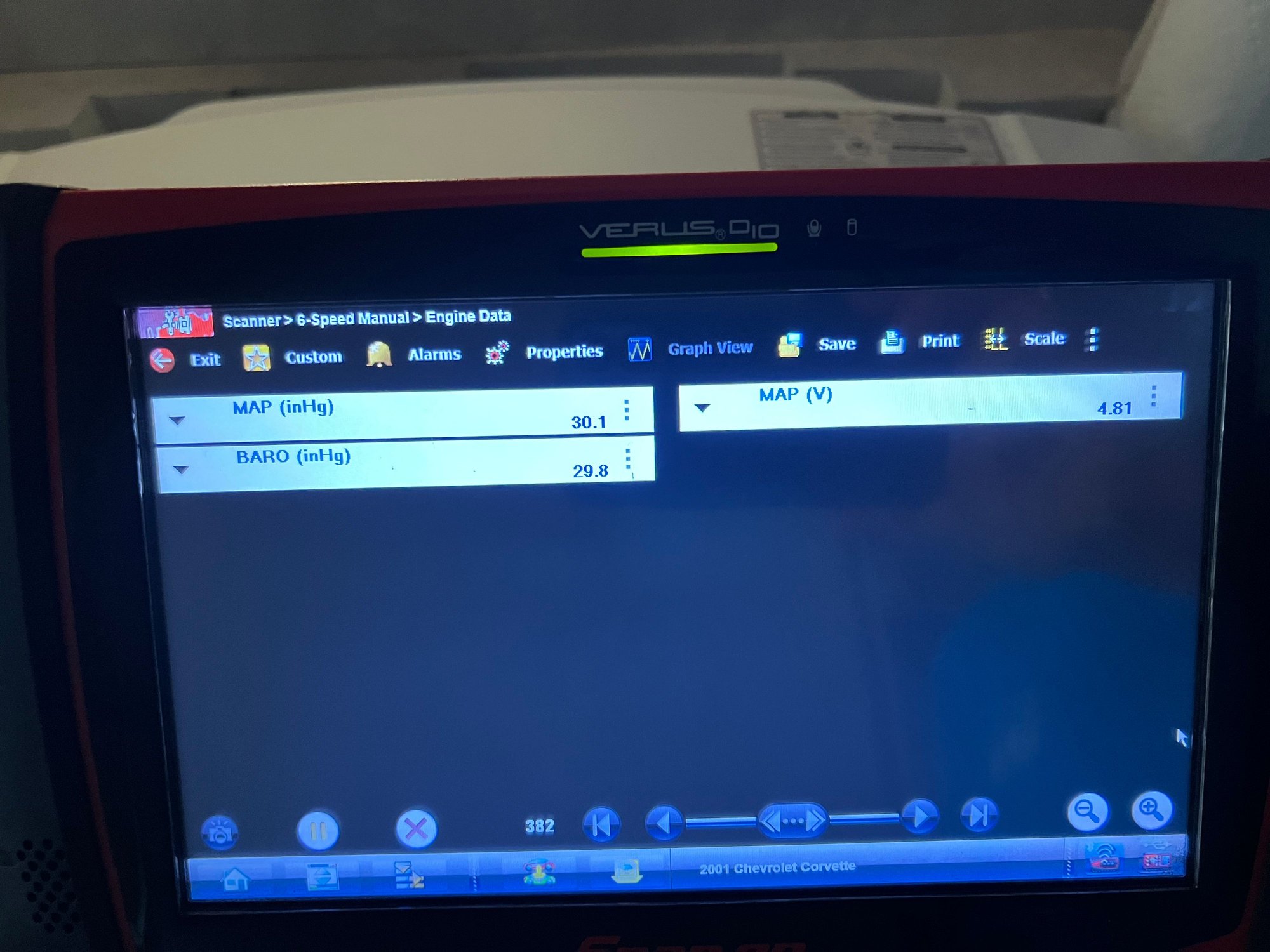

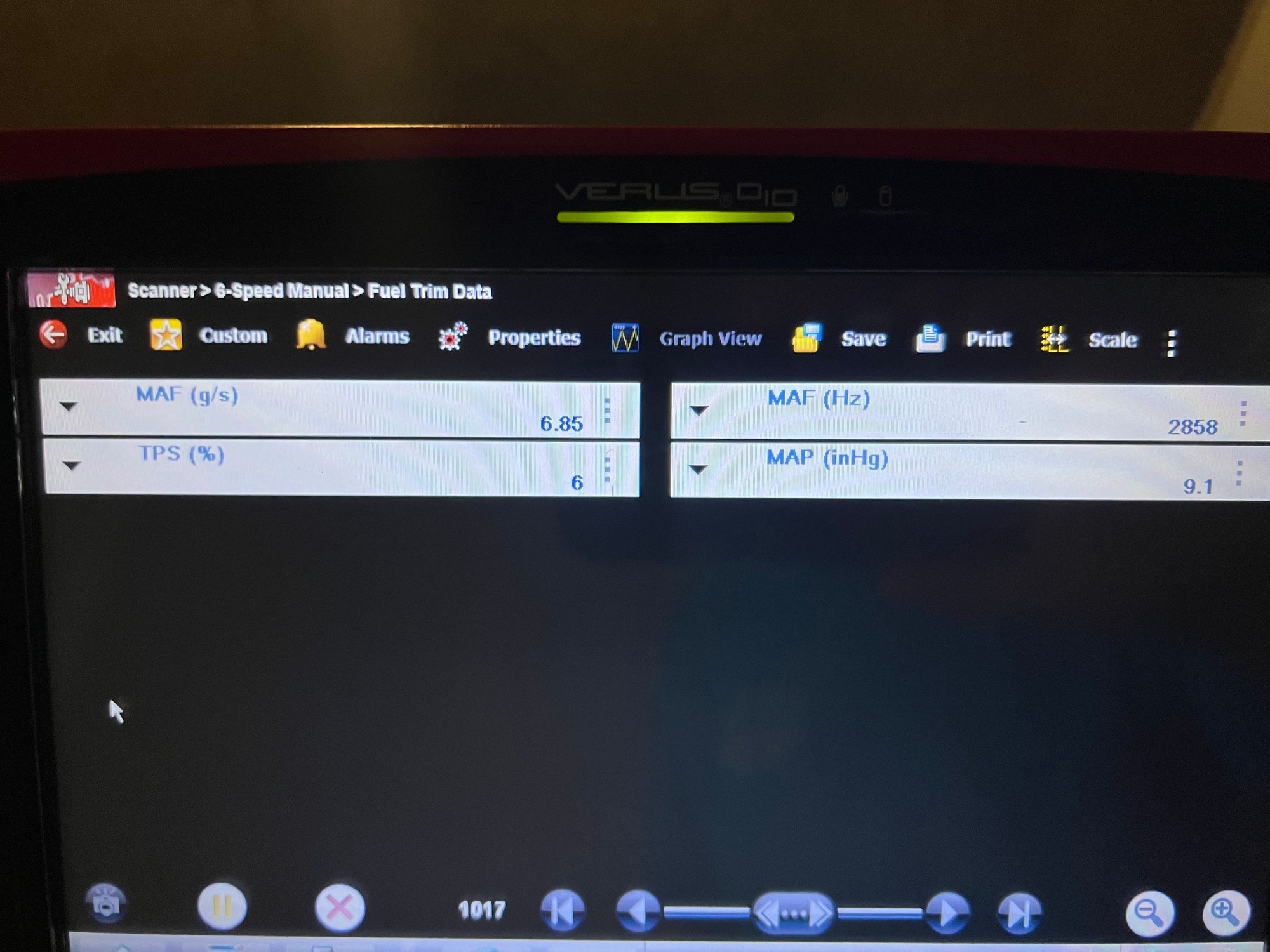

I’m assuming you have a scan tool so the first thing I check is BARO or MAP in inHg with engine off….a skewed MAP sensor can cause a P0101…with the engine fully warmed up your MAF in grams/second should roughly be the liter displacement of the engine…a dirty throttle body can also cause a P0101…if your scan tool shows TPS % it should be less than 10%…(see picture)…

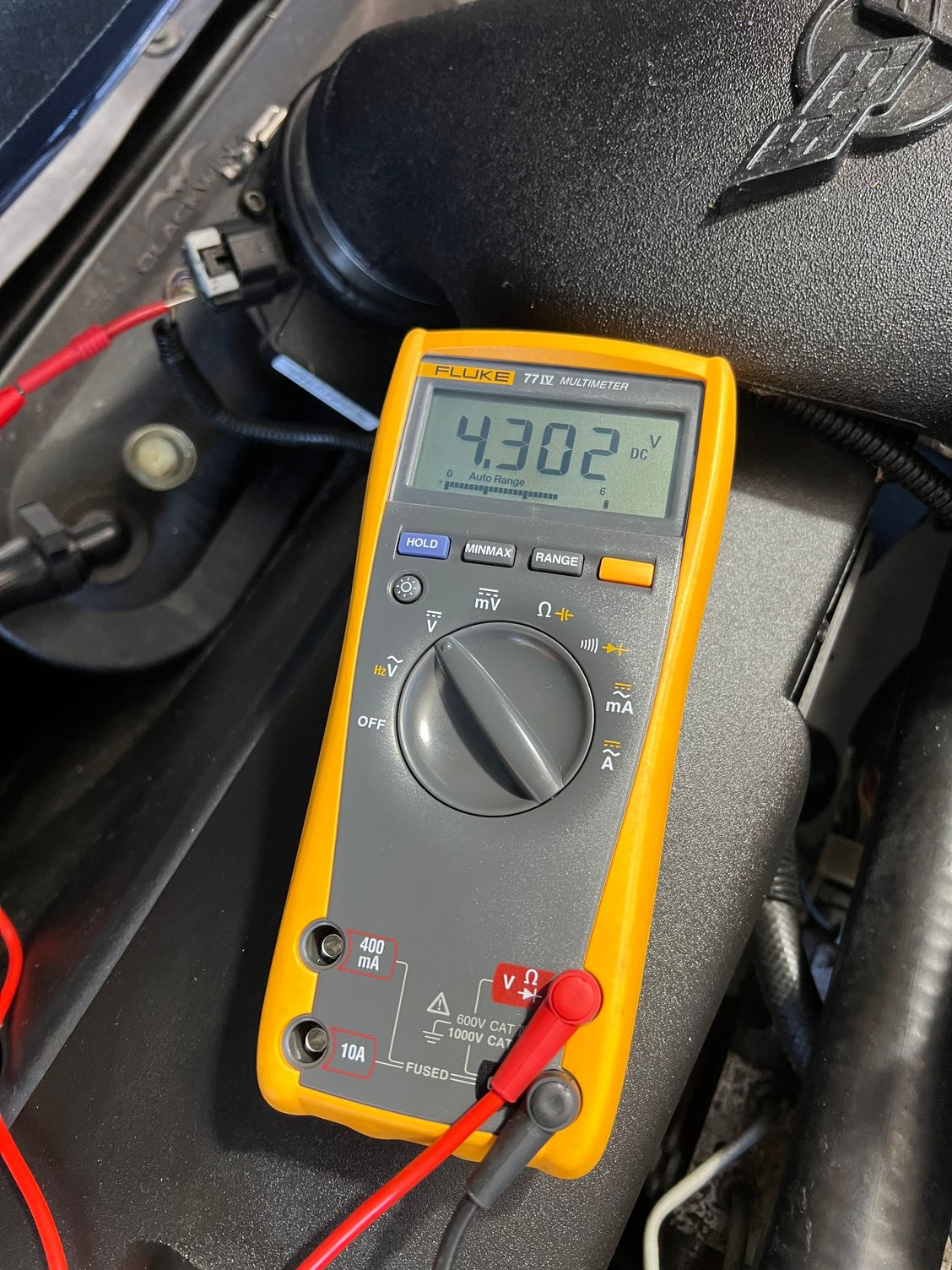

if you have a voltmeter remove the MAF connector….with ignition on you should have 5 volts on the yellow wire, 12 or system voltage on the pink and less than 100mv on ground…with engine running if you have a voltmeter you should see around 4.3 volts at idle…and make sure you have no vacuum leaks !!…what are your long and short term fuel trims at idle ??
