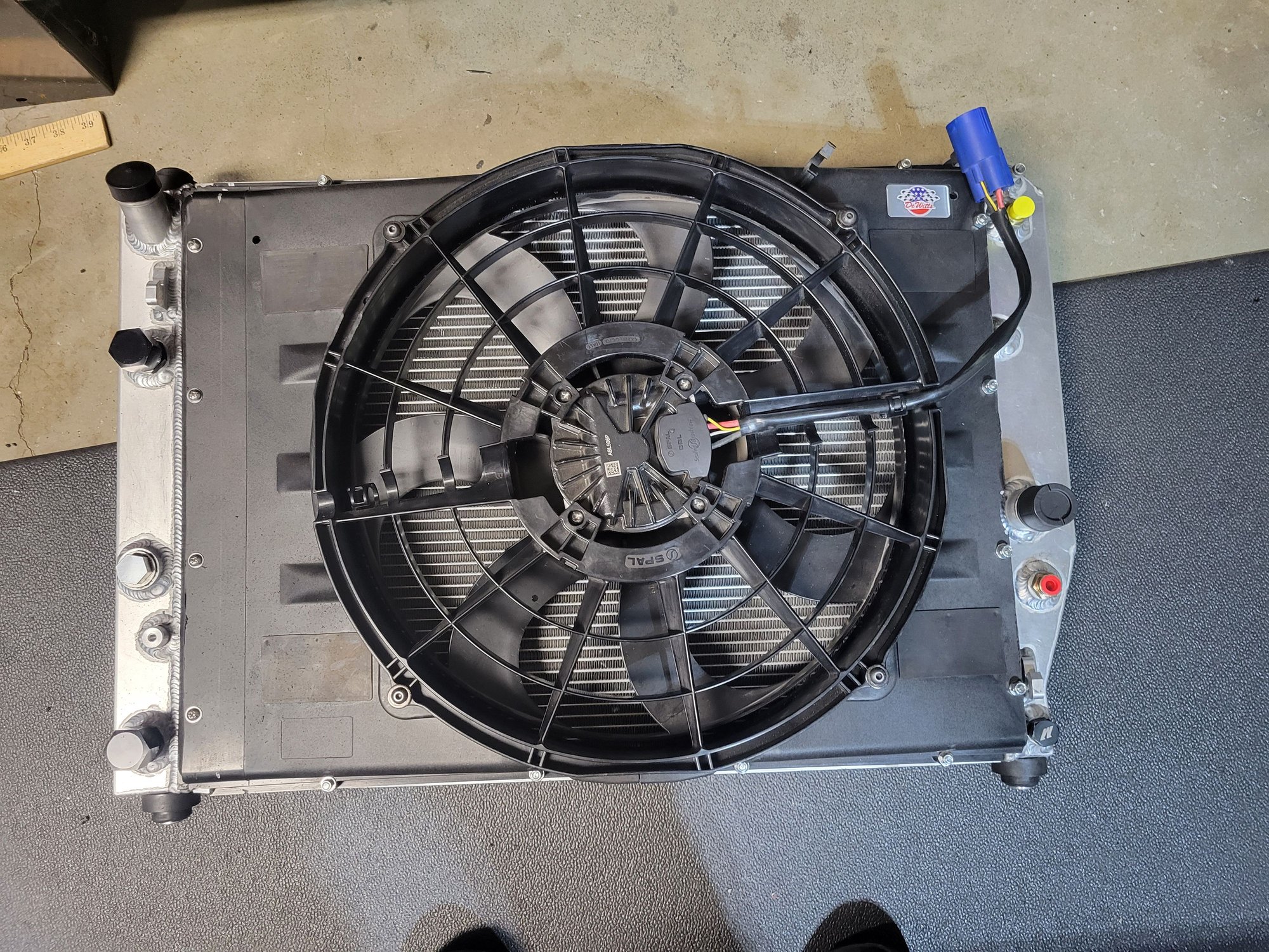

Originally Posted by DSOMC6
Dewitts is a work of art compared to oem.
Not cheap by any means when paired with the brushless fan. But resolved my cooling issues 100% on the FI car.

Originally Posted by PCMusicGuy
Is that fan and shroud also from Dewitts? Plug and play with OEM PWM controller?
Yeh it comes sealed together.
Here's the link for the fan/shroud and how it's wired-in.
https://dewitts.myshopify.com/produc...21235675201618

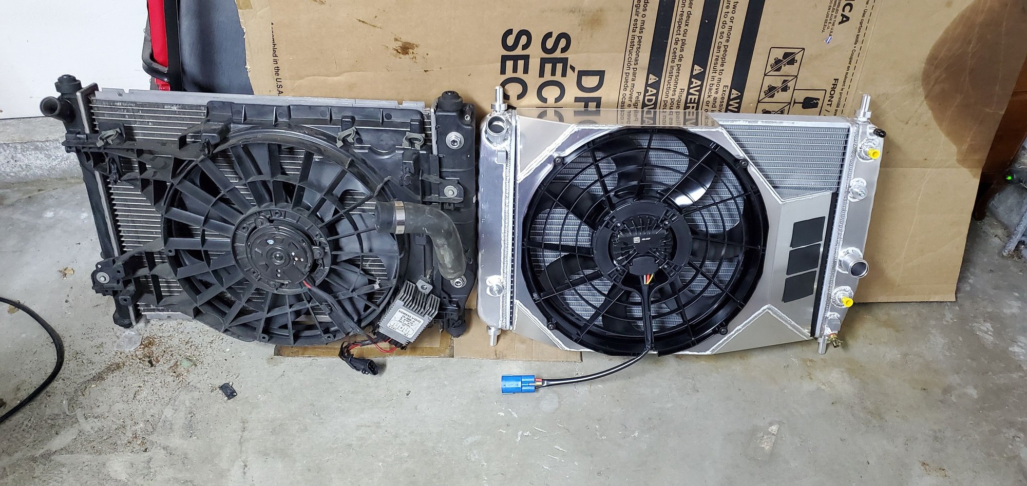

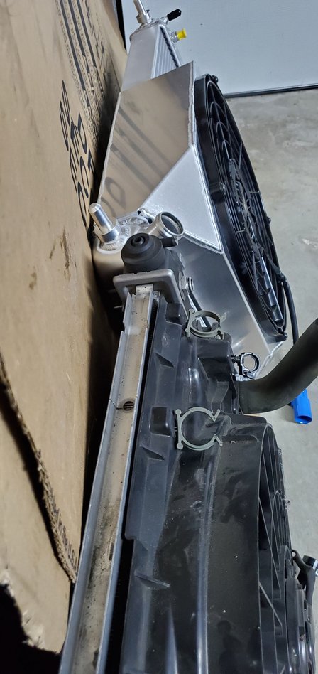

This would not be for a supercharger because of the height. I used a Mishimoto radiator and the Dewitts Brushless with their brushless composite shroud. Note the fan needs to be moved over to passenger side to miss the ABS box.
Wow! Absolutely Gorgeous.
