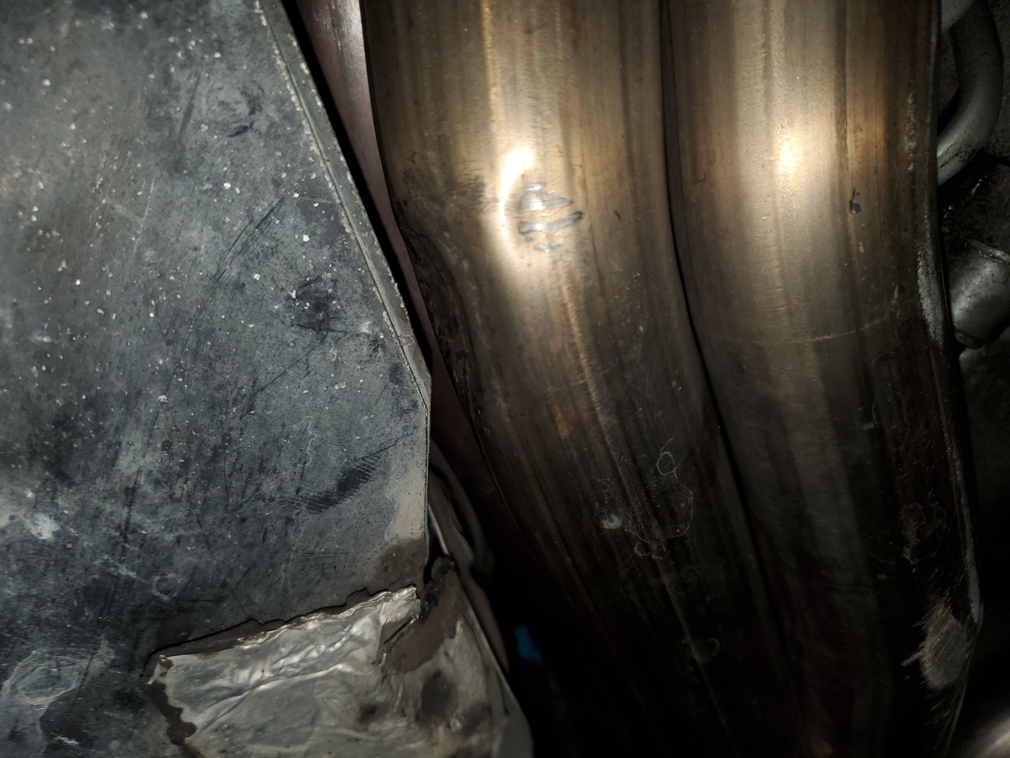

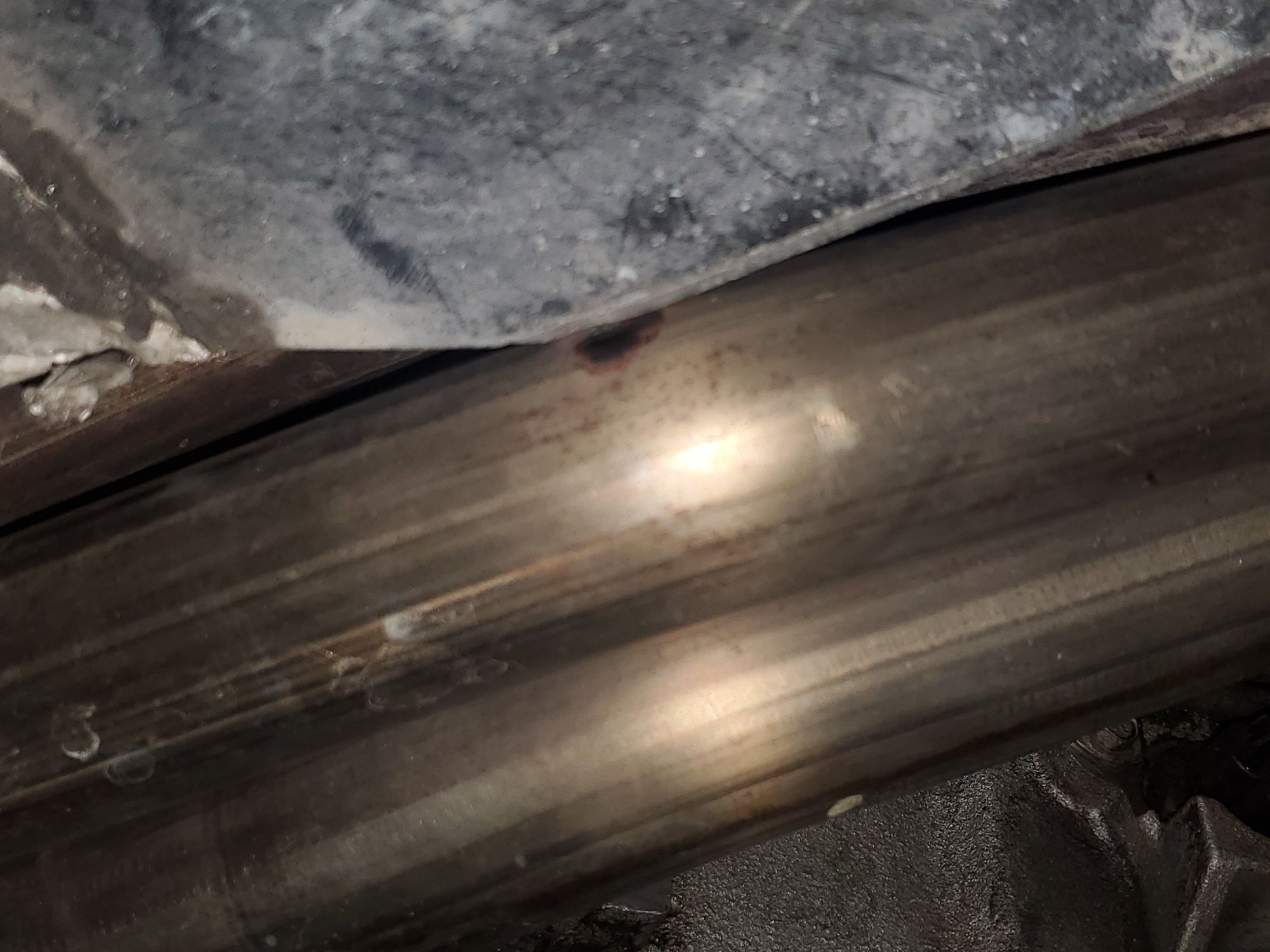

Has anyone had trouble with fitment on Texas speed longtube headers? Mine have started to rub on the passenger frame of my 2008 base. Time to get the hammer?

I had tried a set of Texas long tube headers on my C5 Z06 and they would rub on the frame no matter how much I tried to adjust them.
Best thing to do is remove them and buy a set of Kooks. Kooks will fit perfect every time.

​​​​​​​I've done a few on cars before and they always have that same issue. Vibration never goes away but I usually cut off a very small piece on car. It's about a 1/2" lip I believe. I shave it down so there's enough room and just end up spraying some paint on it to avoid rust. Never had an issue. Also the o2 sensors are kinda tight up there as well. Overall they sound great for the price and are built well just not a perfect fit.

Ouch that sucks. I would probably just dent them.

I bought American Racing Headers, and in the instructions, they say that you'll have to trim that area of the floor on the passenger side on some cars. It's not uncommon.

Dented the header. No more rattle!

They fit poorly, hang low, burn through O2 sensors, and have poor low end performance. Picked up a huge amount of torque switching to American Racing. TSP headers also sound different

And that is why I always recommend Kooks over ARH. I had ARH and I also had to hammer the pinch weld on the frame for them to fit. That is completely unacceptable for a supposedly premium header. I expect that sort of crap from headers off of eBay.
ARH says in their instruction that you may need to clearance the frame in that area. BS, they were just lazy and did not put in the time to design the headers properly.
Kooks fit and no BS in the instructions on having to hammer on your car to make them fit.
