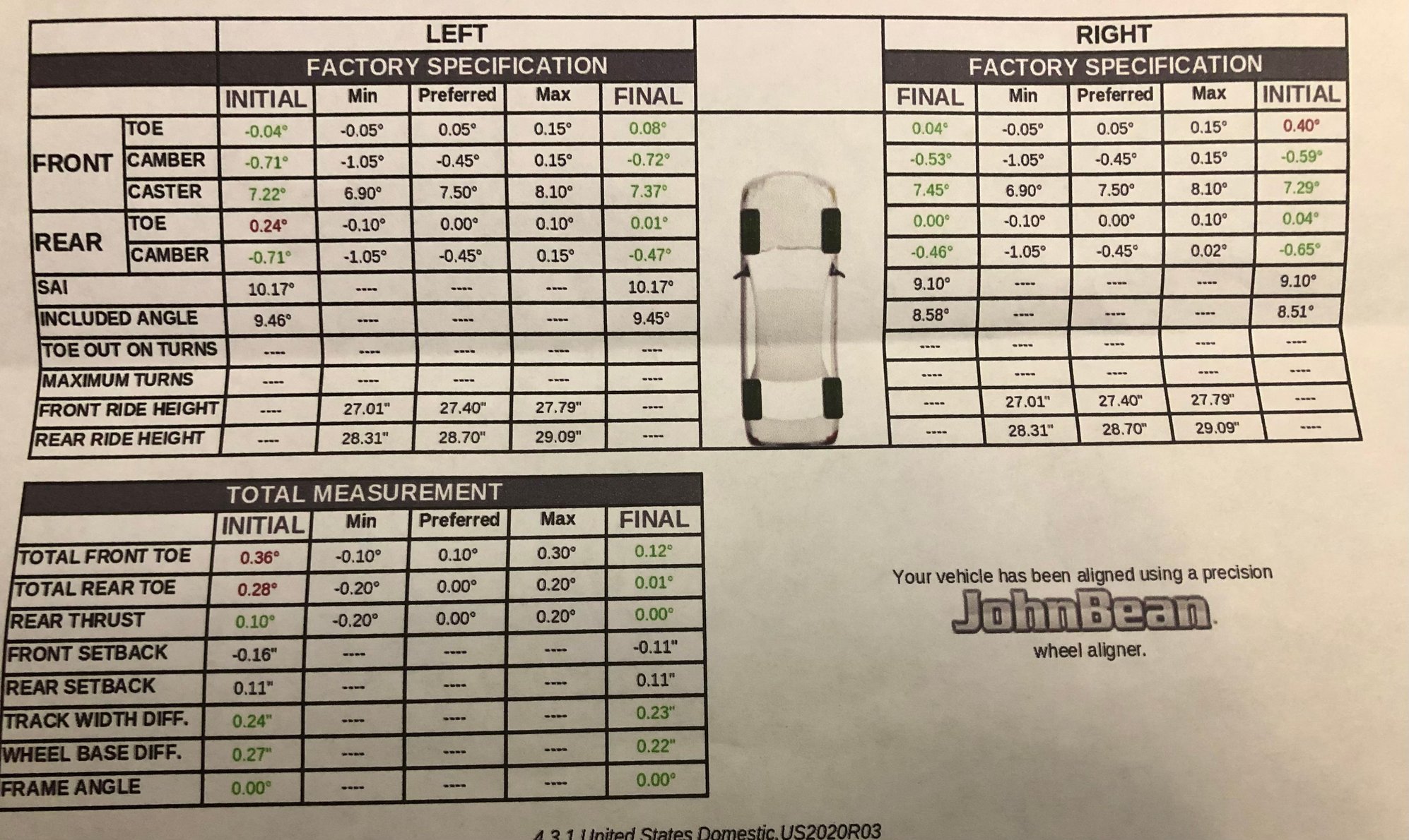

2011 base with FE1 suspension. Long story short I had my car aligned and it drove fine but the steering wheel was off centered just a bit. I took the car back and he tweaked it but I guess we didn’t agree on what position straight was on the wheel. (Wheels was a couple degrees to the left) Anyway I’m very ocd and so last night I adjusted the tie rods turning them the same number of turns on each side. It fixed the wheel position but now the car wanders to the right a bit. Maybe my adjustment was off a little bit I thought I turned them the same. With the wheels off it looks to the naked eye that the drivers side toe is inward a little and the pass side looks straight. Would the left side being in some cause the car to slightly pull right, or would it be maybe that the pass side needs to come in? I have a feeling I’ll end up back at the alignment shop but wanted to see if I could adjust myself first.

Here are the readings. The wheel was off center just a bit - turned to the left. I tightened the passenger tie rod and loosened the driver side, turning both sides two flats on the tie rod. I did a test drive and the wheel was to the right just a bit so I went back and did went in the opposite direction one flat. So basically I turned each tie rod one flat from where the car was right after the alignment. The wheel position is now where I want it but like I said the car drifts to the right, not bad at all but def does. With the wheels off - the driver side rotor seems to be pointed inward more than the pass side. I know this is by no means an accurate way to measure but that’s just what I noticed.

Thanks for posting the readings!
Uneven camber or caster side to side will make a car pull... Yours are both pretty close. Accepted tolerance is usually .5*
Most times, if the angles are good, a minor pull turns out to be coming from the tires. Try swapping them side to side, and see what happens.
Uneven steering axis inclination (fixed angle dictated within the steering knuckle) will also cause a pull.
Yours is off by a degree.... but I wouldn't be too stressed about it.
Couldn't find SAI specs for a C6. I'll keep looking.
Thanks for the info. I’ll try swapping the front tires and see if that makes a difference but as far as I know it was driving straight right after the alignment and the tires are close to brand new so I don’t know if that would be it but I will give it a shot. If that doesn’t help I’ll take it back to an alignment shop Monday and have them tweak the front end and I’ll make sure to show them exactly where I want the steering wheel positioned. Thanks
