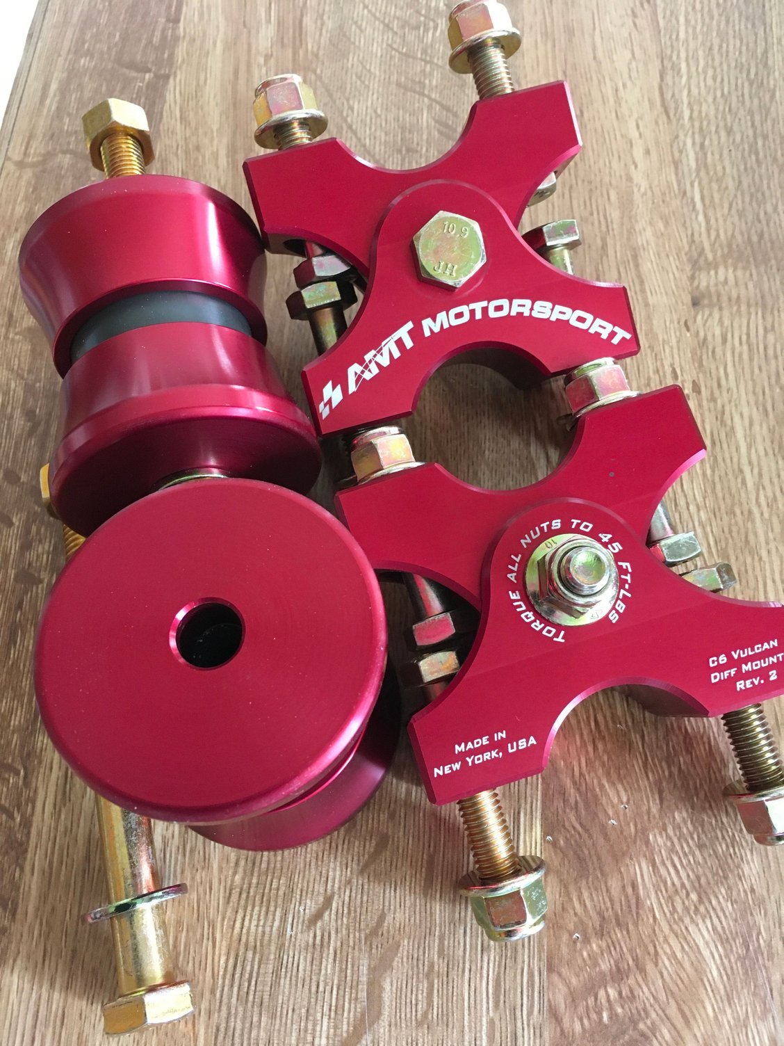

I installed AMT Motorsports motor mounts and they work great. Much better than stock and not as harsh as solid.

I have AMT engine and differential mounts. Zero complaints and no regrets.

AMT going in my car.

Just to offer another view - I ran the AMT short versions and then removed them; way too much NVH in the cabin. I run the Hinson's now.

Pretty much stock NVH. Same bolted feel to shifts and pullaways as AMT.
Not as nicely made as the AMT for sure and they do need heatshielding to stop them melting with headers.

AMT was way too much vibration and noise on my application (468, heads, cams, etc).
Hinson was back to stock for noise and vibration but also similar to AMT for 'directness', both better than stock for shifting and launch.
