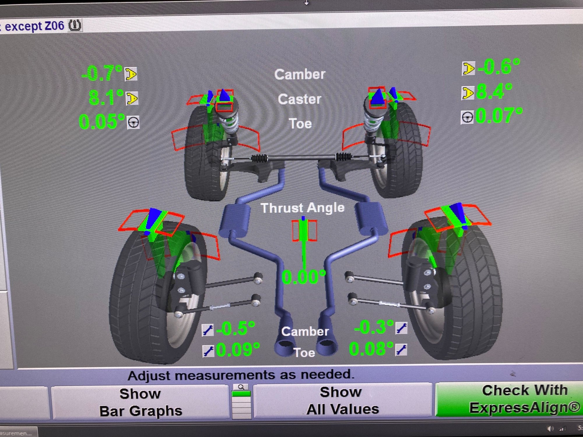

Can you post the alignment readings?
Settings can be in 'spec', but still skewed enough to cause a pull.

The last time my C6 was aligned, I supplied the specs for the alignment from the PHAT numbers. He missed the numbers but got it "within specs". It was enough that the steering wheel was off a little. Took it back and got him to use the Tech 2 to get the steering wheel angle exactly on 0. Then the alignment was completed. Originally he had just looked at the steering wheel and tried to get it close. The suspension bushings, front and rear, are soft and sometimes the crown of the road can cause the wheel to not be straight.

show me the print out or specs of what they did. if you're anywhere where the road is crowned you need 0.5 degree (sometimes as much as .75 degree) cross caster or a combo of cross caster and cross camber. you want more negative caster on Driver's side, and/or positive camber. You have to be careful of Pfadt specs too because if you don't read their paragraph and just go off the chart.....their toe is backwards from norm. Toe out is negative, they want negative toe....which is toe in....which is normal.....but that should be called positive toe. I just did one for a customer last week. Also, any alignment that is more than just minor "toe and go" should be aligned, then rolled back and start from scratch with rollout compensation, caster swing.....the whole nine.

Still waiting to see the printout....

I’ve seen cars that would lead to the right when on right side of road and would lead left when in left side of road, align was in specs but as already stated the caster setting and possible toe in are in a neutral setting which will crown of road to cause a lead to low side of road, good luck
