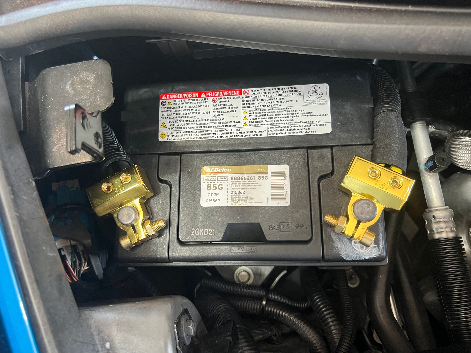

I ended up buying the battery post cleaning tool, and had the dealership replace the battery cables & clamps, and hoped that my problem wouldn't come back. (My battery posts & clamps visually appear to be flawless)
I experienced this malfunction again this afternoon. (This is the 4th time in just over 1 year of ownership). It always happens, as soon as I press the ignition button after entering the vehicle. (The car had lights & power up until I pressed the push-to-start button).
I was thoroughly prepared for it this time, I had a socket wrench in my hand, pulling off the battery terminals within 60 seconds of the malfunction. Here's where it gets very weird...
I pulled both battery terminals completely OFF, and let the car sit like that for about 15 seconds. I then put both terminals back on, and tightened them on very tight. The car is still completely stone dead, and didn't even get a hint of a spark out of the battery post making contact with the clamp. I repeated this process about 5 times. I finally threw in the towel & called my wife to come pick up my son & I, leaving the battery disconnected.
After what I estimate to be around 10 minutes following the malfunction, I gently placed the clamps back on the battery terminals, and saw small "sparks of life" that you would expect to see when connecting the positive terminal. My son confirmed that the car had interior lights once again. (this is without even tightening down the clamps). Car started without even a slight hiccup, and drove back home without issue. I can't help but notice that this behavior is striking me as oddly similar to any generic electrical device that is equipped with an auto-resetting current overload.
Wish I even knew what direction to look.

Old Aug 28, 2023 | 12:10 PM
C5 Diag's Avatar
C5 Diag
Moderator, Tech Contributor
Posts: 15,630
Likes: 4,076
From: Cape Coral, Florida
If the B+ post on the under hood fuse box is loose (pictured below) or you may have a bad fusebox the under hood and IP fuse boxes will be dead as a door nail….if you have a 12 volt test light when you have no power just start checking fuses with the test light under hood and in the IP Fusebox…a lot of fuses have battery power with the car off…just a guess…I see you had both battery cables replaced…you’ll have to unfortunately get underneath the car to check their work and make sure the both connections are tight…the engine block ground may be loose…to check that connect your test light to ground and have someone try to start the car…if the test light illuminates NO GOOD…you may wonder why the test light will illuminate ??....think that the test light is another "bridge" back to battery negative...with a bad block ground there will be a lot of electrons trying to make it back to the battery...the test light is another bridge so electrons will go through the test light instead of the battery cable so the test light illuminates...if you have the OE battery terminals change them…they’re junk !!…also you ALWAYS disconnect battery negative first and reconnect it LAST...also HIGHLY doubtful the cables were bad...the dealership could have easily performed a voltage drop check on them to verify...you could have saved a lot of money there.
