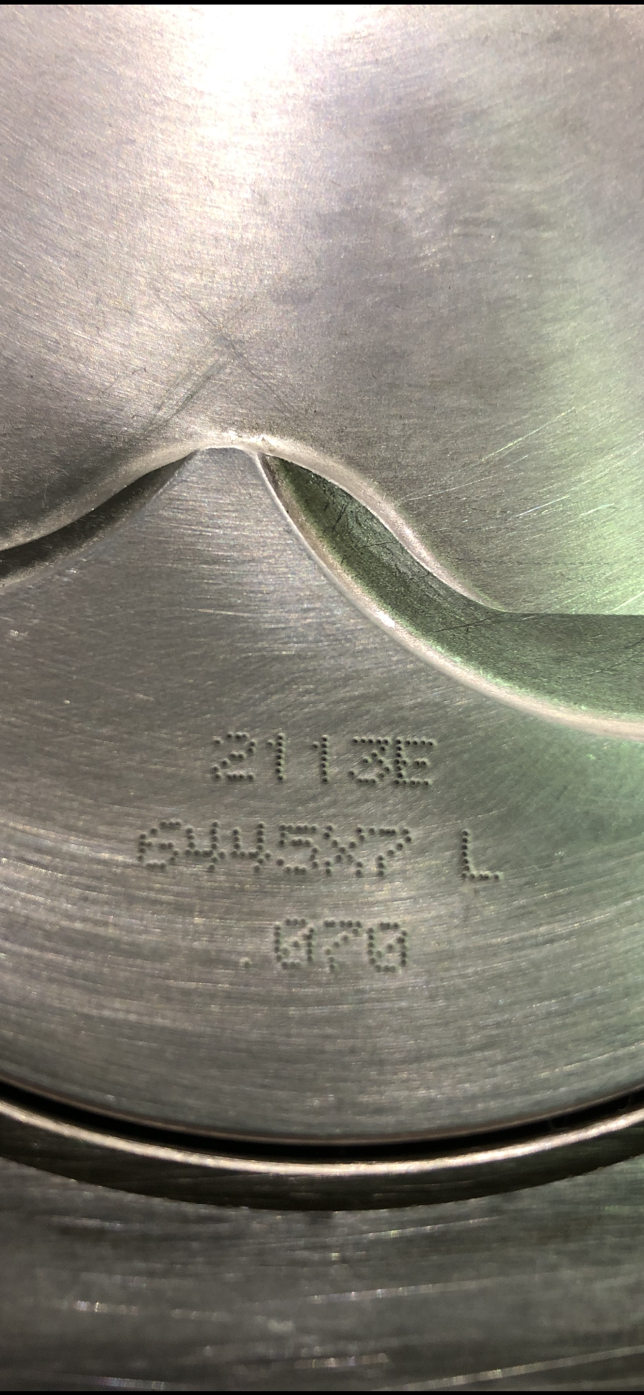

I have this piston in my 416 stroker Ls motor, can anyone out there be able to tell me what angle are the valve relief’s, I would like to replace my 15 deg heads with a lesser angle. Also
Wiseco
what is the largest diameter valves I can use.

May be similar to these. From the part # they look like Wiseco. You may be able to send them this info and see what they come up with
https://www.cnc-motorsports.com/k445...ore-gm-ls.html
