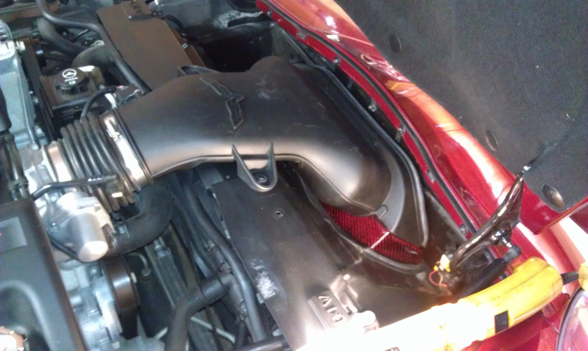

Cold air gives more power. I kick the **** out of people in the winter. They are sucking hot air from under the hood and I am pulling Very Cold air from outside the car. Mine is home made.

hey lemans i've thought that may be possible i'd love to see some pics that's pretty cool you did it yourself .... when you have to cut the plastic to install a new one i was wondering if sealing it up would help ram the air a little better but i guess air is air ..... love to see some pics

I don't know lemans but here is a pic of mine....

Sorry about lemans..... I got confused i now see it's ls. That looks pretty nice maybe over the winter i'll try something similar. Thanks for sending the pic!
The hard part was engineering the piece to attach to the stock air intake. It's carbon fiber/Kevlar.

I see that it looks awesome did you use raw carbon fiber stock to make it? If so where did you get it? Or did you make it from an existing piece? Either way it's nice

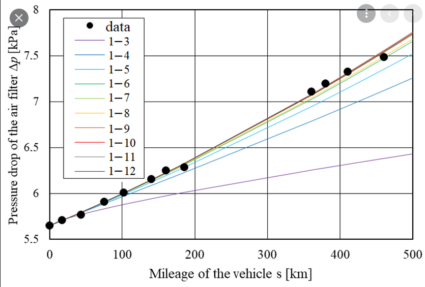

To be brief, at WOT the only place to find a pressure below atmospheric is behind the air filter. This applies equally to forced induction and natural aspirated engines.
All OEM PCV systems both turbo and NA 100% of all engines manufactured are engineered to provide such a pressure drop thanks to the air filter, which increases while you drive,
This is done purposefully so the longer the engine goes without maintenance, the more cleaning action is done on the crankcase to maintain oil quality.
Air filters posses CFM ratings at some pressure drop. For example 500CFM @ 1.5" Hg. It is important to match the air filter pressure drop to the airflow demands of the engine. For example a 800CFM @ 1.5" Hg air filter cannot provide any PCV pressure drop at WOT to an engine which only uses 500CFM max.
Therefore anytime you modify the crankcase ventilation system (catch cans, intake manifold, air filters, pcv hose length changes, crankcase volume, etc...) you must also measure the crankcase pressure, and then make adjustments to compensate and re-establish the pressure drop on the crankcase.
