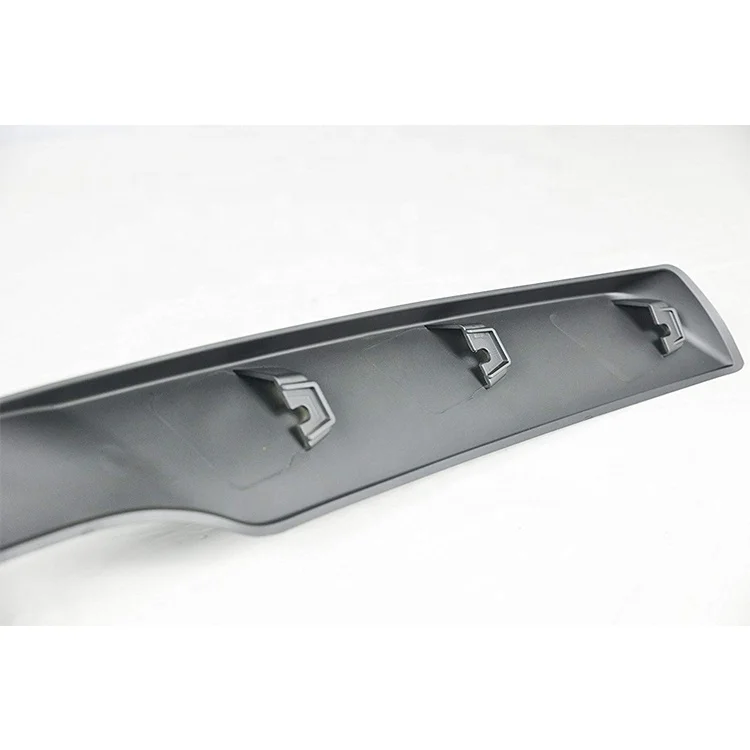

If your spoiler is made like the majority of the rest of the aftermarket ZR1 style spoilers being sold, you will need these for the mounting:
(oh ... and the nuts too. Photo below don't show the nuts)
Attachment 48337674

The clips are made to attach here:

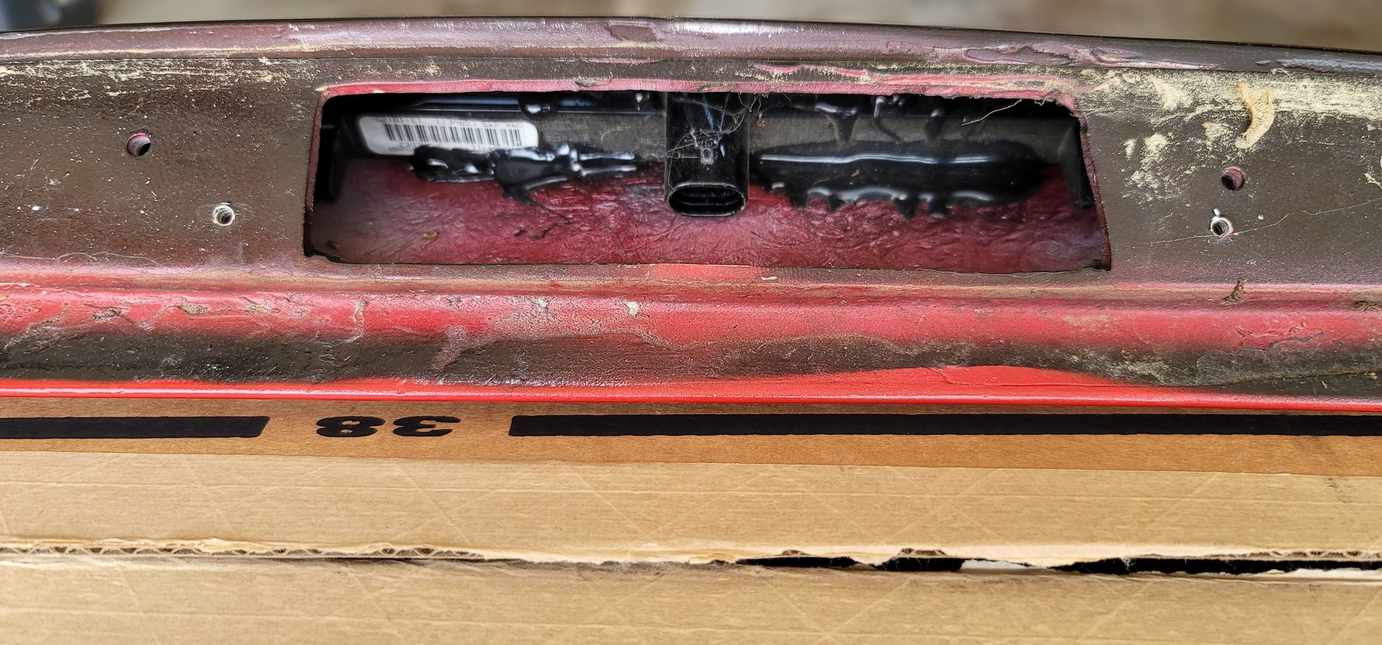

So yeah this is the bottom of mine.
Whats up with brake light lol? I mean i couldnt even swap it out for the led laser! Uhg why does my stuff have to be so different?
So am I gonna have to do double sided like 3m tape?

Also I guess the holes from the wing didn't line up with the stock bumper holes so the drilled and tapped new ones and used body screws to hold it on. Plus I seen the used some sort of glue on the very ends to try and hold it down there also but that failed
